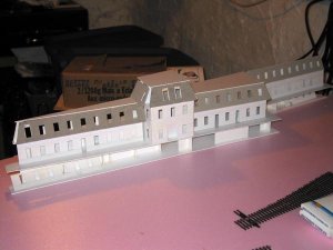

At last, some progress worth looking at...!
This is intended for a future module, but I could not resist working on it. I received the Inn somewhat complete - at least the main walls and roof, although in the picture it is only temporarily assembled with tape.
The Highland Inn was built at Cache Lake in Algonquin Park in 1908 by the Grand Trunk, shortly after it acquired the Ottawa, Arnprior & Parry Sound Railway which ran through the park. (Lumber baron JR Booth had built the railway.)
The Inn was originally just a dining room, kitchen, and staff quarters, with guests residing in canvas tents. Over the years, a number of additions were made. It reached the form I am modelling sometime in the 1920s, about the time that Canadian National Railways was formed (absorbing Grand Trunk, among others).
The Inn was closed during the early 1930s depression, but reopened in 1938 and remained in business until the Government elected to demolish it (and other camps) in the 1950s. Only one original camp remains - Bartlett Lodge - which is across the bay from the site of the Highland Inn.

You "received it somewhat complete"? Howcum I don't receive stuff "somewhat complete"? :rolleyes: Neat looking model, Andrew. Is it made from boxboard? I like the way that the backside is angled, as it helps to make the building more part of the scene, rather than just a background flat. Most of my background buildings in Dunnville and Lowbanks are built the same way.

Thanks for the compliments, although most of the credit is due to my "trading partner" - a guy from one of the local clubs who gave up HO scale some time ago to switch to S. He started (and abandoned) construction 12 years ago...
The Inn is made of various thicknesses of styrene, with a scribed styrene skin representing the "novelty" siding I think may have been used. Either that, or it is straight clapboard...?
The unique angle of construction allows the east wing to be seen - if it had been constructed as a "flat" flat, the whole right side of the building would not be on the module...!

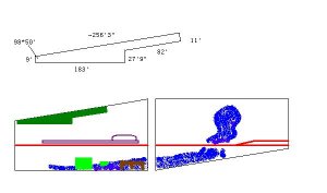

I have attached my sketched plans for a "transition" set of modules that will eventually operate at www.hotrak.ca (although it may be a few years before I get there). The shape in the upper left is the footprint of the building. At the bottom are the two four-foot long modules that will house the first part of the Algonquin set. The green blob is the Inn; the purple is the station and platform; the red line is the track (there was no double track to the east, but this is a concesssion to HOTrak standards); the blue is Cache Lake and a small inlet to the east of the station; the light green represents the boathouse and pavilion; and the brown is the docks.
To the west was the little village associated with the station - a rec hall, Park headquarters, staff houses, and so on. After 1933, when a trestle just to the east was condemned, CN added a turntable and runaround track to the west as well. All of this may eventually occupy two more modules...!
