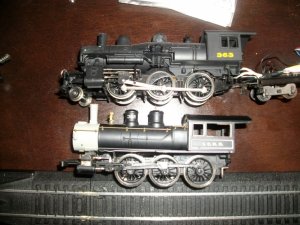

This is what I've found so far...
The IHC 2-6-0's underframe is a great candidate for the swap. The frame is made of plastic so there is a north rail/south rail pickup with wires running directly to the motor and tender pickups, which makes this great for a future DCC conversion (which all my locos will eventually have). The AHM's underframe is stamped metal with only one wire running from the pickups on the tender directly to the motor and the frame picking up current on the loco from one side of the drivers.
While it'd be obvious to immediately snag the underframe from the Mogul and boiler swap it, there's one big drawback: the driver spacing. I thought it wouldn't be an issue initially for aesthetic reasons, but further review showed me that the surgery required would be quite difficult since it would involve cutting the plastic frame to get it to fit right under the boiler of the 4-6-0. So I'm at a crossroad here; do I have two handsome but crappy/ non running locos or should I just scrap this whole headache? Or jump off the deep end and go with my idea of building underframes for both of the 4-6-0's?
Tyler

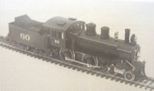

As much as I like the "scrapped out/possibly reborn" idea of my 4-6-0 for parts, I may give it a new life after all. I was cruising eBay for lokies and ran into someone's rendition of a rebuild, which wasn't for sale if you're wondering. It looks like someone took a AHM/Rivarossi American underframe and transplanted it under the boiler of the 4-6-0. I like it and may do that instead. I'd like some feedback on this if anyone has done something similar or even upgrading the mechanism of the existing lokie.

that will work
That will work to produce a larger more modern American. not only that, but I might have an AHM American frame in one of my junk drawers the beauty of this would be the ease that a really good motor could be installed in the tender.
I will have the boys at the engine shops look into it.
Bill Nelson
