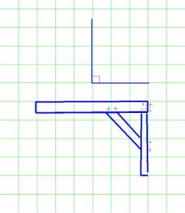

I got an idea...
I took part of grewsome's idea... (NOT DRAWN TO SCALE) lol
Red = the 4x8 piece of wood
Yellow = border along side of whole table, to help attach legs and to help trains not go over the edge :P,
Blue = Table leg
Pink = support for leg and part of table
Brown dots and lines:
Lines: Side view of screws going from left to right into wood to hold together
Dots: straight head on view of screws into wood to hold leg supports to leg...
Make sense? is this good or bad idea? any suggestions?
EDIT: just thought of something lol...my wood isnt that thick, less than 1/2 an inch right? how can i screw that stuff to the table easily? its not that thick lol

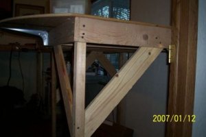

Prodigy, it's said a picture is worth a thousand words. Here you go. It's not pretty, but it's functional and can be hidden later. You can also see the cross pieces under the table I was talking about.
Loren
