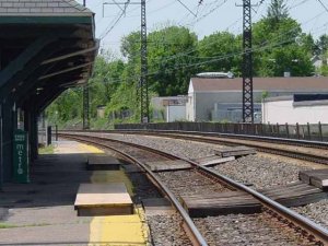

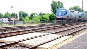

Her are a few from near me on the Northeast corridor. Both are 3 - 4 car length stations. but they both have wood running out toi the second track. Note the platforms. that are there to match the height of the train cars.

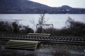

Check out the length of the platform at this station on the Metro North Commuter Railroad! :D
Perfect prototype for those who do not have much room to model a passenger station on a small pike! sign1
(Note: The Breakneck Ridge stop is on the Water Level Route on the Hudson River, of the New York Central's 20th Century Limited fame. The MNCRR only stops there during the summer to drop off and pick up people going there to do recreational hiking. Still, if you want a prototype for the smallest passenger station possible on a modern railroad, that one is it!)
