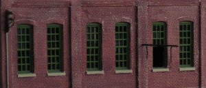

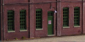

I decided to try some of the Walthers modulars and just to get a feel for them I decided to keep the structure simple. I needed a long, low building behind the yard, so that's what I made.
These parts are very easy to work with - a lot more so than the DPM modulars, and have the trademark Walthers perfect fit. The only thing I didn't like is that you have to buy the pilasters that connect the walls as a separate kit, but you do get cornices with them. This structure was made out of 3 kits - large walls, small walls, pilaster/cornices.
Once it was together, the real fun begins. I created the mortar lines with spackle, which I scrape off immediately after applying, and it stays in the grooves between the bricks.
Then I added some electrical conduit and junction boxes. I used brass wire for the pipes and E-Z line for the wiring. If you look closely you can see some stacked cardboard boxes against the windows on the first floor. That's the only interior detailing I plan to do.

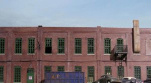

Well, Jim the fire inspector came today and told me that I need a fire escape for the building. I tried to tell him that it was around the side, but he wasn't buying it. So, I've added one. I kind of like this shot because the perspective looking up like that makes the whole thing look a little more real, especially with a Photoshop sky. :)

Wow... again! Looks great. I love that wire(?) that sort of loops along the building. It's little details like that that really make a scene come to life...
You need to get your work/layout into print!
Andrew

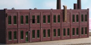

That is absolutely fantastic Val. I've got to look into that. I've got a couple of DPM's, but I'm not that impressed and never finished them. On the Walther's, are the windows separate or are they molded into the sidewalls?
I really like the extra touches you've put on.:thumb::thumb:
A neat but necessary structure Val. Your last photo shows it off well. That container in front of it next to the cars looks right at home too. I like your additions like the conduits . The simple interior makes it look like a well used facility. Nice modelling.

Don, the windows are separate pieces, and come with rigid plastic "glass". They fit into slots on the backs of the walls. The pictures lead one to believe that the walls are 2 storeys tall - they are actually only one. The difference between the large and small walls is that the large walls are 4 windows wide, and the small ones are 2 windows wide. Doors are only provided with the small windows kit.
