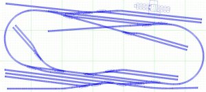

Keep in mind that a 50' covered hopper is about 4.5" in N-scale. To get your 8-car track for the silos, you're looking at 3' of track. That's a lot of track on an 80" door! I put 10 cars on the top spurs so you could see what it looks like:

Larry,Keep in mind that a 50' covered hopper is about 4.5" in N-scale. To get your 8-car track for the silos, you're looking at 3' of track. That's a lot of track on an 80" door! I put 10 cars on the top spurs so you could see what it looks like:

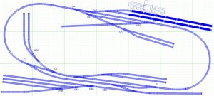

Something like this?
Of course now with such long tracks, any moves in the elevator are going to foul the main... do we need a lead up there too?

You'd almost need to out a lead up there and it looks like there is only room for a slip switch too. Unless I'm missing something?
Sheesh! The guy hand-lays one double-slip switch, and starts seeing a need for them everywhere! :p :D

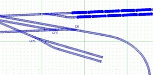

I don't know if I asked this before - what type of track were you planning on using? I've been using Peco Code 80 turnouts and such for this so far.... if you were planning on using Atlas, I should re-tool the thing so it's correct.
It can be done with Atlas track, but I don't like the result as much. Peco turnouts are constant radius, while Atlas are fixed frog angle. The Pecos make for nicer trackwork in small spaces.

Shouldn't need a lead up there. This seems like a train-a-day out-and-back style of branch. Nothing to get in the way of if there's only one train running at a time. I thought the one at the bottom was rather a waste since Larry is going to be the only operator, but I thought better of saying anything. Now, however, the gloves are off!
Well, my thinking was that even though Larry is very interested in operation, I think we all like to see the trains roll from time to time without having to think about it. The lead on the yard lets Larry kick cars while something rolls around on the main, for those times when he just wants to relax and putter, rather than "operate".

The bottom right does call for a Peco switch to gain space needed for the second industry.
In order to save the hassles of having to change my older cars to low pros I will be using Atlas C80 track...
If I didn't miscount I will need 20 switches..
I can get the Atlas switch for $9.99($199.80 for 20) vs 14.69($293.80 for 20) for Peco -seeing I am retired to my mind its a no brainer...I may have to use Peco switches on a case to case bases though as I noted earlier..
