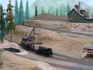

I was going through previous posts and saw a thread that showed a picture of your Badger Creek with brown parcel tape as a scenery base.
Could you please explain this a bit? Do you use a cardboard-lattice type support, covered in...PACKING TAPE?:eek: If so, please tell (me) all about how this is done, as this seems to me to be brilliant!! How does the plaster actually stick to the tape?? I've tried wire mesh, styrofoam, and others, and was never really happy for one reason or another.

Yes, I use interlaced card first and staple the odd ends together then put parcel tape (Brown) all over it. Undercoat Plaster (Bluehawk) is all I use to cover the tape afterwards and it sticks to it like "glue" to a blanket. Here's another photo showing some plaster also.

i used the same thing that shamus did but i also used that dry wall mesh tape it looked good and held up good till my borther in law had it in for my layout when i moved it i had 95% of my layout done in both box tape and the drywall tape it went up with no time and had the base coat of plaster on the same night it was like making a mud pie just put the gloves on and dig in with in 2 days i was ready to put on my gound cover..
