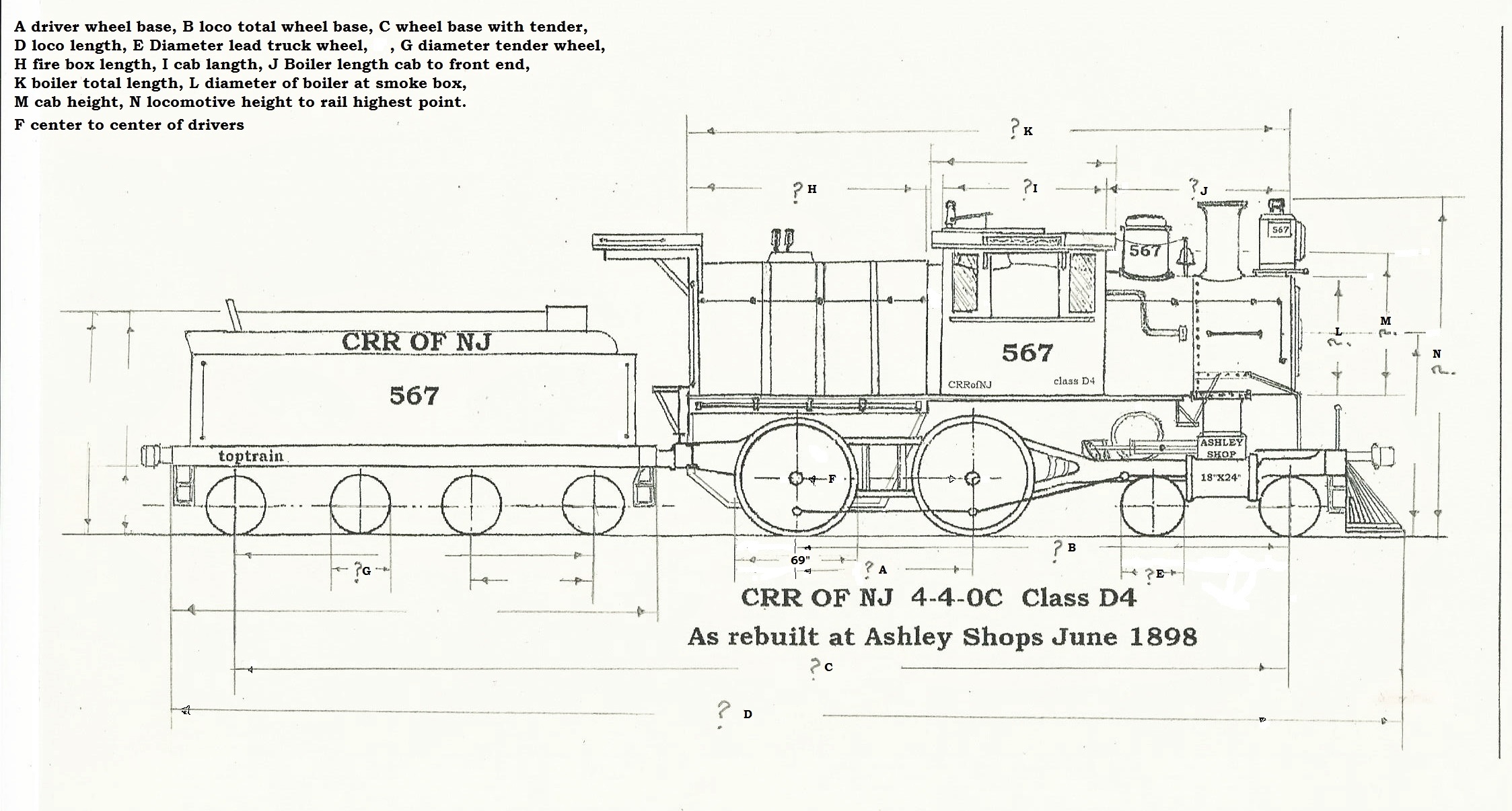

Plain build of a CRRofNJ class D4 4-4-0c.
* looking for information, photos and Elevation drawings of any of the 5, D4, 4-4-0c camelbacks. These locomotives were built as Class D2 rear cab 4-4-0's, with wagon top boilers in June of 1882. They all went into the Ashley shops and were I quote rebuilt and finished in June of 1898. They came out D4 class, with their original numbers which were, 172, and 174 to 177. They retained these numbers 1 year. The CRRofNJ renumbered them in 1899. There was a renumbering again in 1903.

A link to a photo of one at North East railfan. This is how I hope mine will look when done.
http://www.northeast.railfan.net/images/cnj567s.jpg
* I can not find a Elevation drawing yet! This is a elevation drawing I have made to show how it would look. The only measurement I know is the driver size of 69". I need a good drawing or a photo directly from the side.
frank
*** Click on drawing to see a larger size drawing.
frank
If you could give me one dimension in that drawing, I could give you the rest. Even if it is the diameter of just one of the wheels. Mind you, all the dimensions would be based off of it, but they would be relative to that dimension. Once done, and changes could be done to the whole drawing through parametric scaling. Let me know. I'll do it for you. ;)
IMG_1538 s.JPG IMG_1554 s.JPG What I did do was this I had a perfect side view of this locomotive. I did know the spacing of the drivers. I used my scale print. I put in the photo, add the one measurement I had. Selected HO scale and printed a scale photo in HO scale which fit on a letter size page. I was able to take other measurements directly off of the print.
