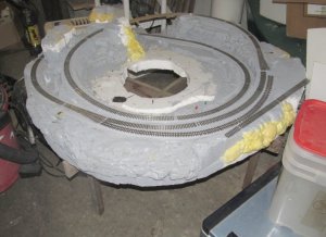

I dusted this off, and set it up to work on the passing siding. I still need to wire in the last section of track the switches are wired with separate powered frogs, so the inside rails past the frog need to be jumpered from somewhere. since most of my HOn3 locomotives are DC, I will probably jumper the rails off of the frog wires, so DC locomotives can be parked on the passing sidings . The last time I had this out, the Blackstone C-19 couldn't pull the combine up the inside hill, but it did so easily today.

I got the hole in the layout cut out for the Christmas tree stand, still need to add wires to the switch rails past the frog, and tie them into the frog wires, so the circle will be powered all the way round.

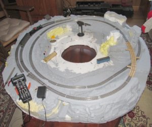

Back home from work at about 7:45 Sunday morning I did some dishes, and then put the lights and tinsel on the tree, which may be all the decorations it gets this year. I plugged up the little NCE DCC power cab, and now the little consolidation has much better speed control and I can ring the bell , blow the whistle, and make it hiss.
I'm going to have to make more hollow scenery to hide the Christmas tree stand better. If you look out the window you can see the trestle approach for the old L&N Memphis line's Cumberland River Bridge

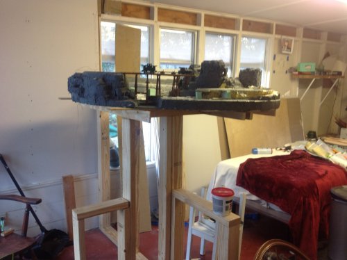

I have just got done edditing this thread to bring the photos up to full image. the narrow gauge minni layout is now in my garage. In my scrap wood pile out in my collapsing pole barn, I found some supports I had made for a small Thomas the tank engine layout I had made for my #1 son. that layout is long gone, but the supports, when put together make a rock solid support, holding the layout about two and a half feet above the floor. The supports are almost perfectly sized fot this little portable layout

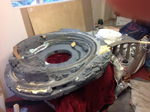

This layout got flooded. It was in the garage under the upstairs bathroom, and the fill valve broke in two in the toilet up there. The bathroom, and part of the hall was flooded, but most of the water landed in the garage.
The layout was under a cardboard box that got wet enough to come totally apart. Thankfully, I had painted the plywood on both sides before installation, so it did not warp. The bridge deck was deformed, but did not come apart, and I found it wile it was soaking wet, and was able to straighten it out before it dried.
I had glued the flex track down with white glue, something I highly discourage. I was lucky, and it only came loose at the ends of sections of track, The loses ends did not reattach, and there is homabed under the track, as well as plywood, so I will be able to fix the kinks quickly with 15- 25 spikes.
One big advantage of a portable, is if you are about to undertake a messy job, you can tote it outside. I mixed up a batch of dark gray acrylic paint, to get a base coat all the way around this puppy.
It is still outside, waiting for the paint to dry, as it is a very tight fit into the garage past the Wife's 06 Miata. The other garage door won't open, since a wild turkey Tom crash landed into it. One of the joys of rural life, a mile from the county courthouse.
The next step is to fix the kinks, so I can run the fire out of some narrow gauge trains.

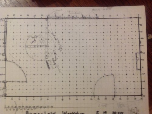

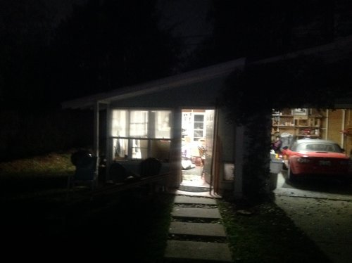

Thevplan for how the loop will fit in the bungalows work shop. The track will be close to eye level. So there will be room for a lower deck
The bungalow work shop.

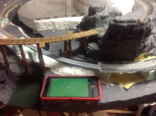

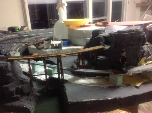

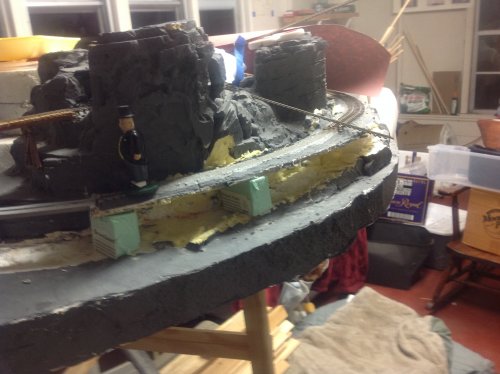

I have separated the roadbed of theclowest track from the foam. And removed it, to install a trestle. This will reduce the grade ar the bottom of thrvgrades. As well as shorten the grades, while increasing the visual Interest.

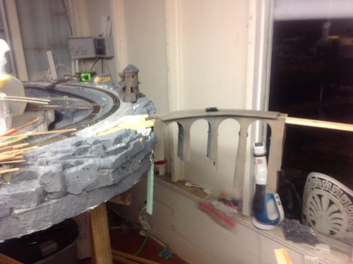

I have removed the outside track at the passing siding , and am hacking in a wye off the two switches , using this volmer,(I belive), curved viaduct , which was recycled off the Gegokayoosa loop on my Clarksville. Layout.
With the loop. I can use this for continuous running. With a wye attached; it can be a return loop for a larger, yet unplaned HOn3 layout.
In the background, you can see studs. I'm going to add insulation. And shetrock as I build real benchwork. Have oredered. Materials from Lowe's I can pick up tommorow .
The fat controller , AKA Sir Toppum Hat, is overseeing the rebuilding of the grade. And the creation of the next awesome trestle.

My phone says the bench work is level, we will see if it is when it is fastened to the wall and the floor.

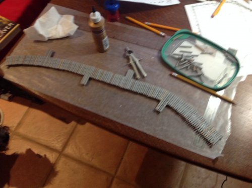

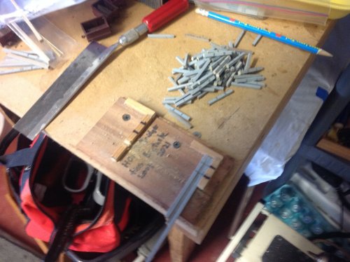

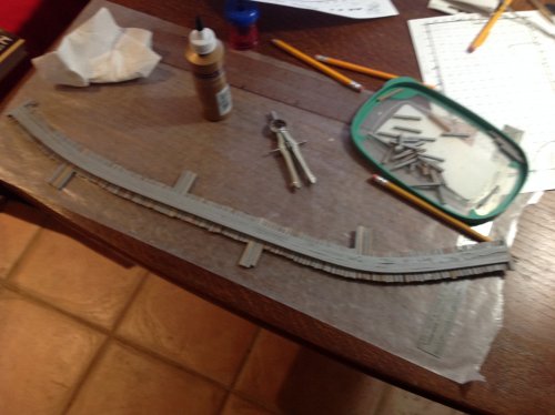

I made a jig to cut bridge ties. Have do right that before but screwing it to the workbench was a big improvement.
The top of the bridge deck . I will try to get some brown and some tan spray paint, and try to get this closer to the color of the upper bridges timbers.
This is the underside of the bridge deck. The stringers are yellow poplar and aromatic cedar, lamenated with clear gorilla glue. This makes a really strong bridge deck.
