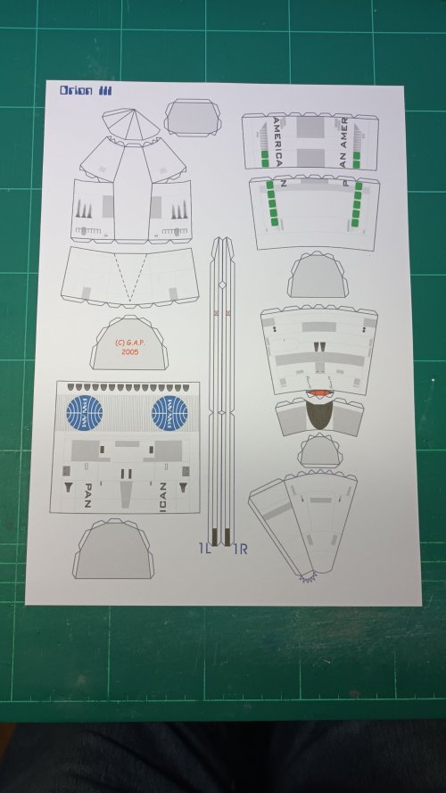

First sheet covers the main front fuselage

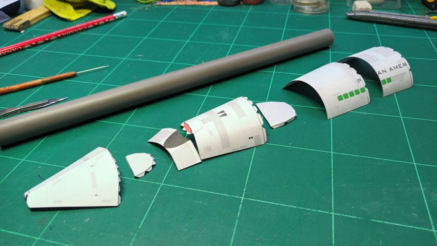

First set of parts have been cut out and rudimentarily formed over a plastic pipe

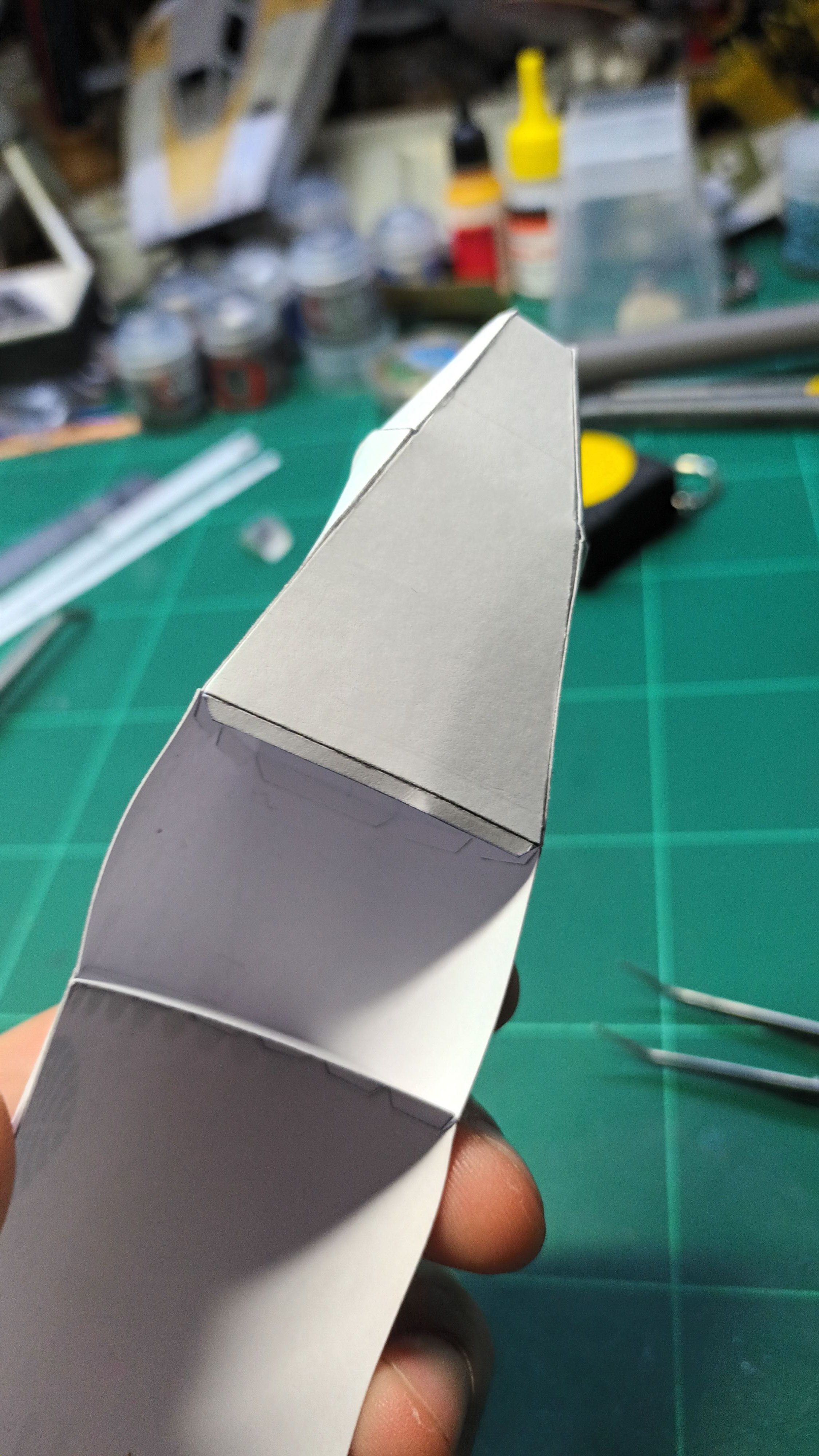

Next section of the nose - forward of the cockpit windows with the black anti-glare panel was added next, Tabs glued either side of the cockpit windows, then the windows glued to the section

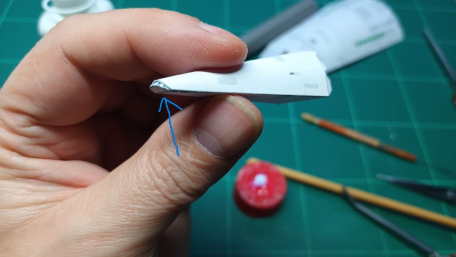

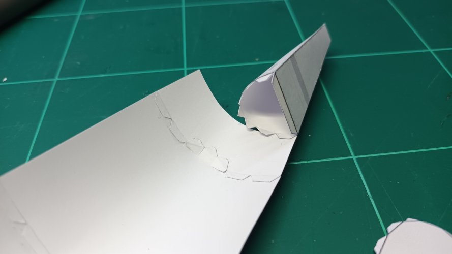

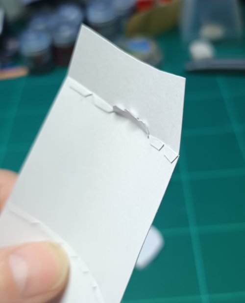

The front nose section needs to be creased across the line indicated

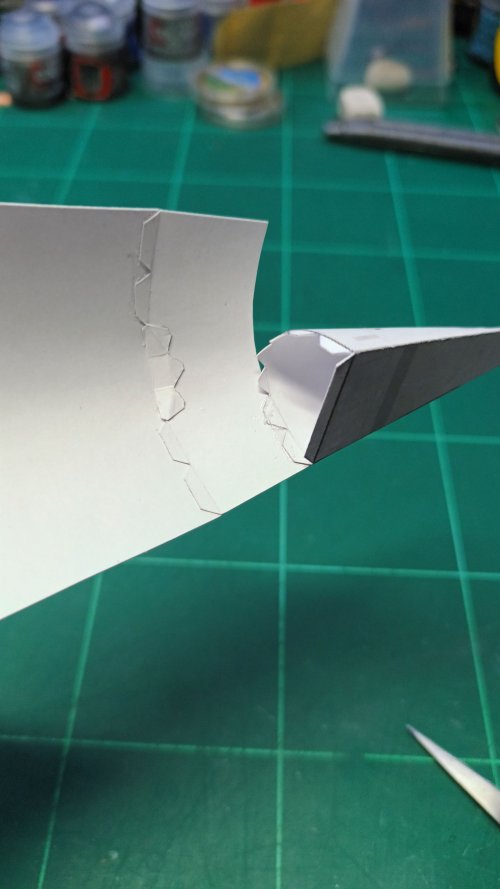

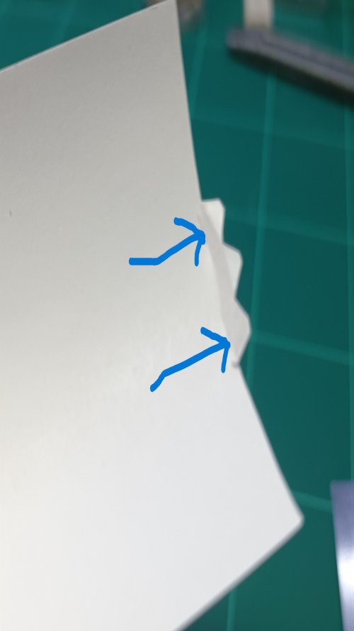

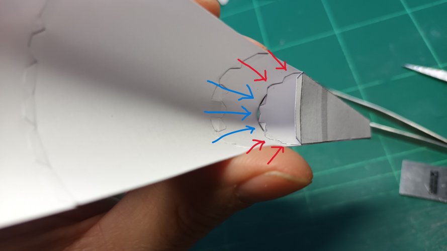

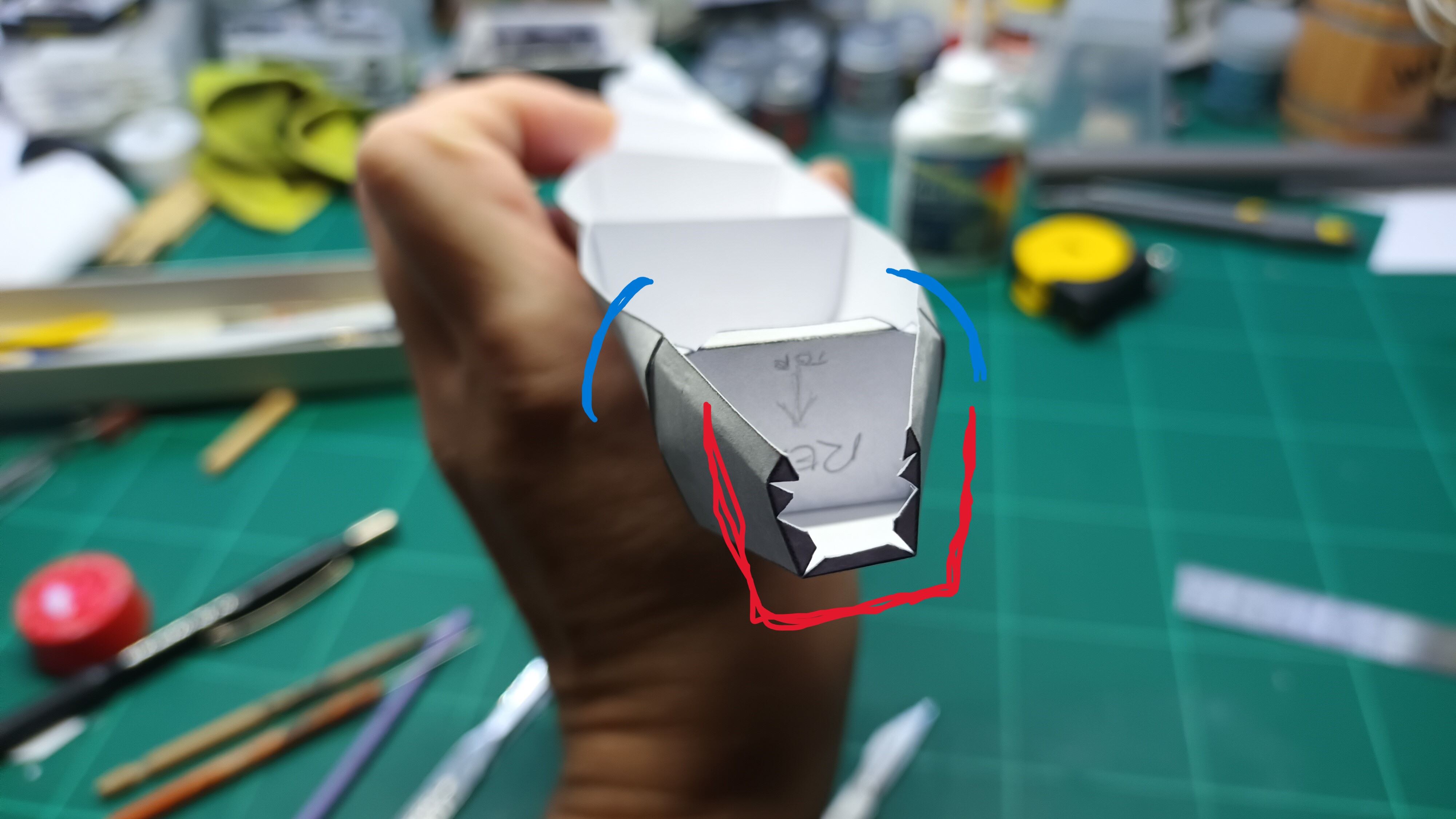

As I had not quite formed a tight enough curve on my hull, I glued a tab one at a time on the port, then the starboard side first, then the next tab up.
Red arrows are the first glued tabs, then the blue arrowed tabs were bent backwards and glued up.

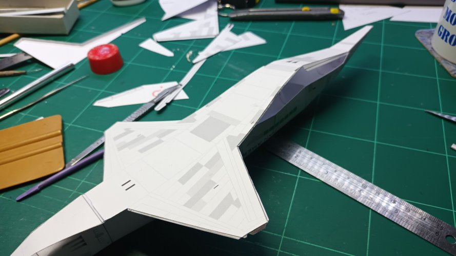

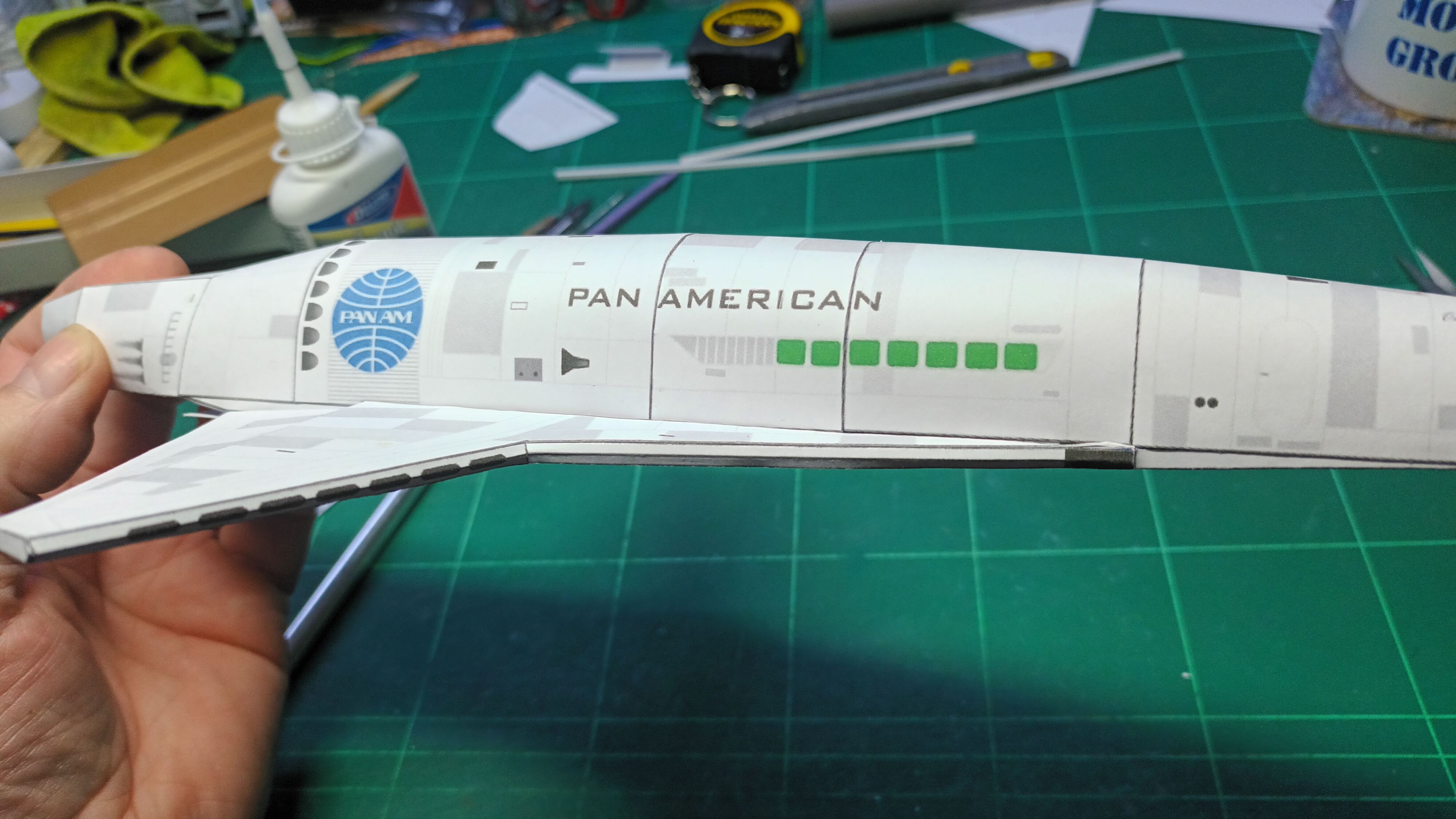

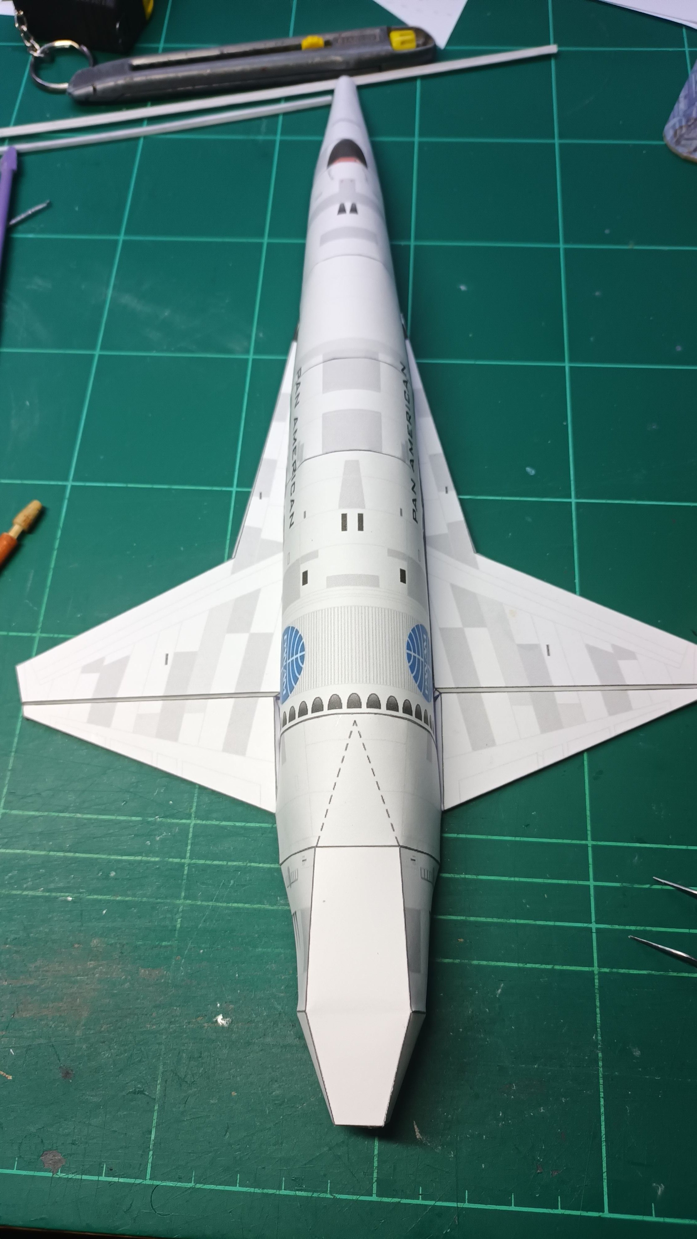

Front half of the ship should look something like this

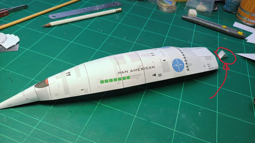

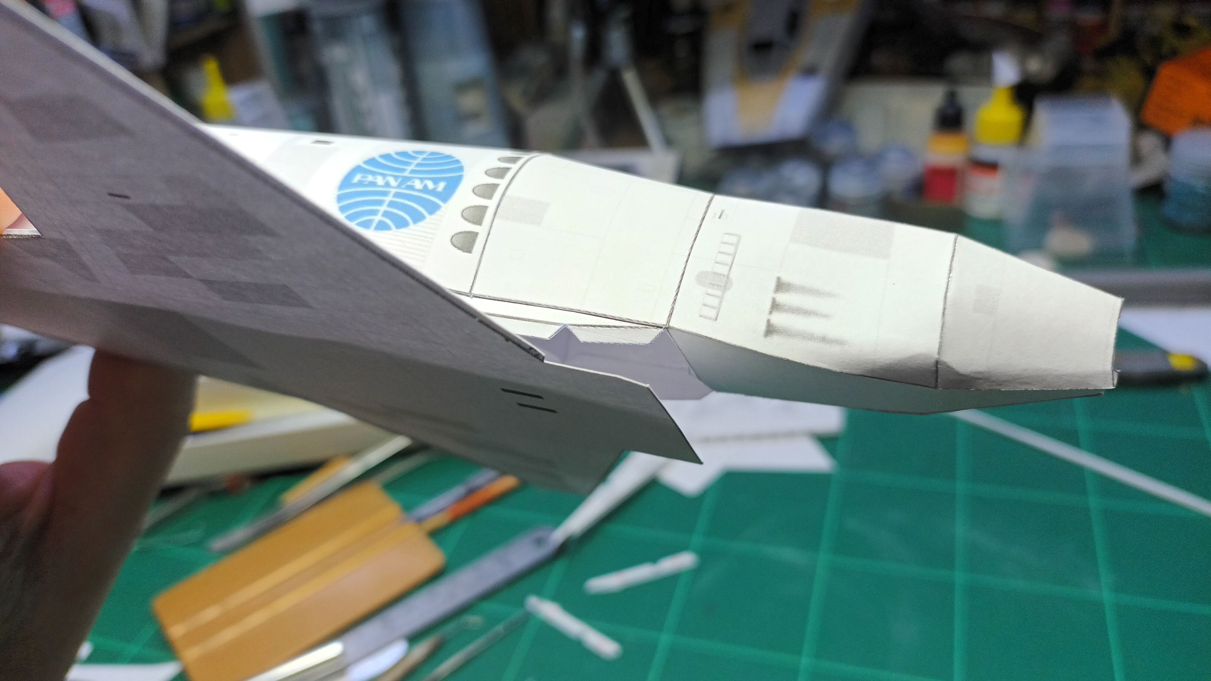

With all hull sections stuck together froward of 'PAN AMER' it was onto the 'ICAN' and head backwards...

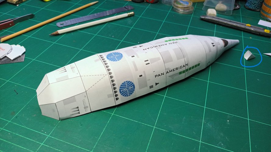

There's nothing really to note on construction of the rear hull, as tabs very much guide you through alignment.
CIRCLED EXTREME REAR OF HULL LEFT OFF UNTIL LATER
Blue circled, same as red above

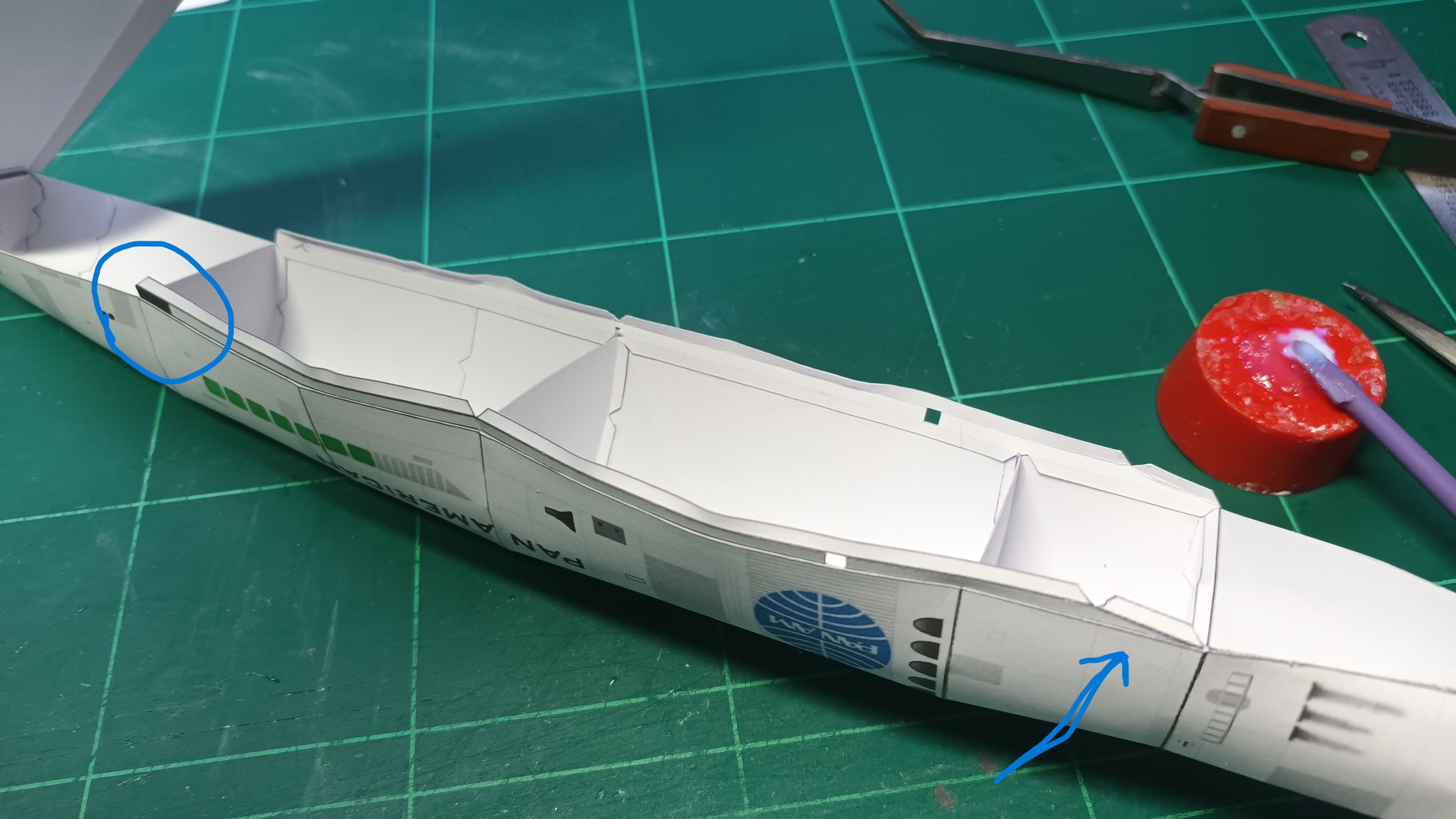

Righty'O - second part of the Orion build. @seraphim

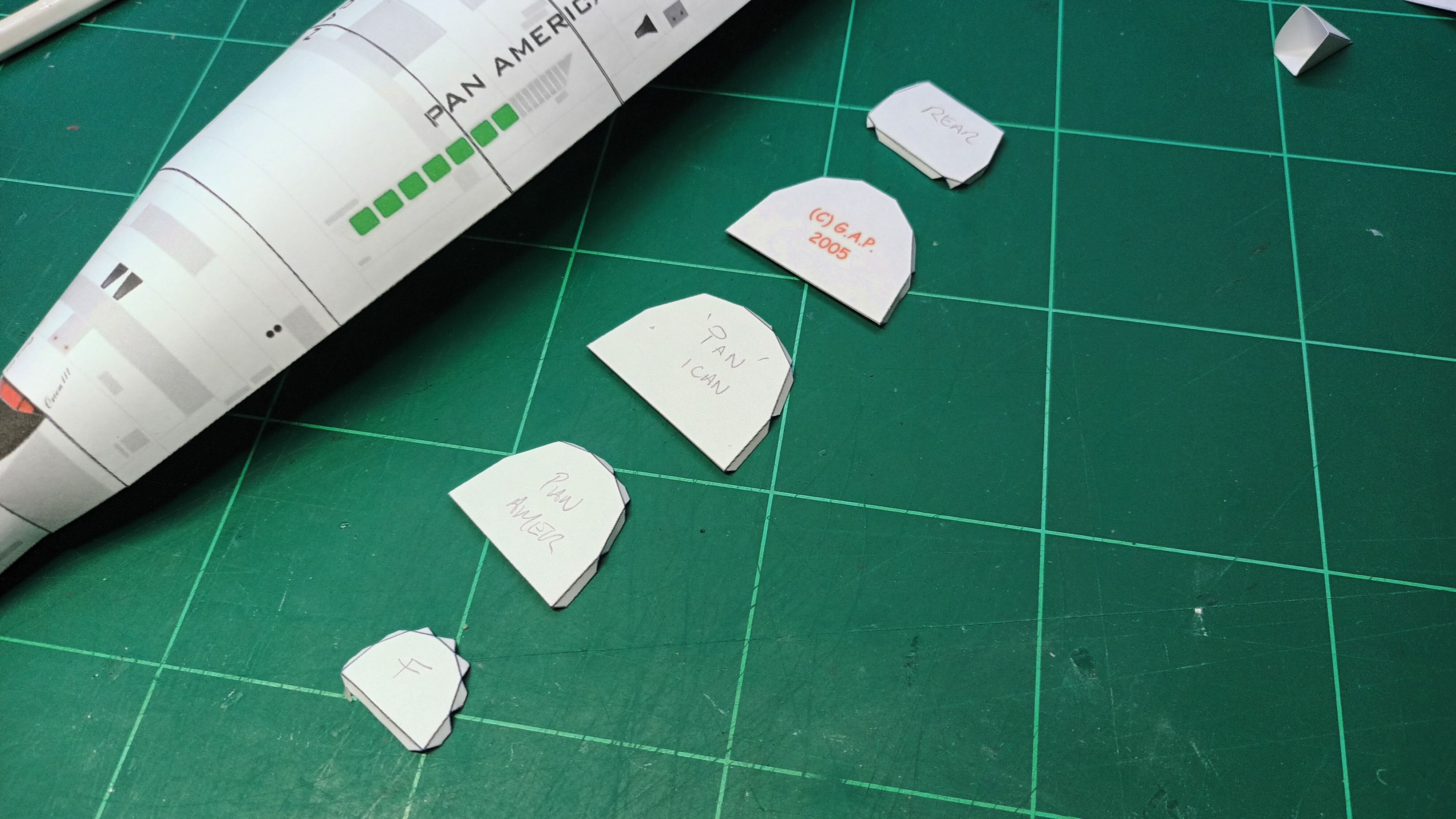

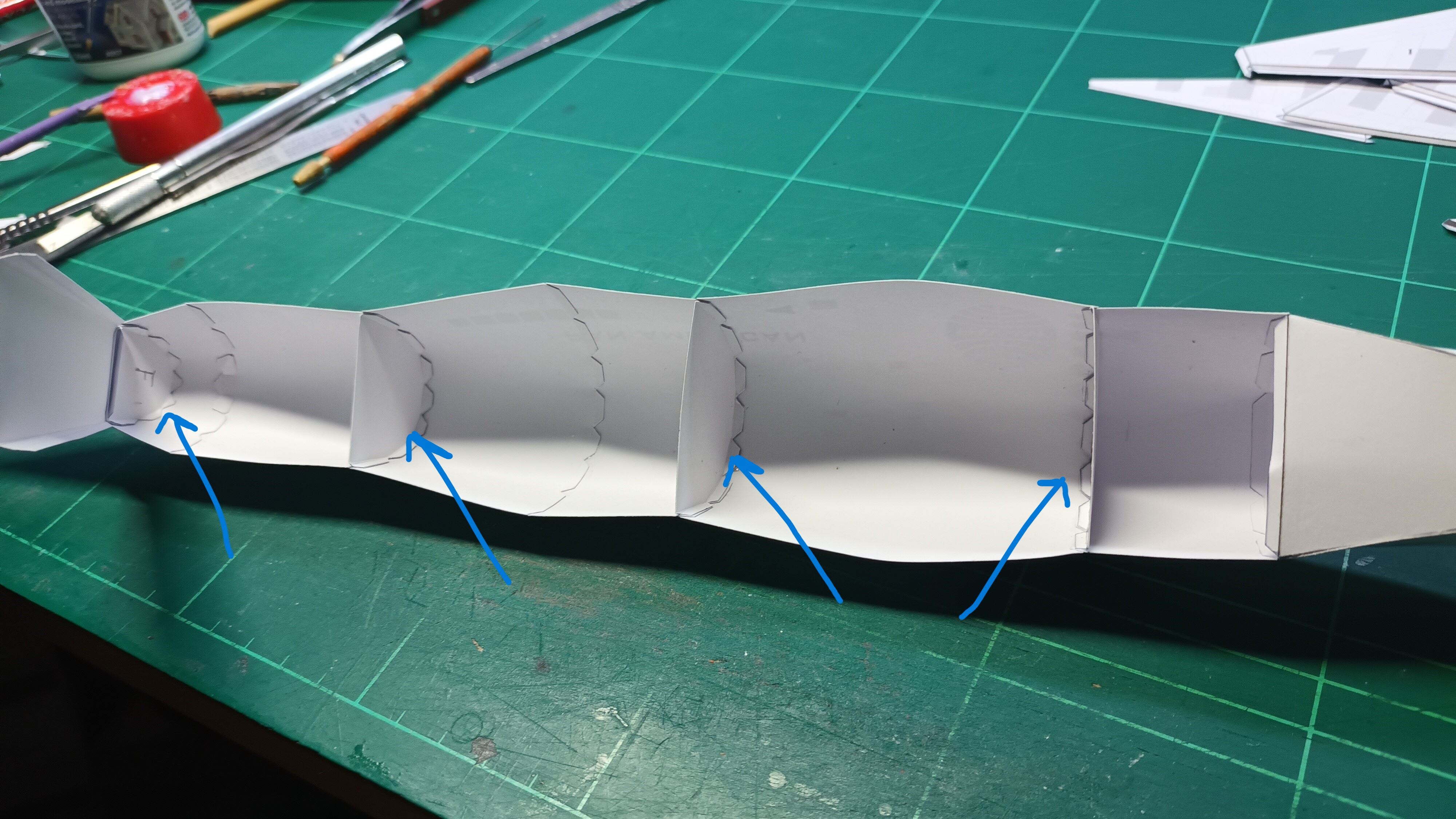

Bulk heads are requested to be put onto the corresponding joins.
When they were cut from the sheet, I made notes as to what one went where.

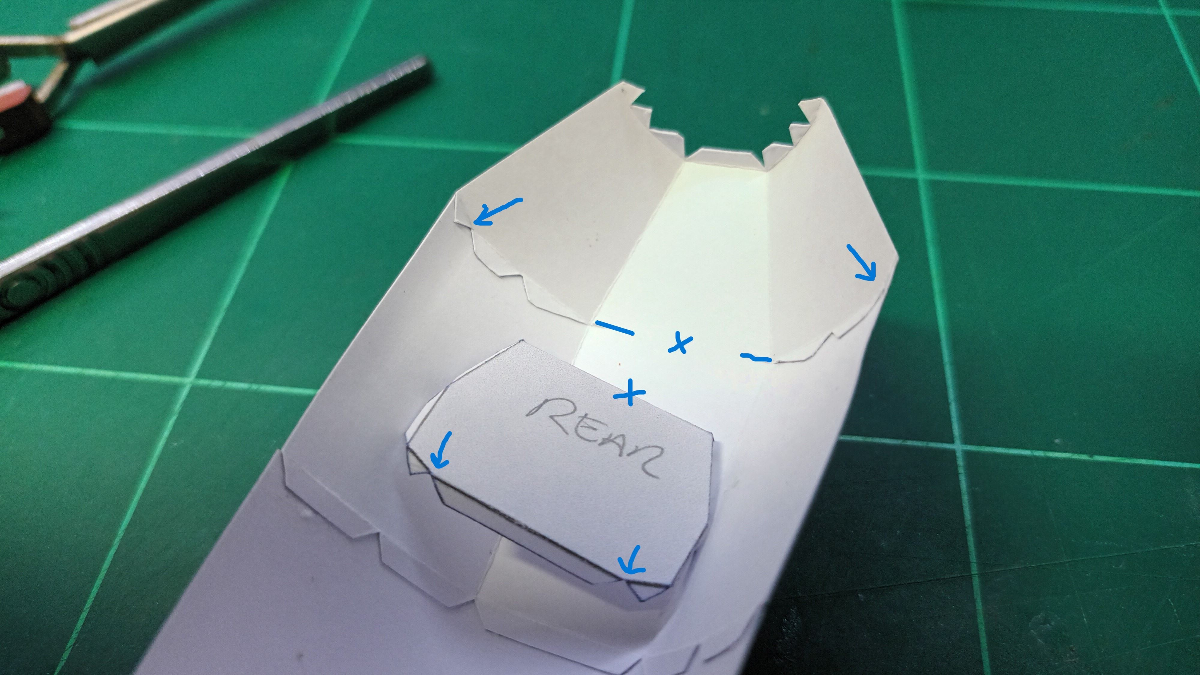

The rear bulk head has to be fitted correctly so that the hull conforms to the shape.
As the bulkhead was glued the rea of the ship began to take shape.
Slightly out of sequence here, bu the rest of the bulkheads went in with no problem.

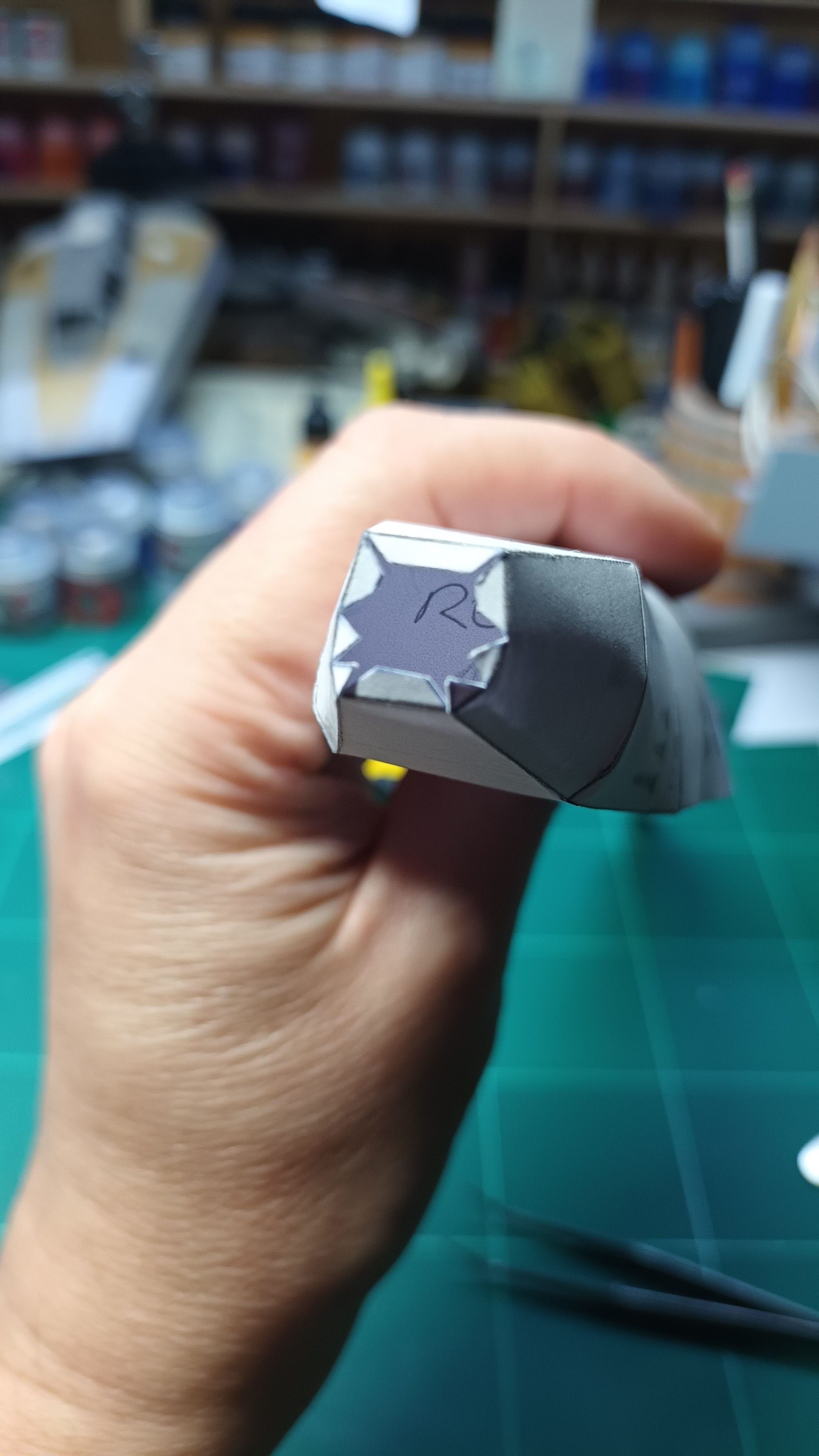

Backplate which fits over the rear bulkhead was acquired next.
A quick dry fit and it was fitted a tab at a time.
NOTE - I LEFT THIS PART TO PULL THE REST OF THE HULL TOGETHER & NOT GLUED TO THE BULHEAD UNDERNEATH.
Plate fitted.
This rear plate formed up the back of the ship quite nicely.

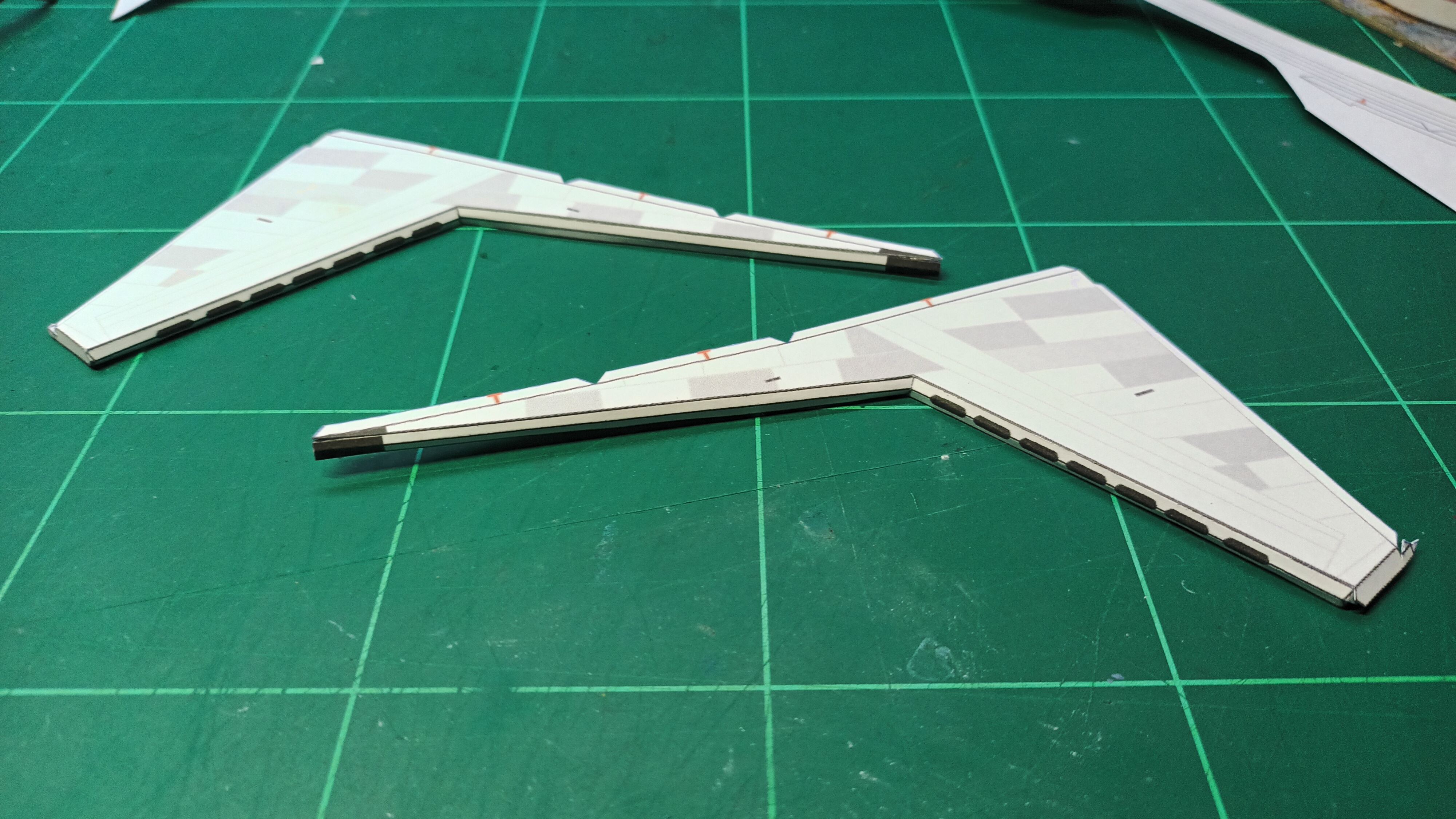

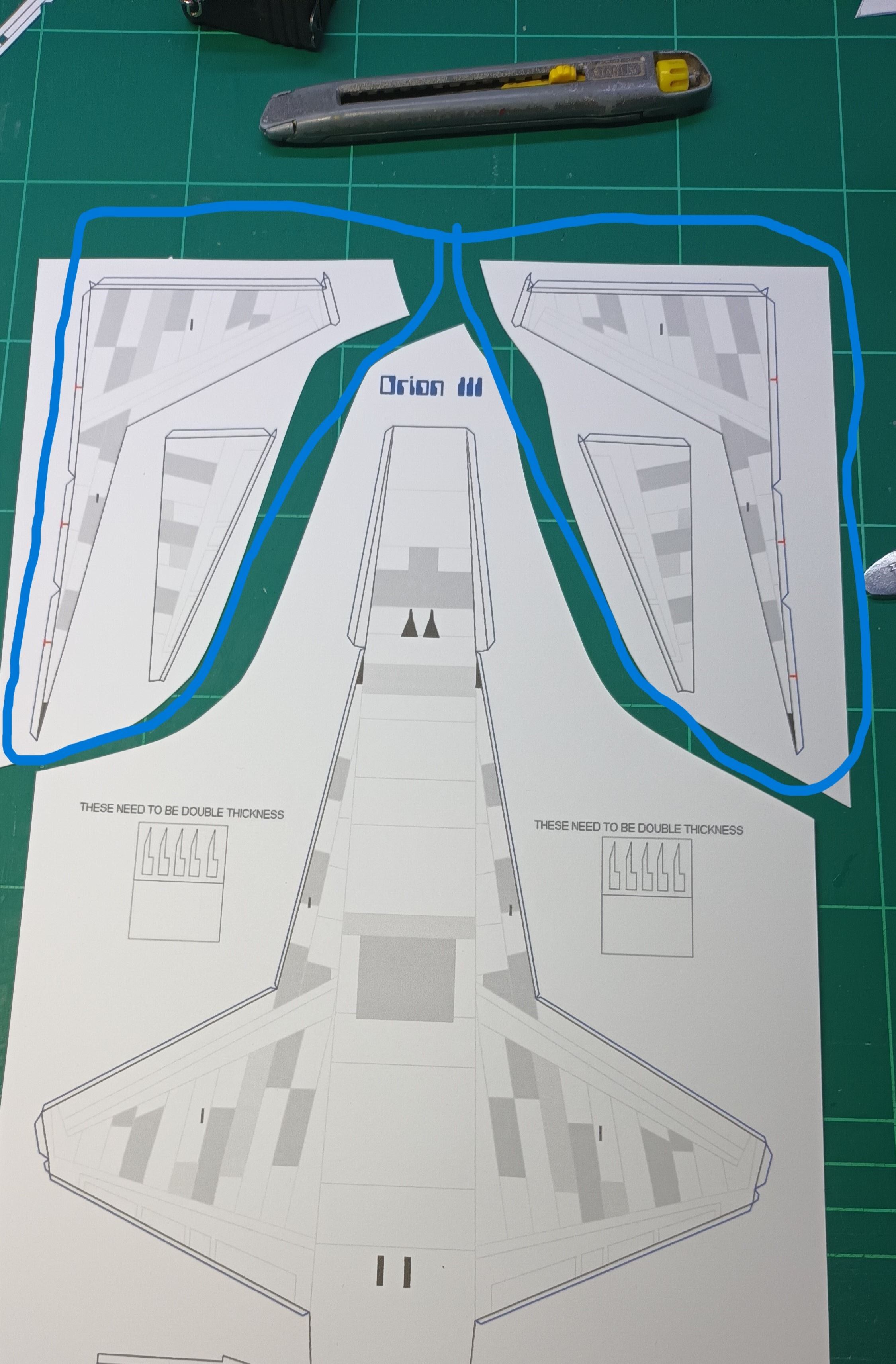

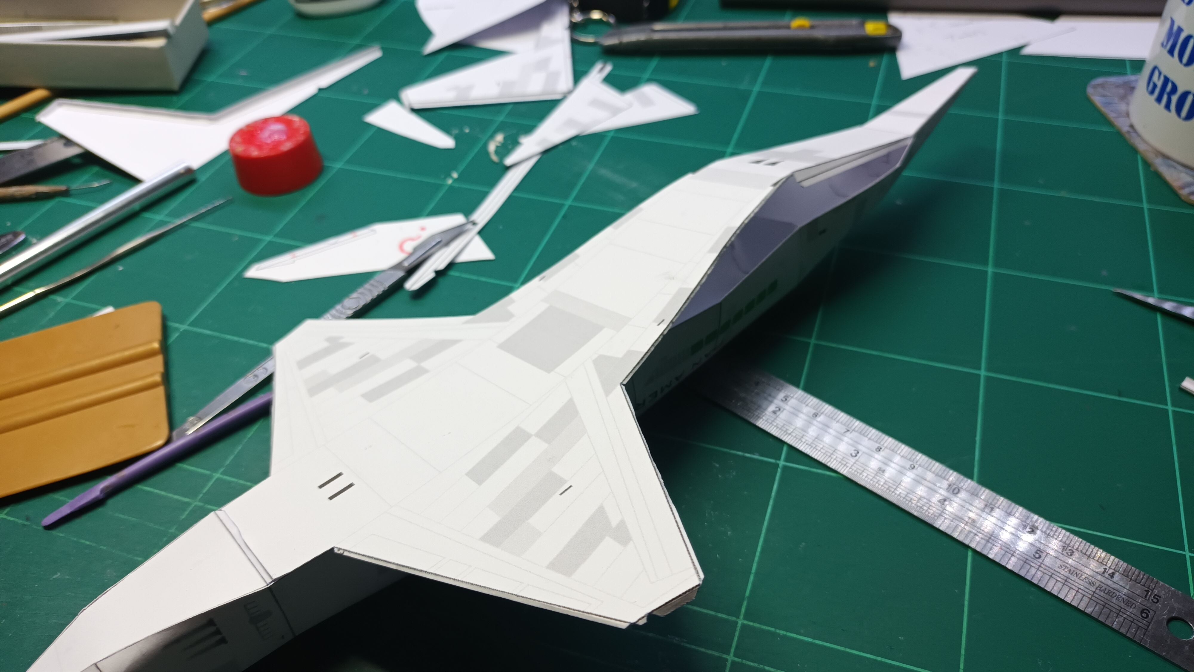

Upper wings were requested next.
ALL LINES TO BE CREASED - APART FROM THE INNER PART WHICH MEETS THE HULL - THESE ARE DENOTED WITH A '
RED T'
However further into the build these should be creased downwards.

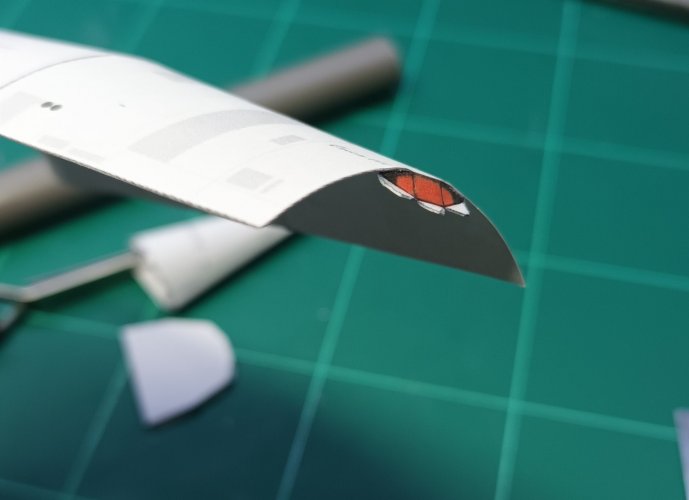

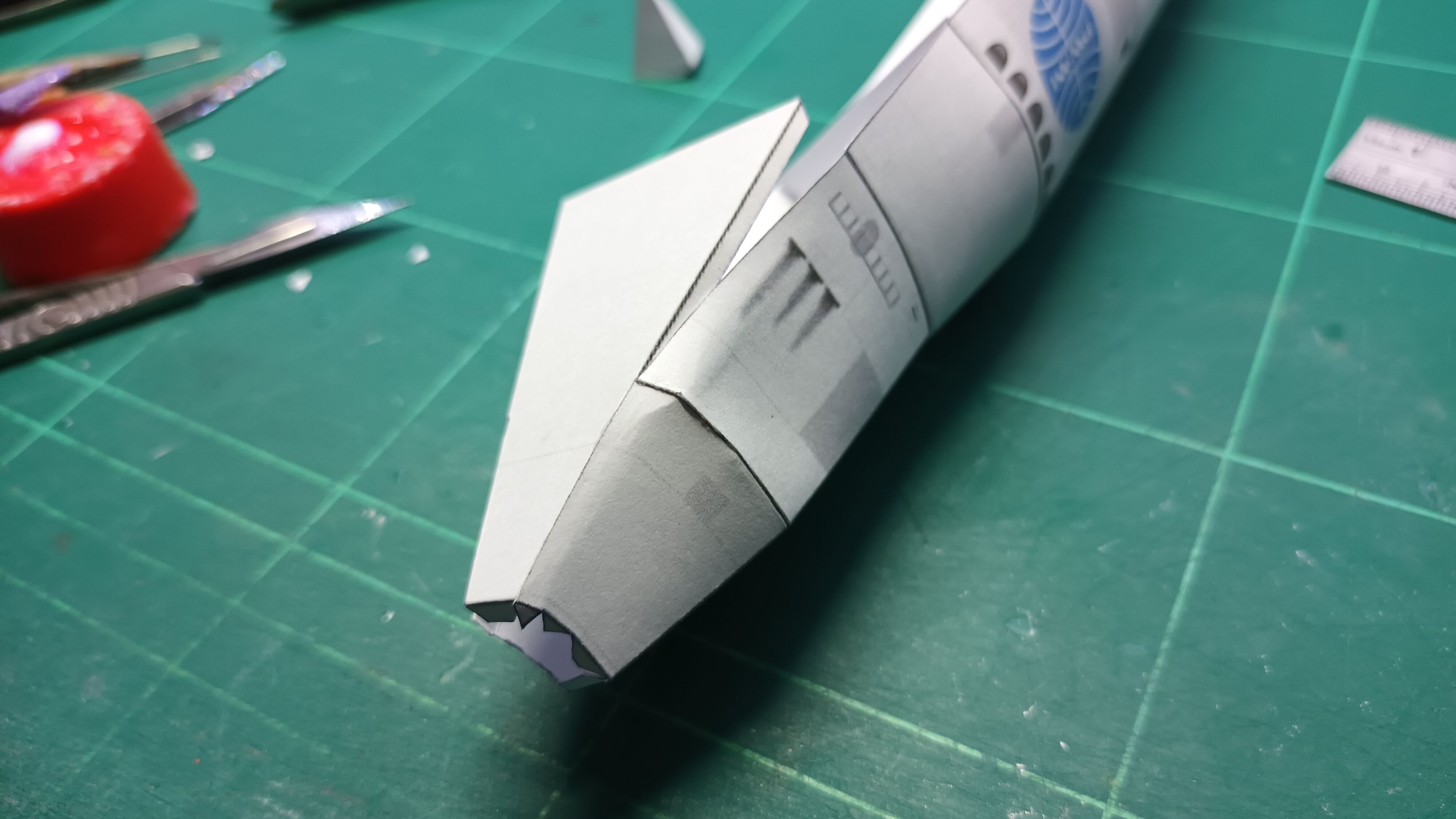

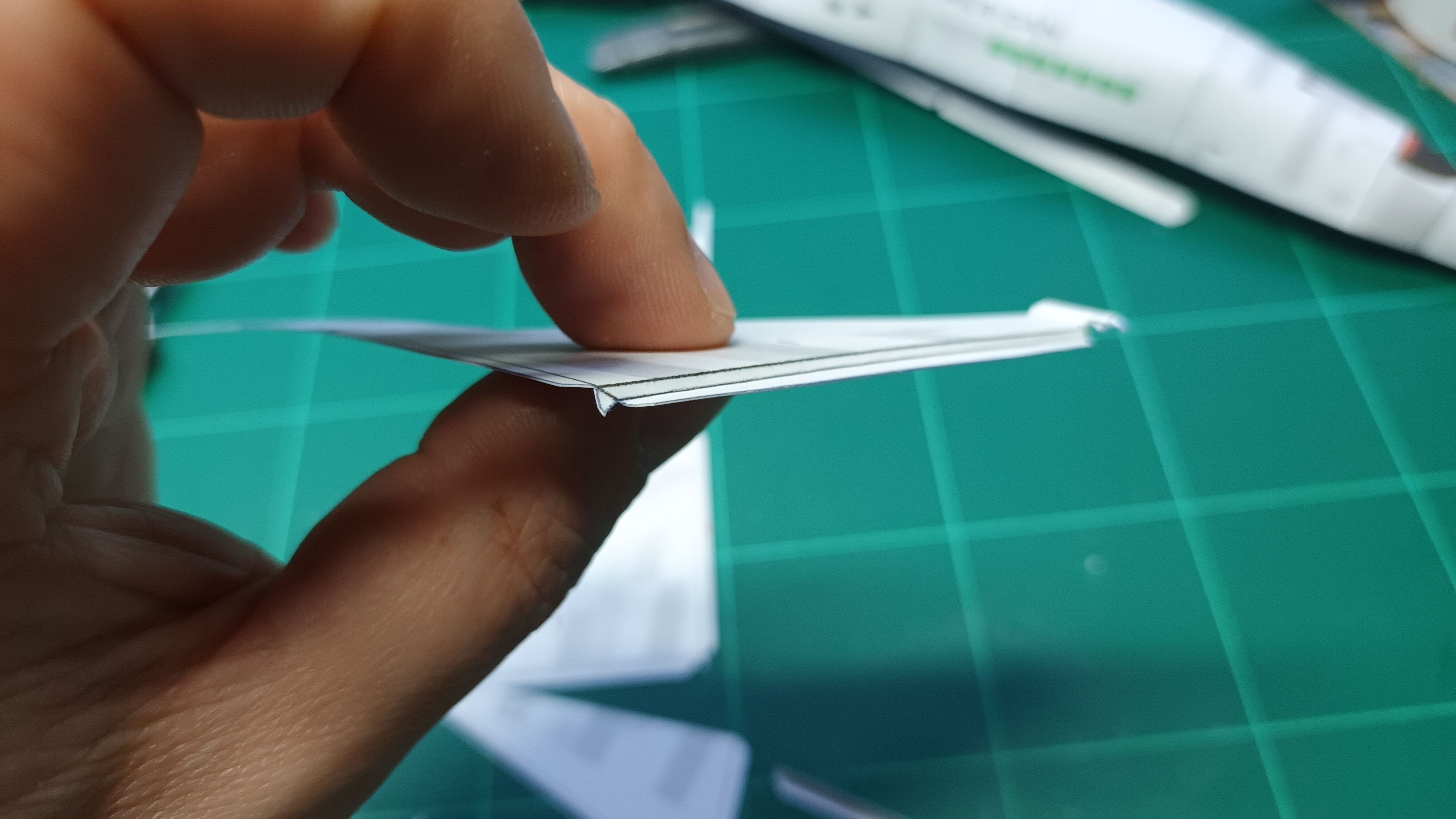

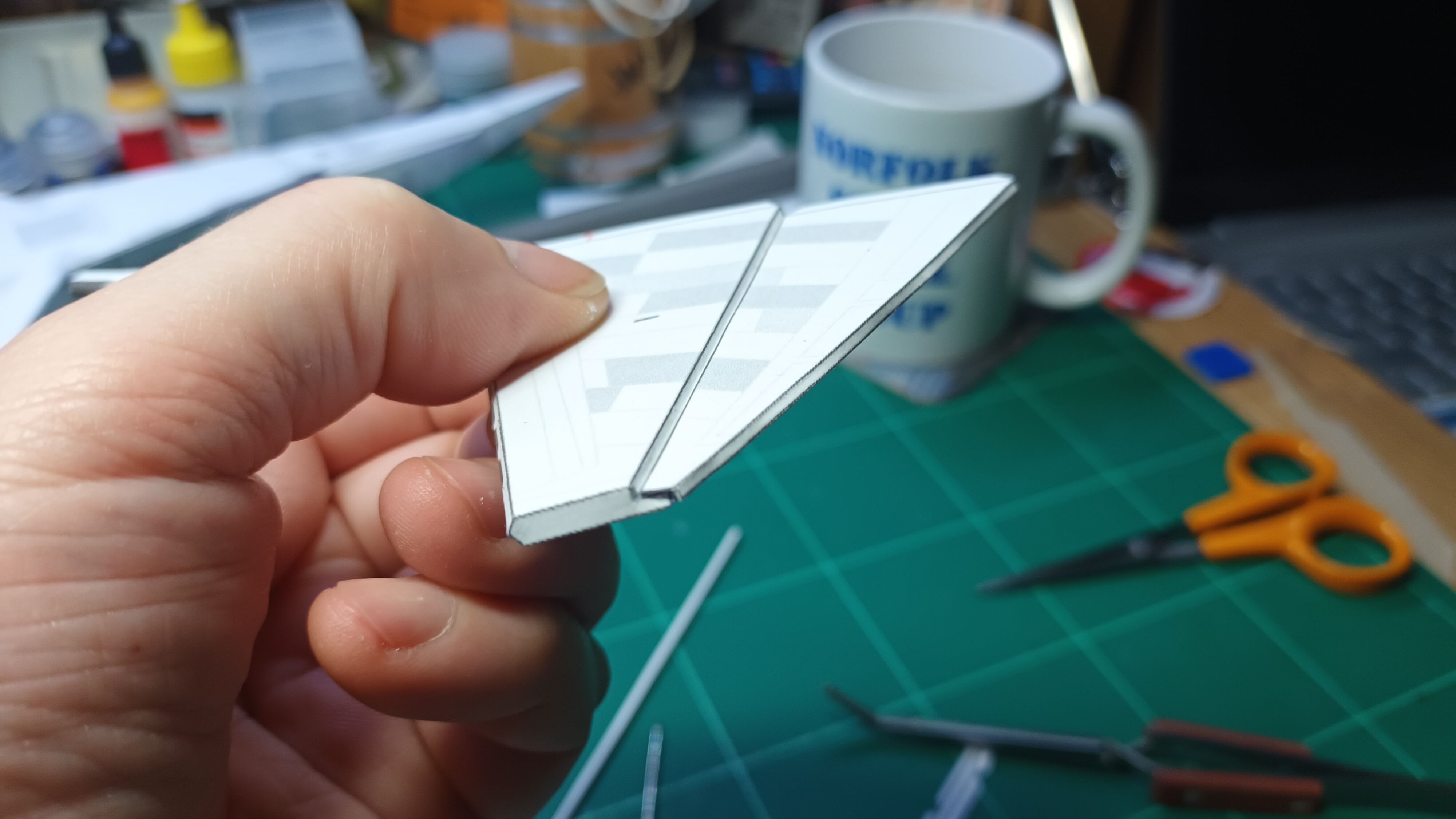

The rear edge of the wing needs to be stepped down.
Trying to show the step with the wingtip bent upwards.

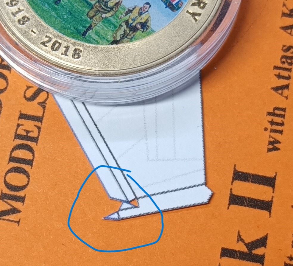

Close up of the wing tip as to what needs to be cut out.

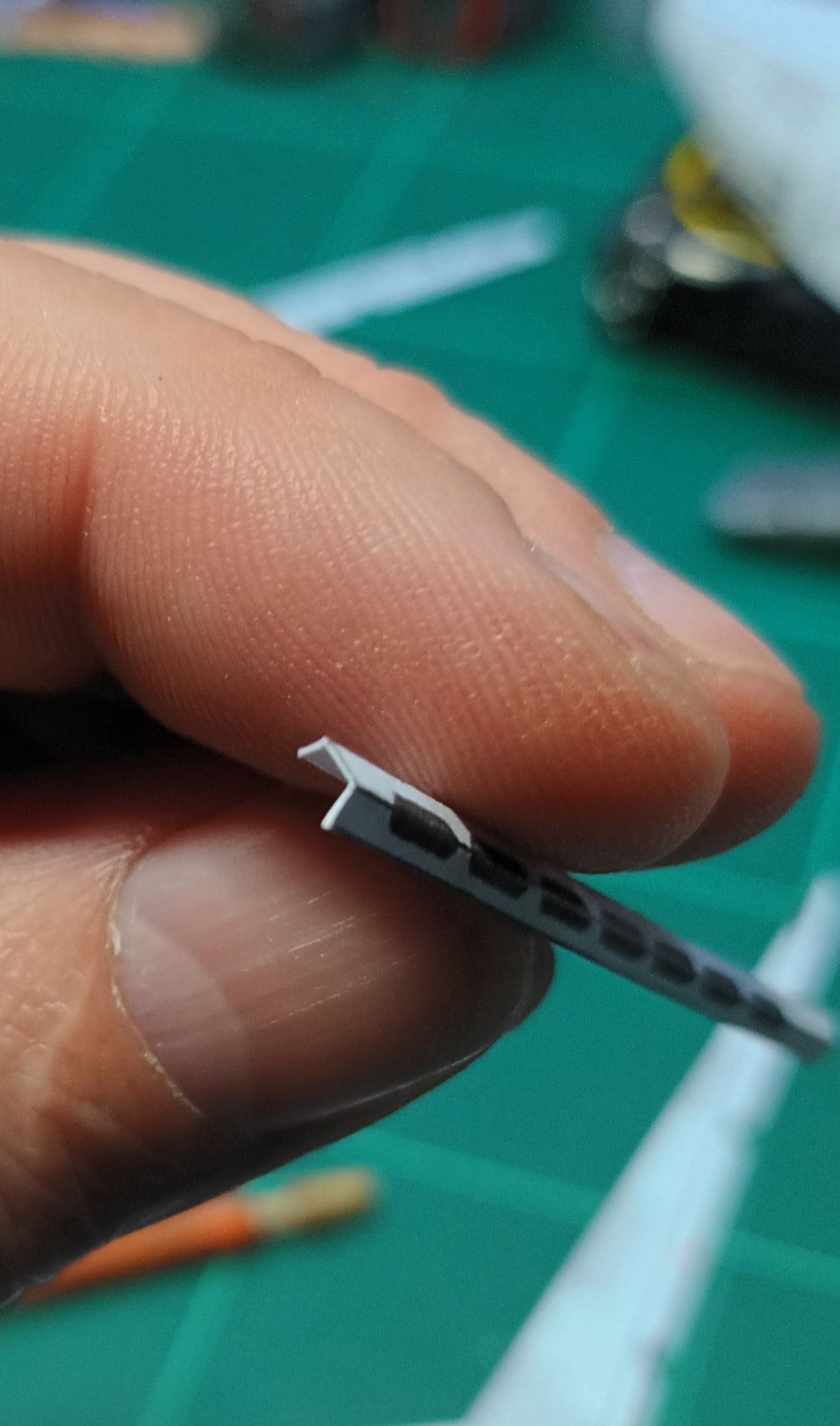

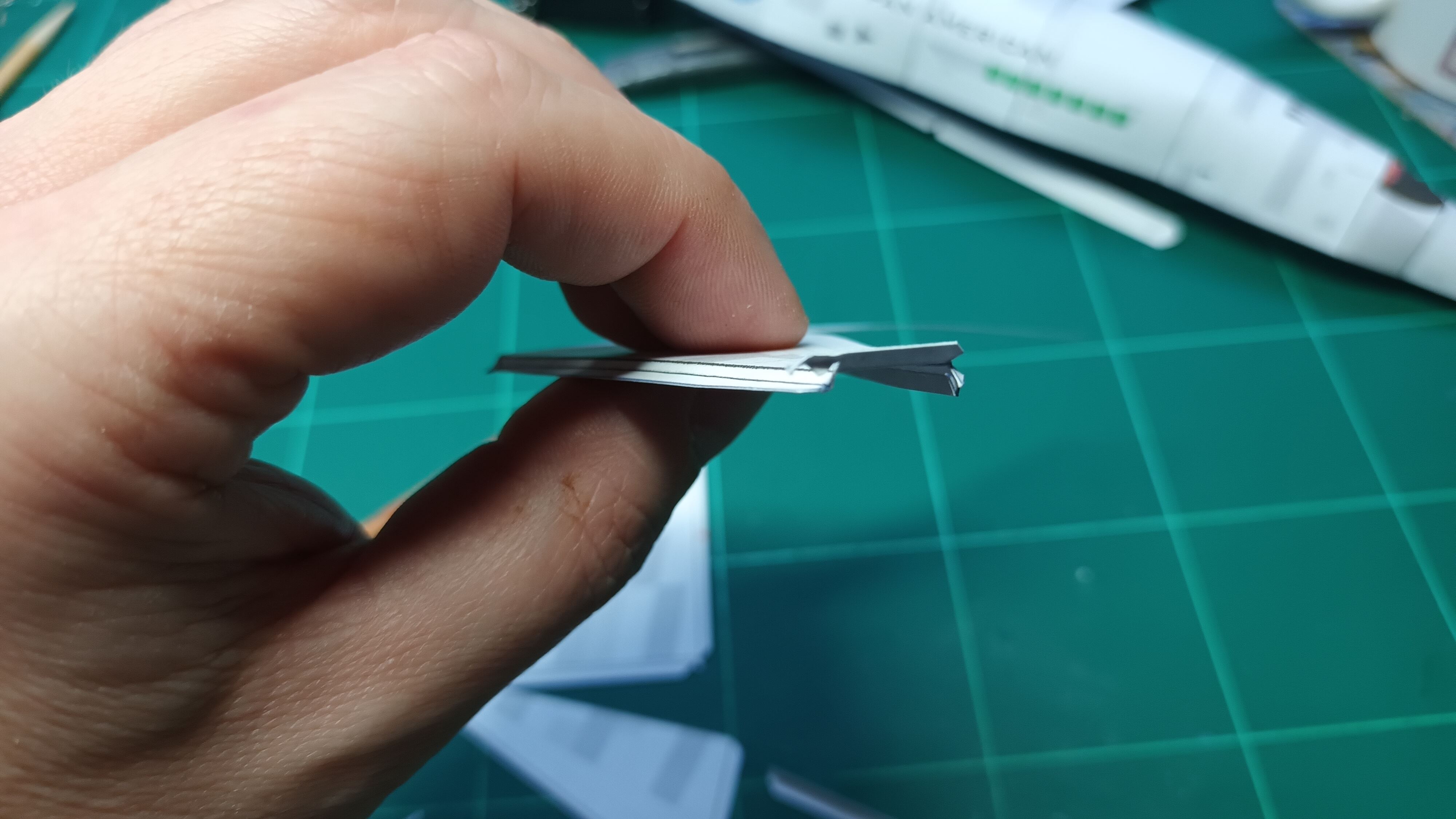

These parts are the trailing edge.
NOTE EVERY LINE HERE NEEDS TO BE CREASED

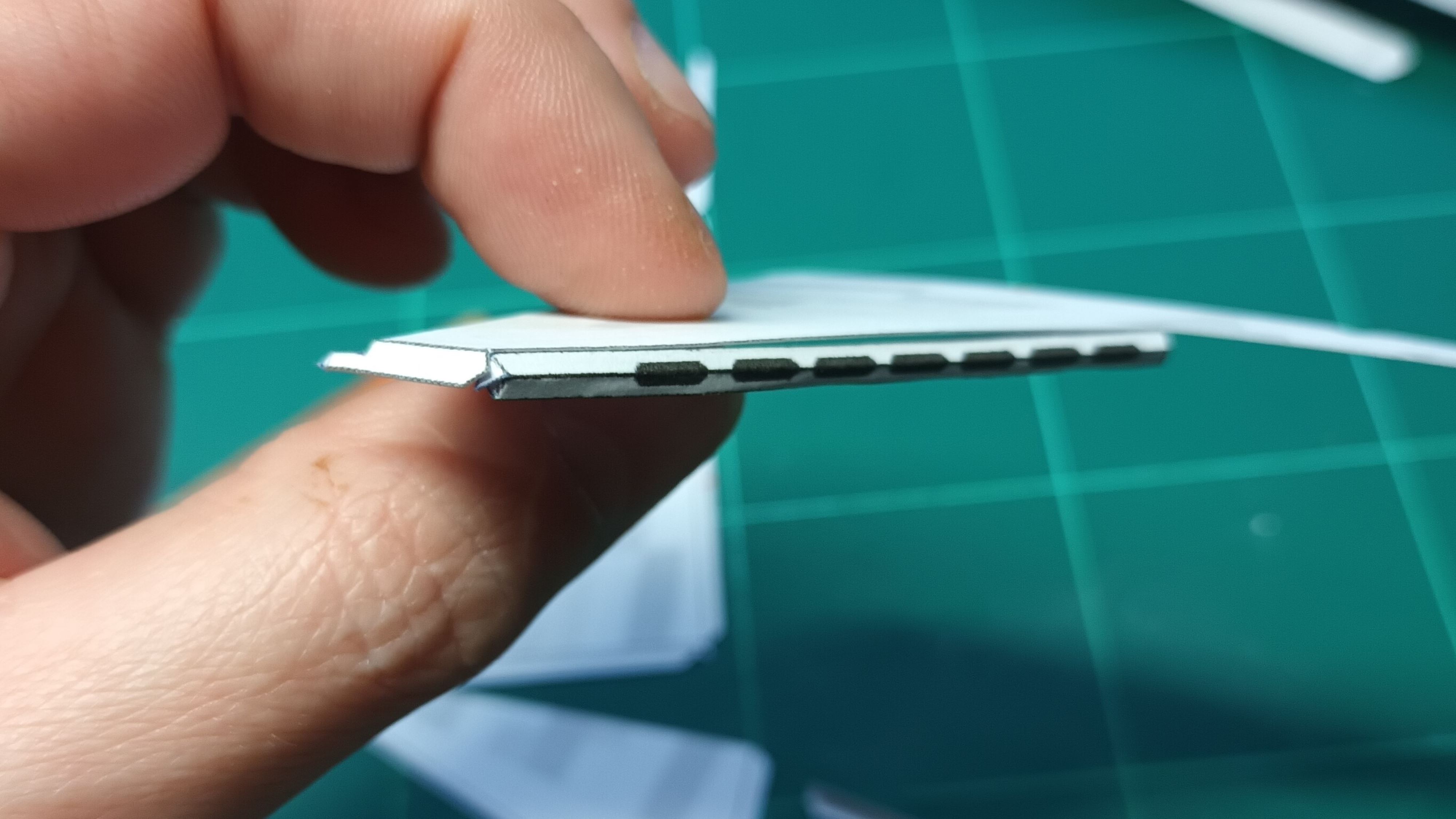

Outer most leading edge to be formed like this
...and the other end
The leading edge fitted to the top starboard side wing.
The other part of the front leading edge needs to be creased and bent in the same way,
After all that, the front parts of the upper wings should look something like this.
The rear flaps on the upper wing are not yet attached, the parts circled are yet to be identified, but I'm sure they have something to do with them, so I have cut out the underside belly to better understand the fit.

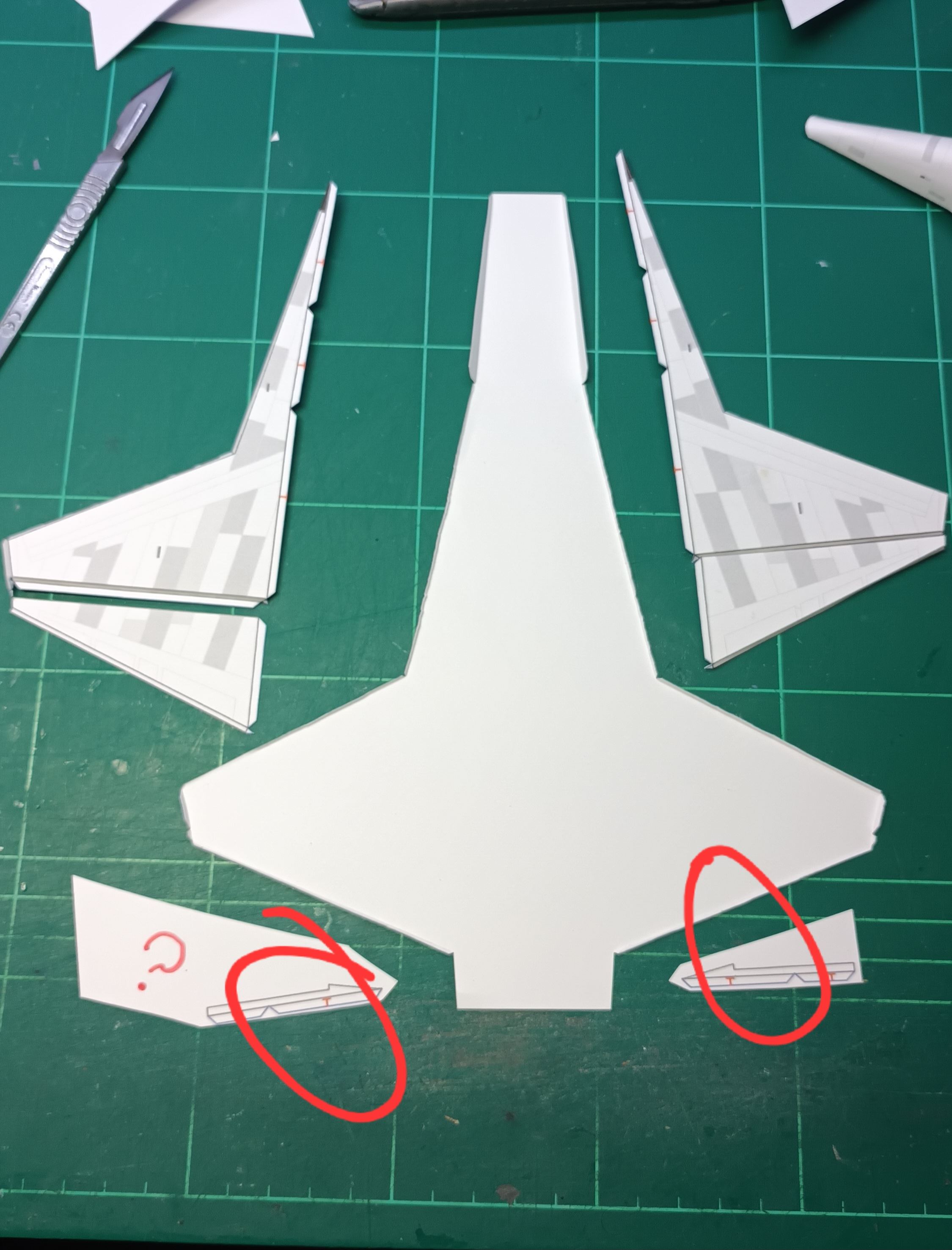

looking at these bits (last 2 parts for rear of fuselage) would they go along the fuselage at the rear of the wings (where the flaps meet the fuselage?) AGF000041.jpg
although the build is a mainly simple one this is one of those 'hmmmmm......?' parts not detailed lol. Your build is coming along great :BRAVO:
looking at these bits (last 2 parts for rear of fuselage) would they go along the fuselage at the rear of the wings (where the flaps meet the fuselage?) View attachment 216362
Yes. I'm quite sure they do, as to their orientation and fit, that's the £100 question!

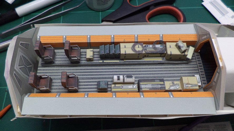

A couple of years ago I made the Moon Bus, it had a full interior, although most of its hidden, most of the internals are structure related, so I would seem plausible you would have make most of it anyway.
As to how much you add is up to you...
My Moon Bus interior

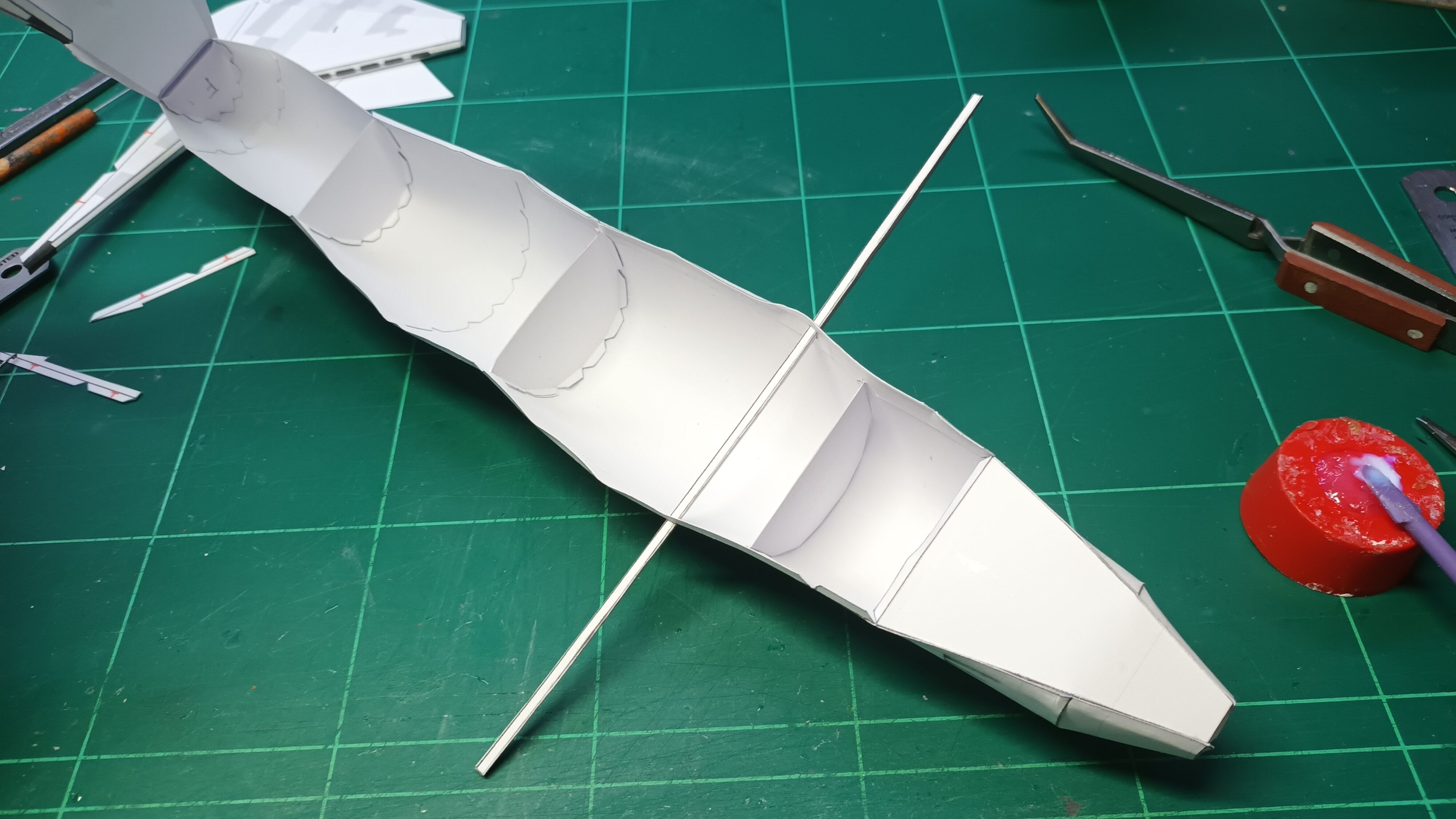

Getting nowhere with the instructions and dry fitting becoming too complex to fathom, I attached the bottom hull to the nose cone tab.
This let me raise and lower the belly to see where everything needed to go.

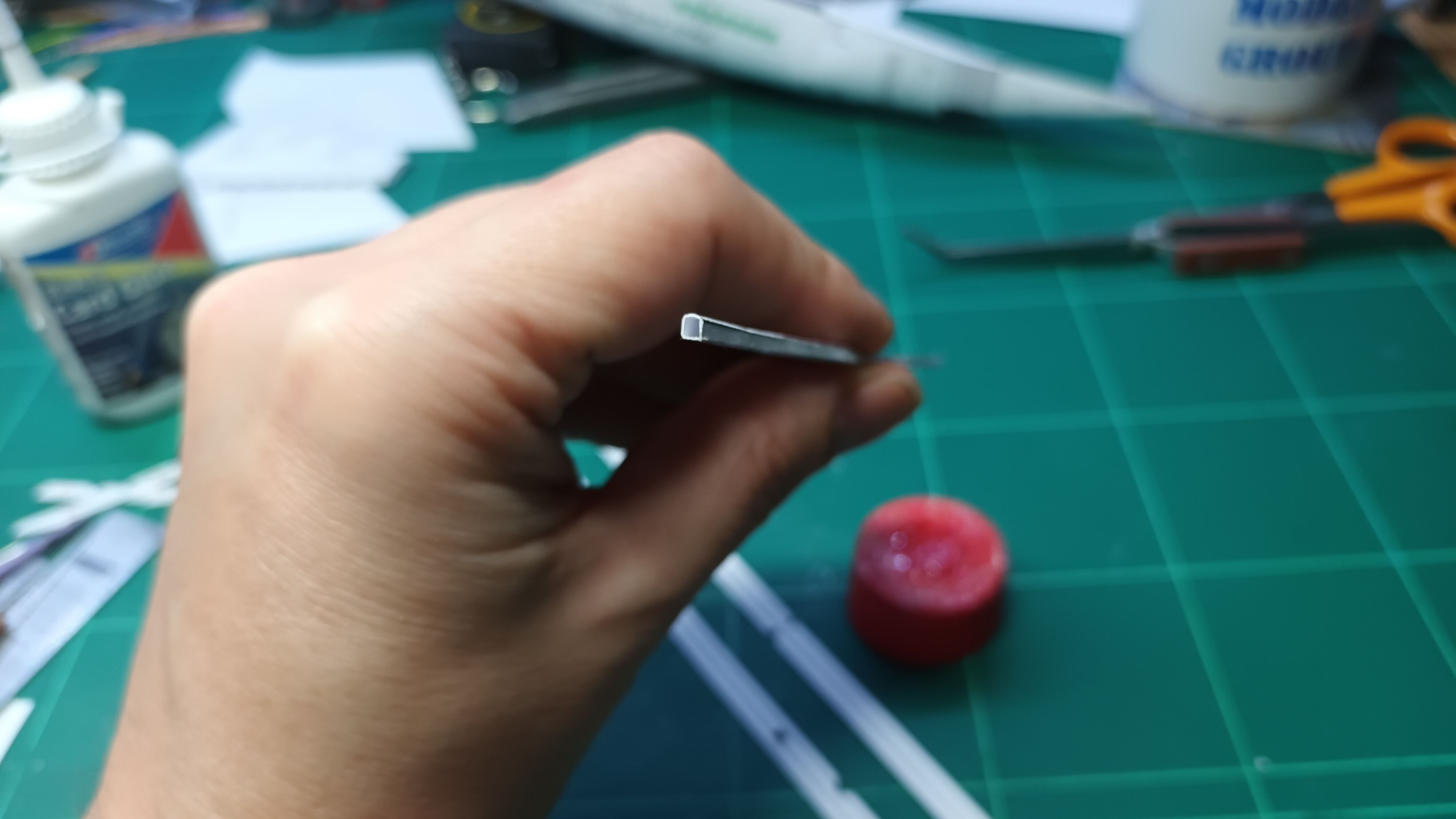

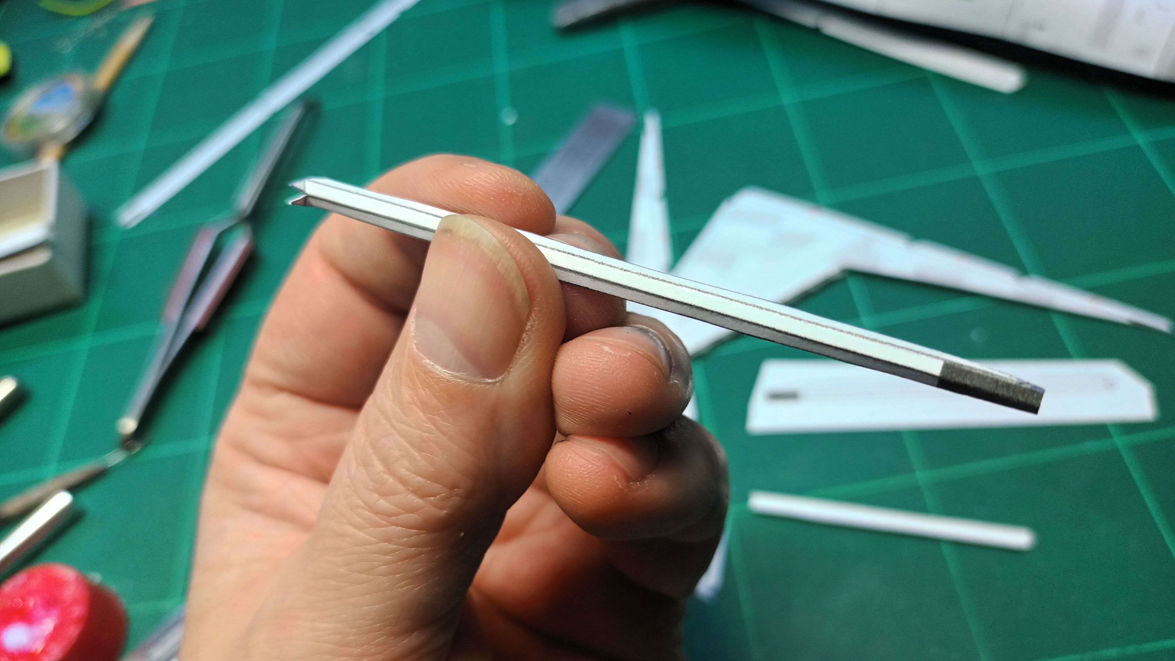

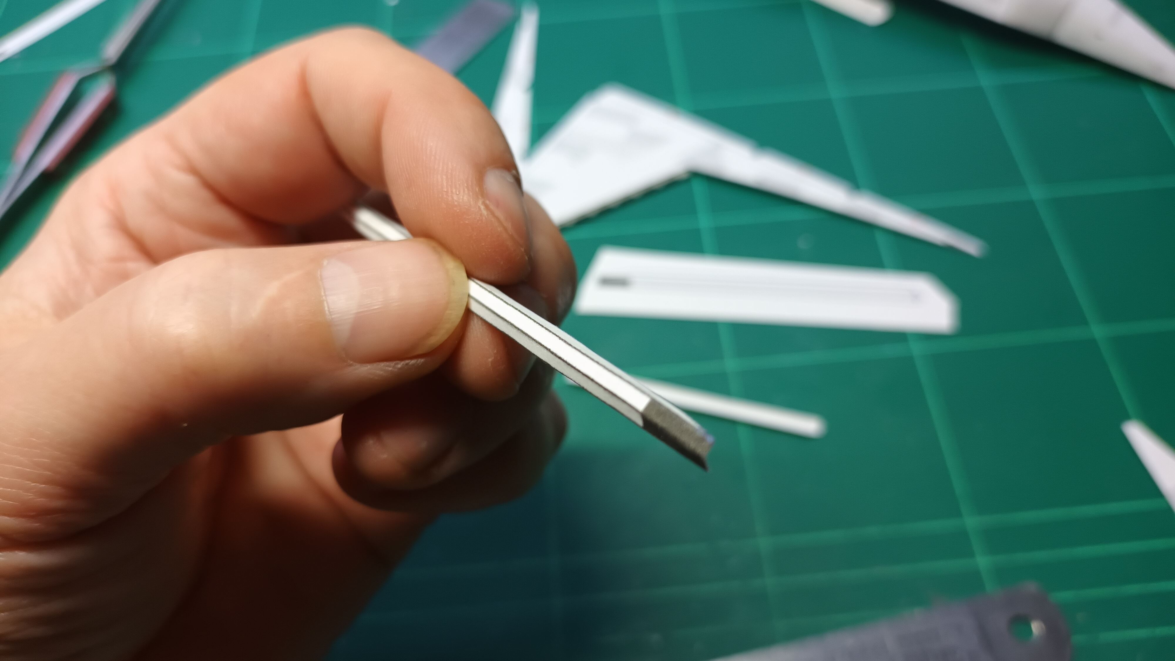

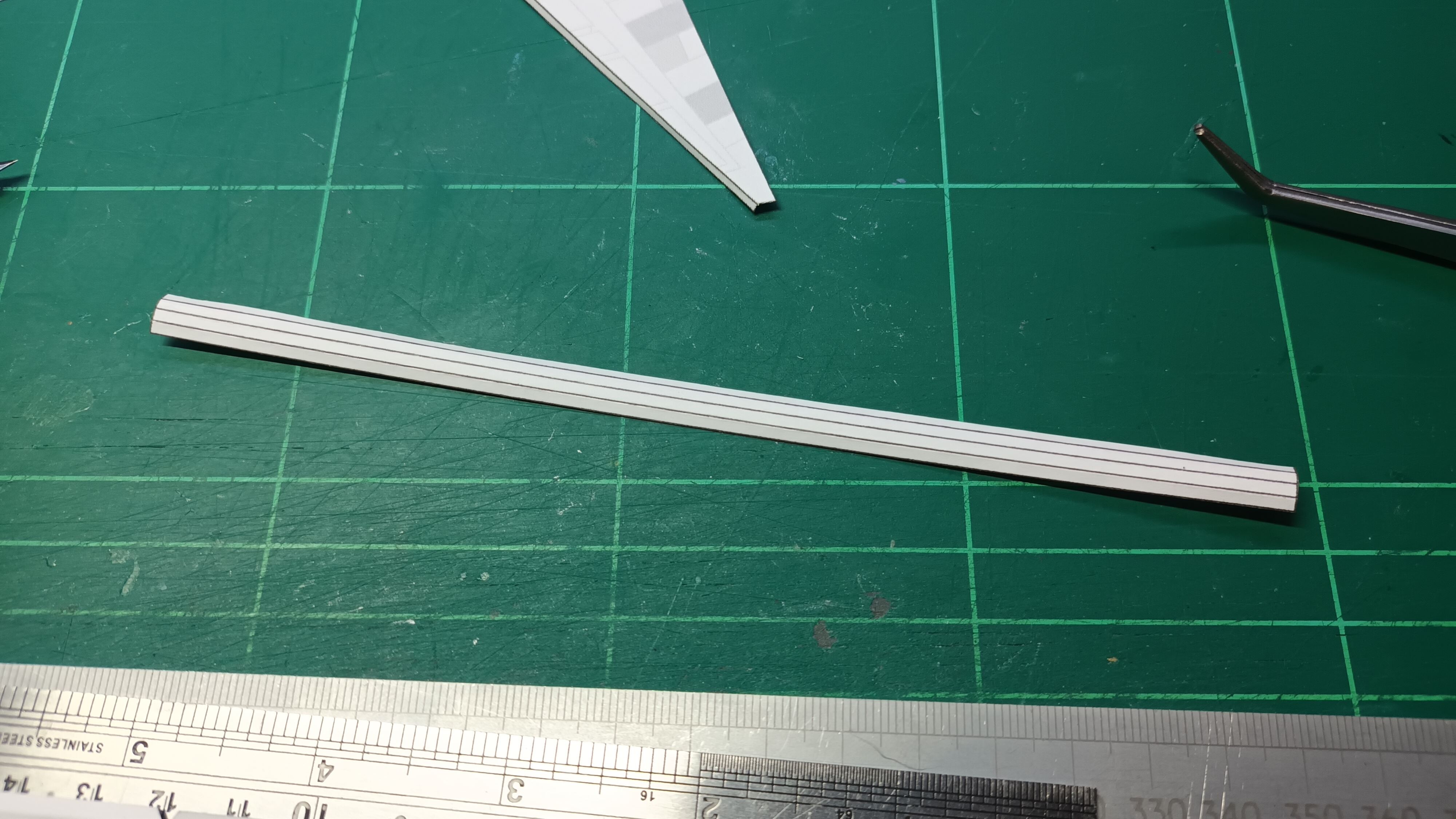

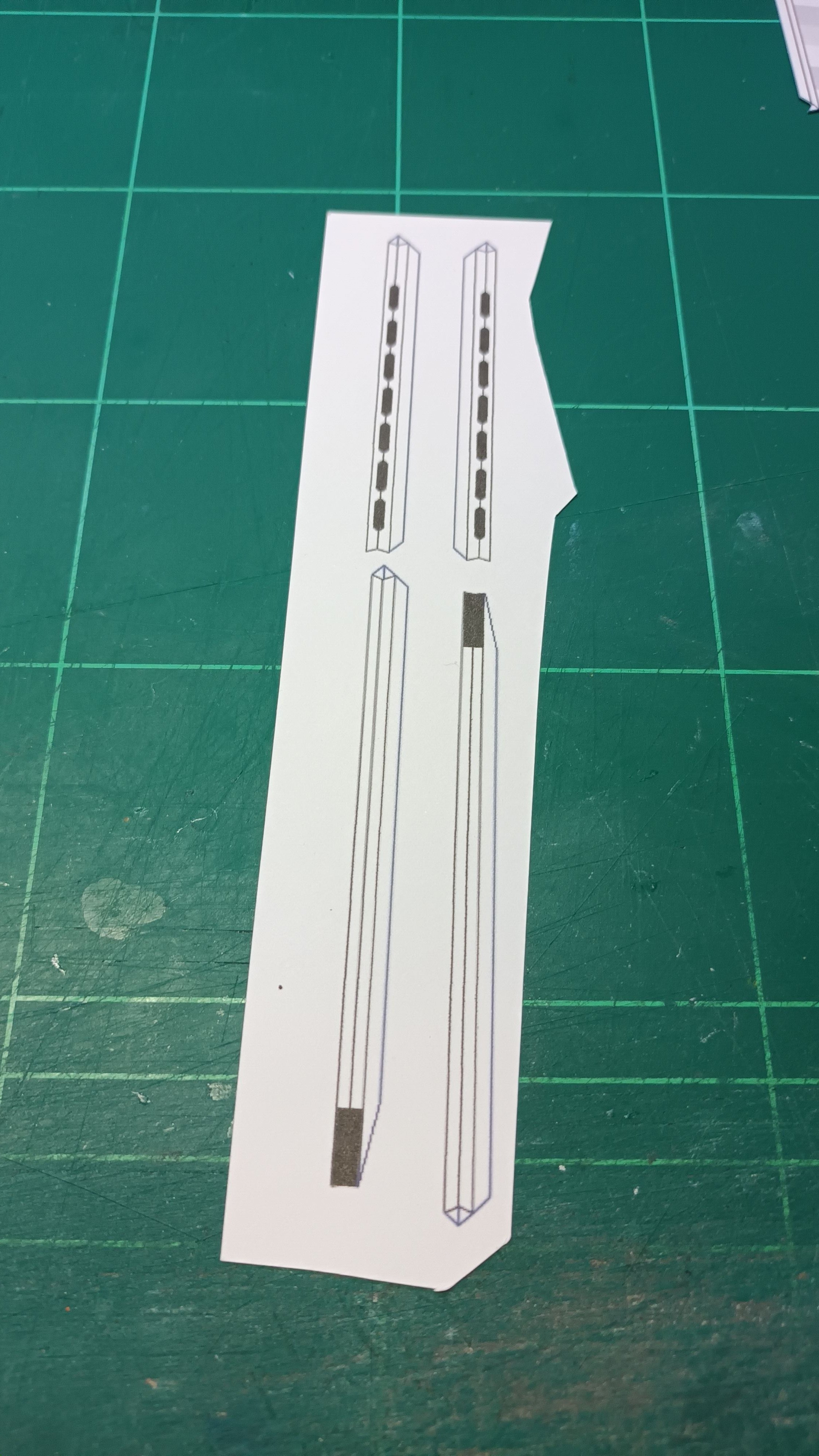

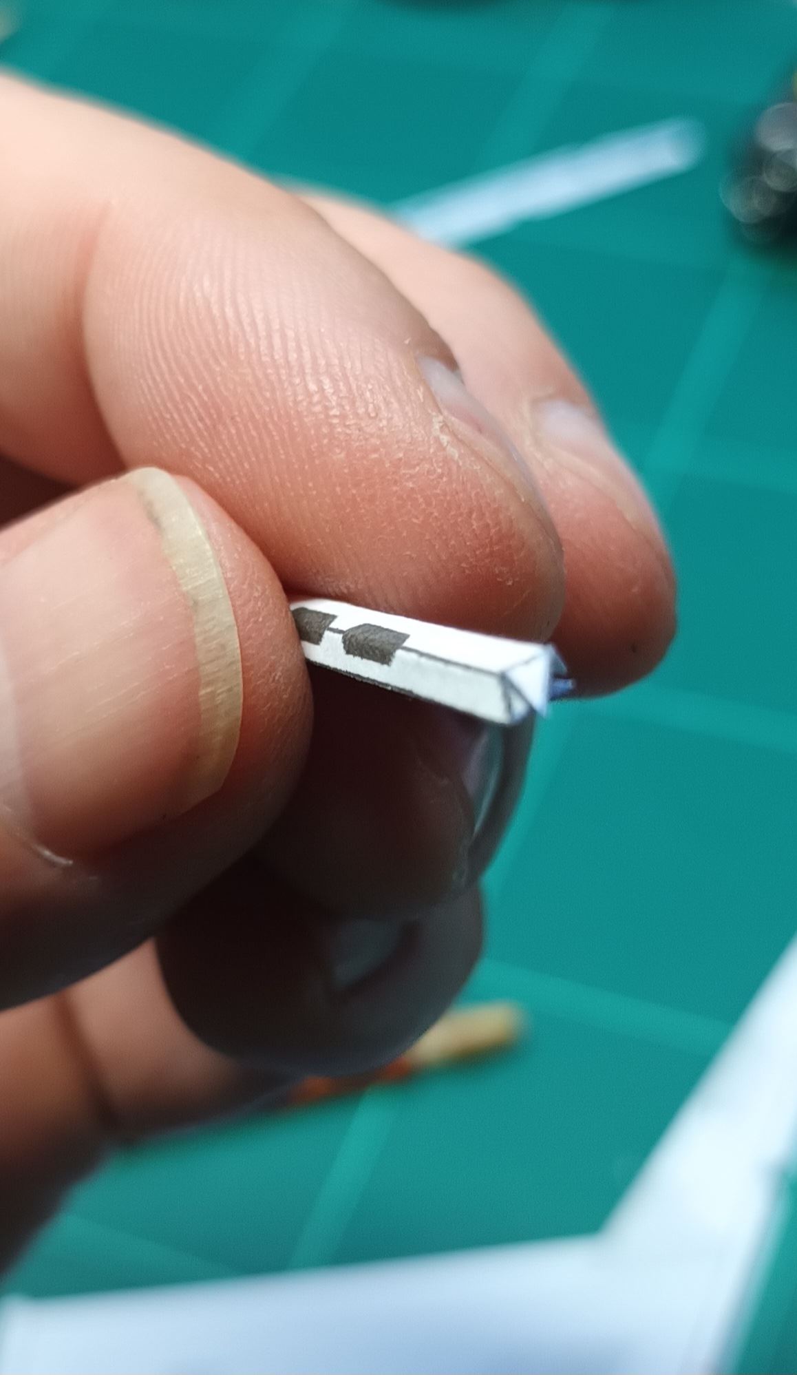

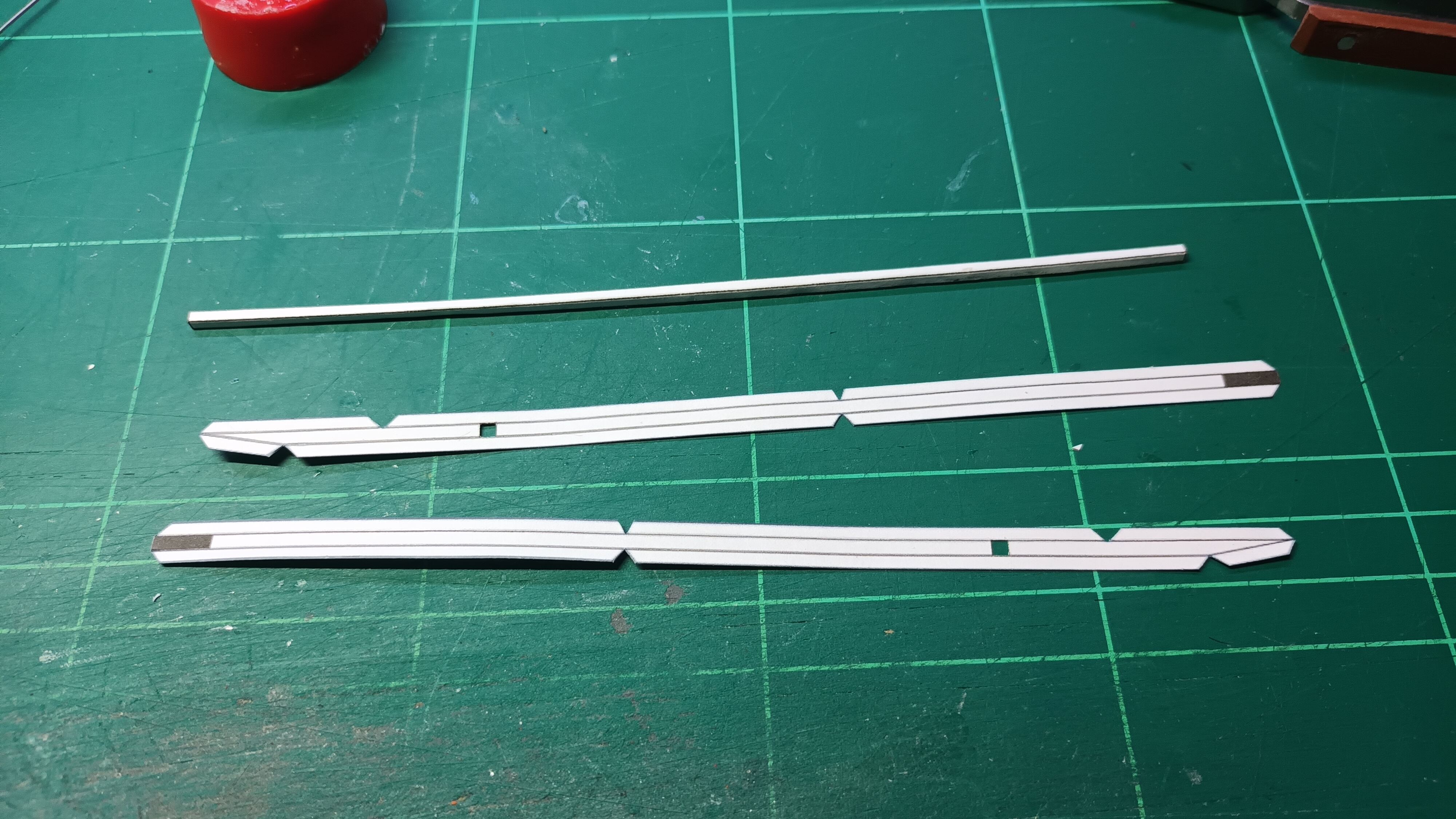

A main wing spar runs through the wings, folded into a square tube.
Main belly dry fit.

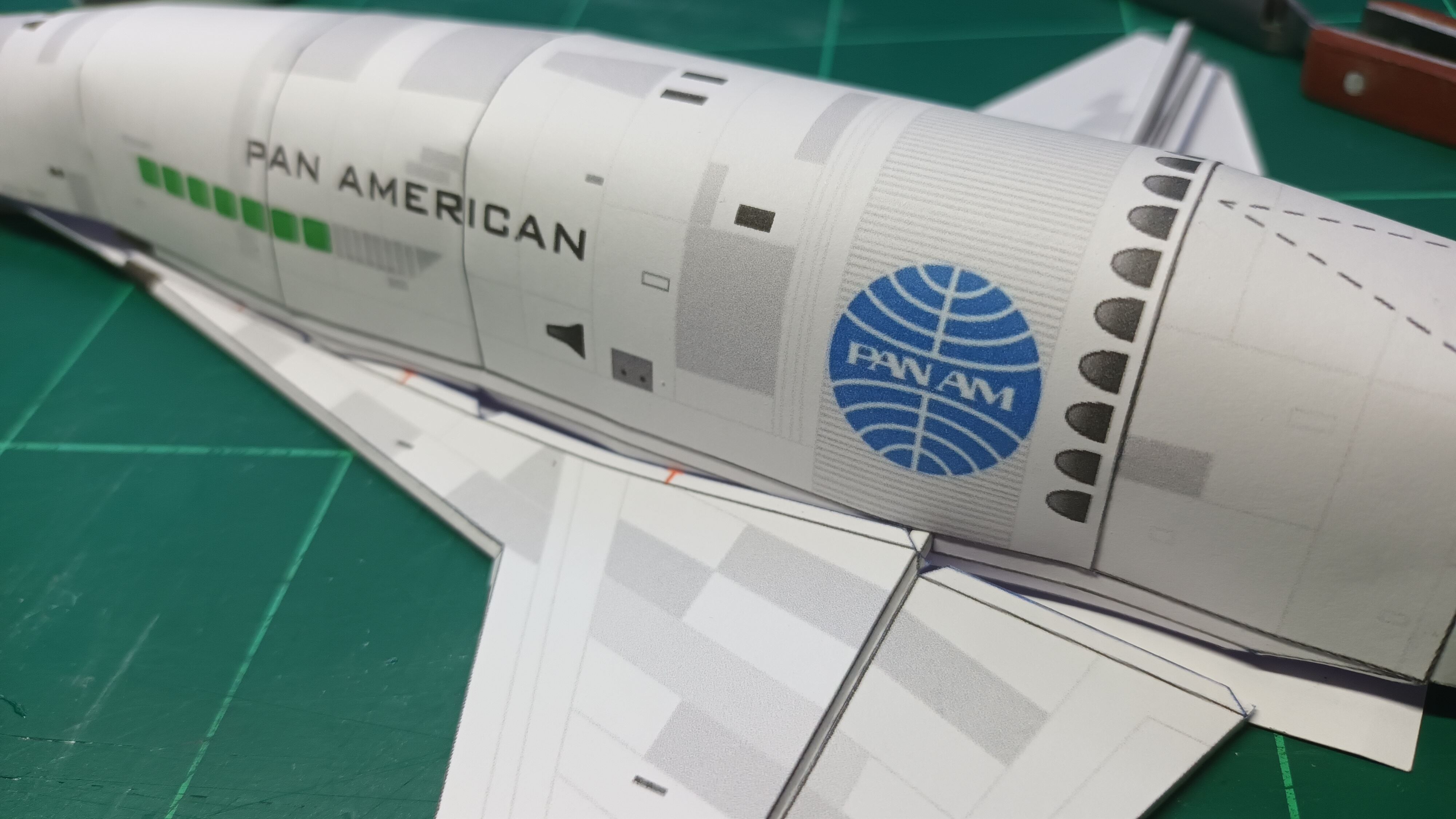

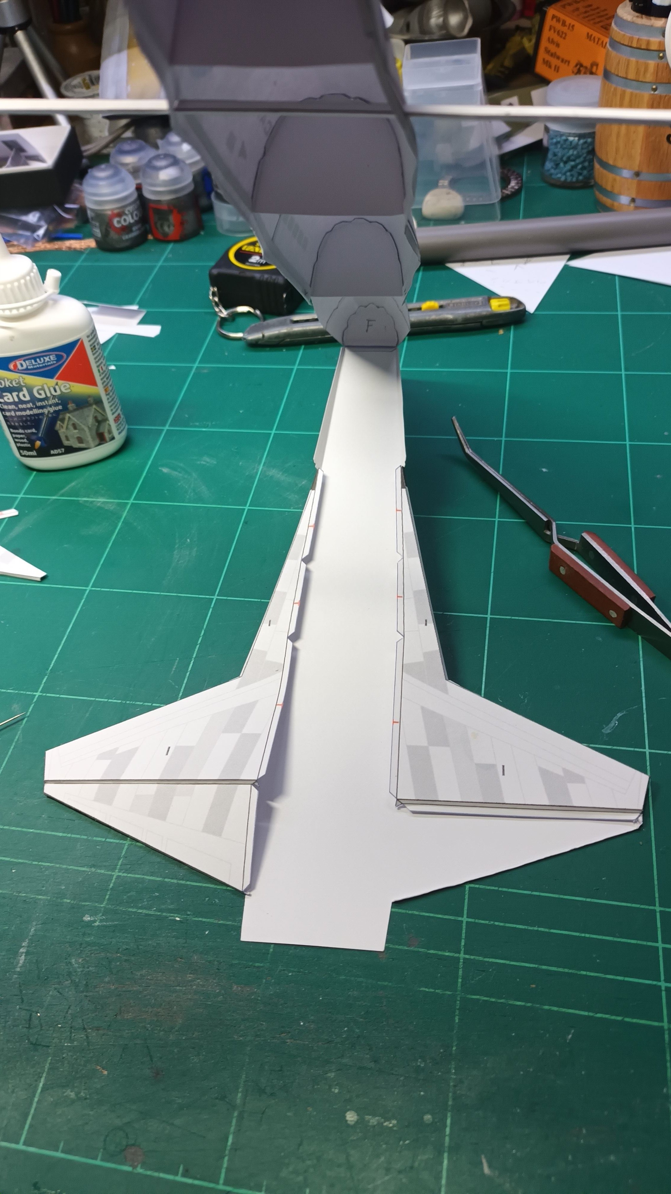

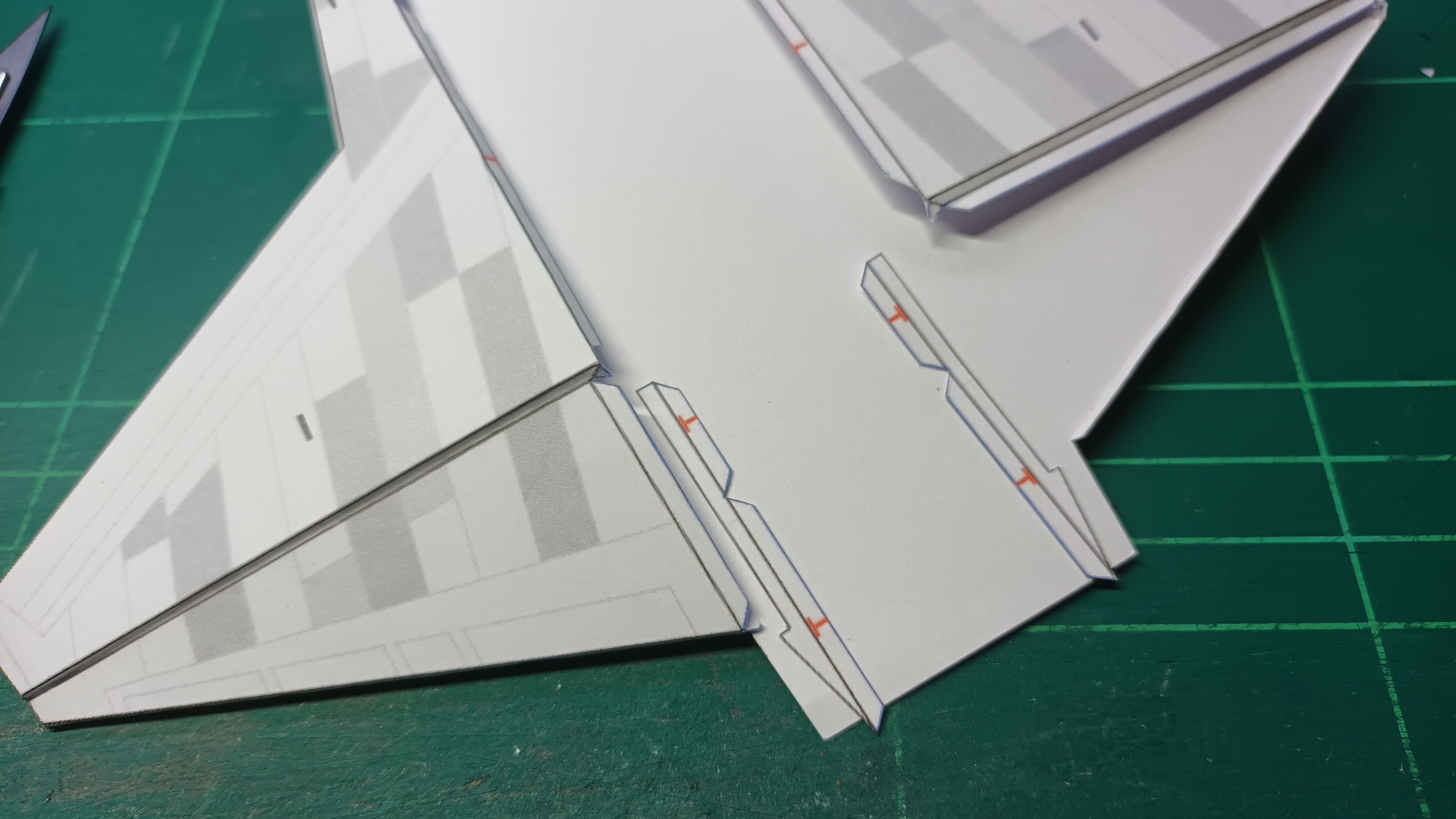

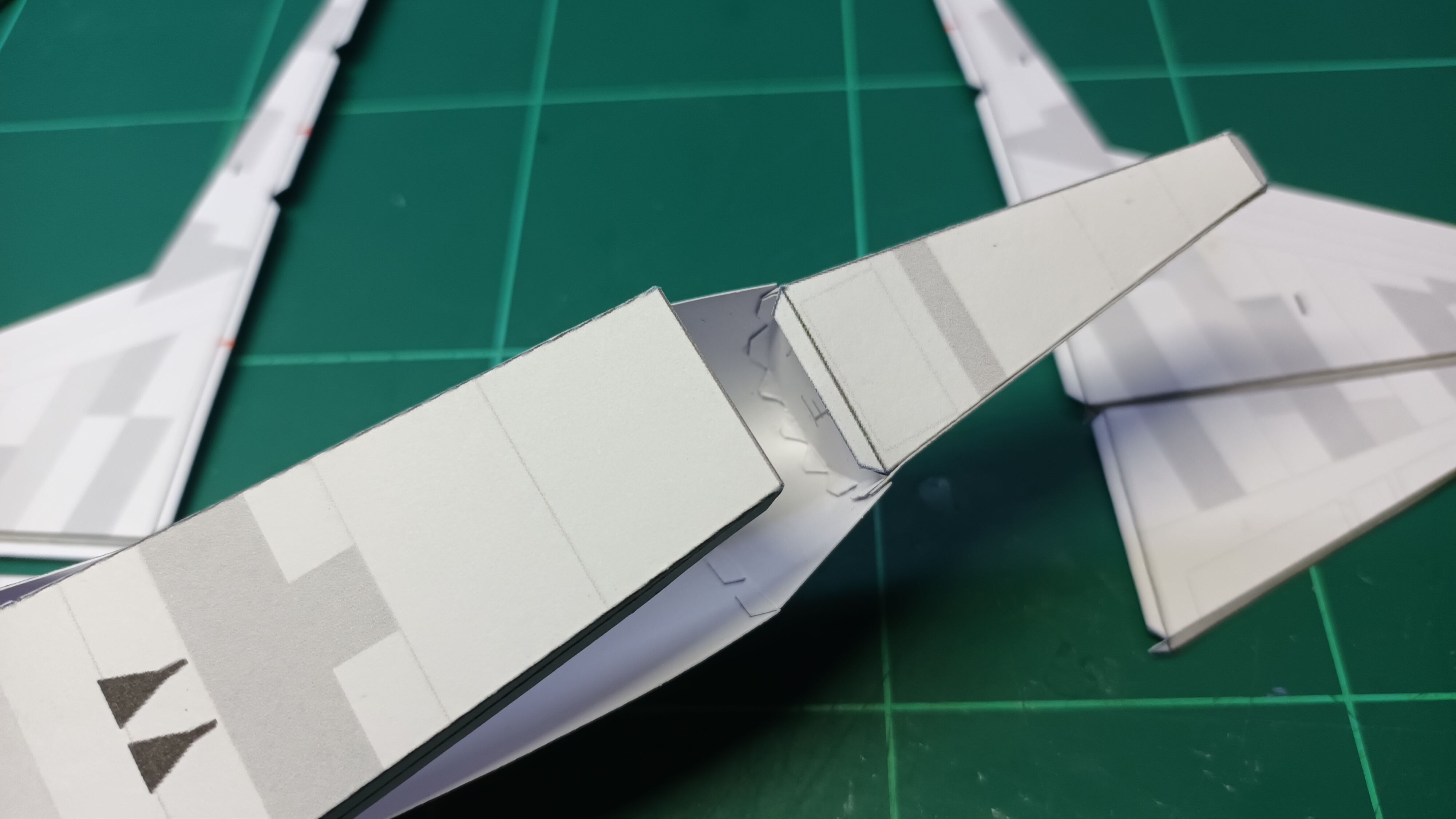

Rear part of main top wing added - once again, note the step in the wing.

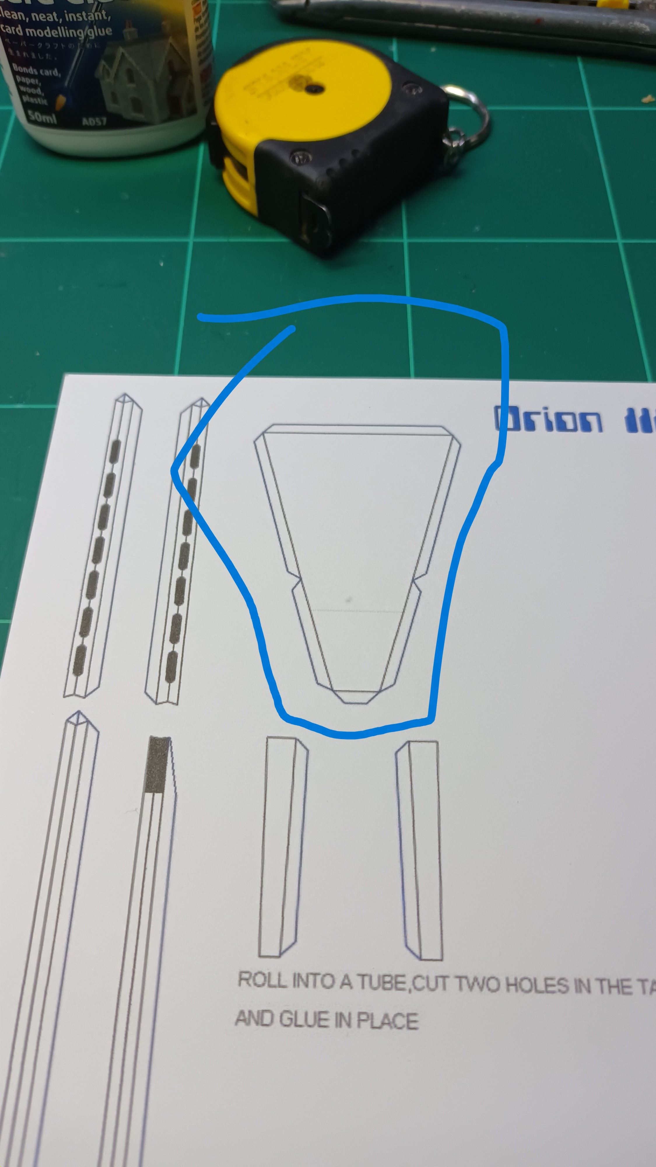

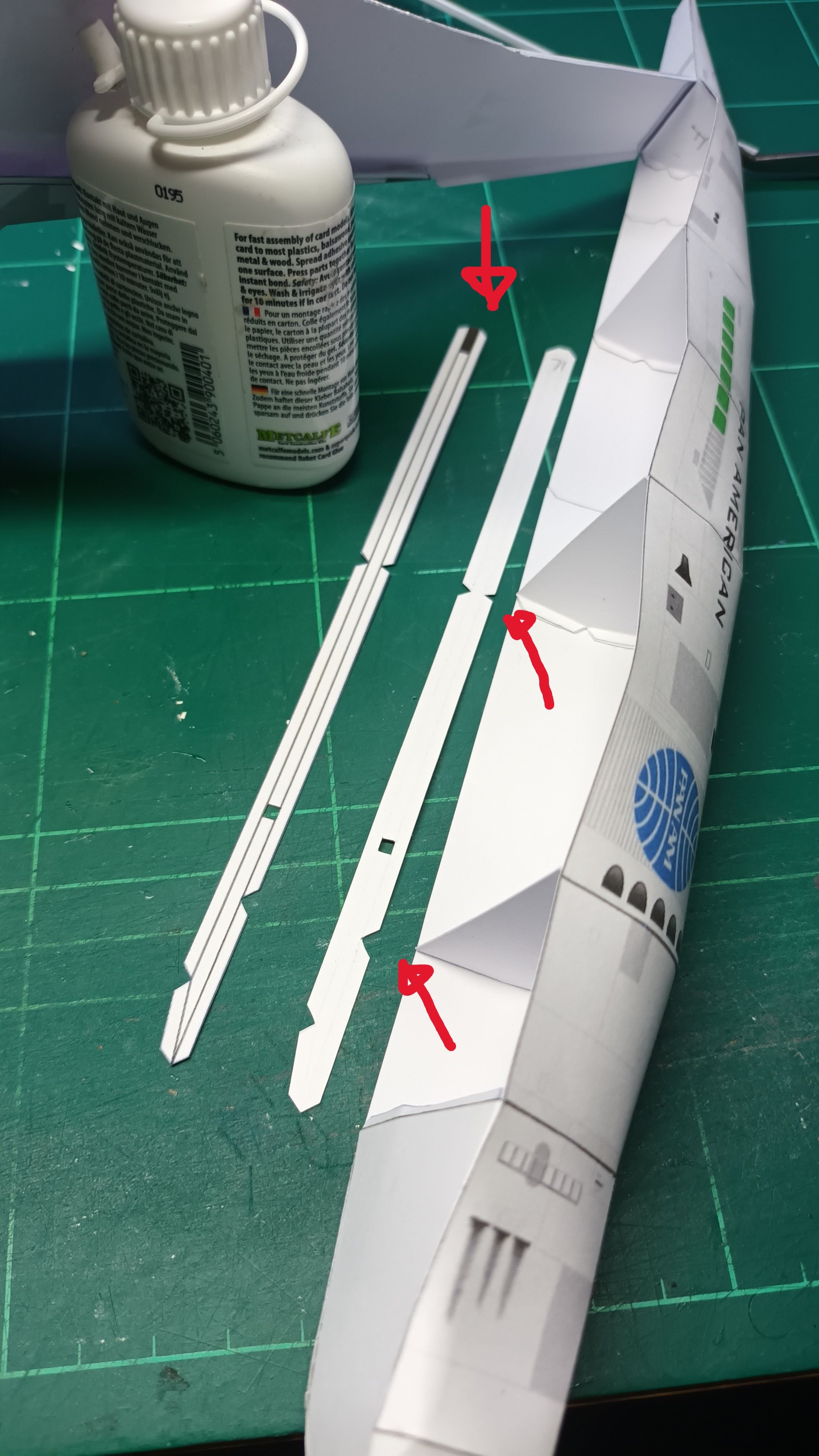

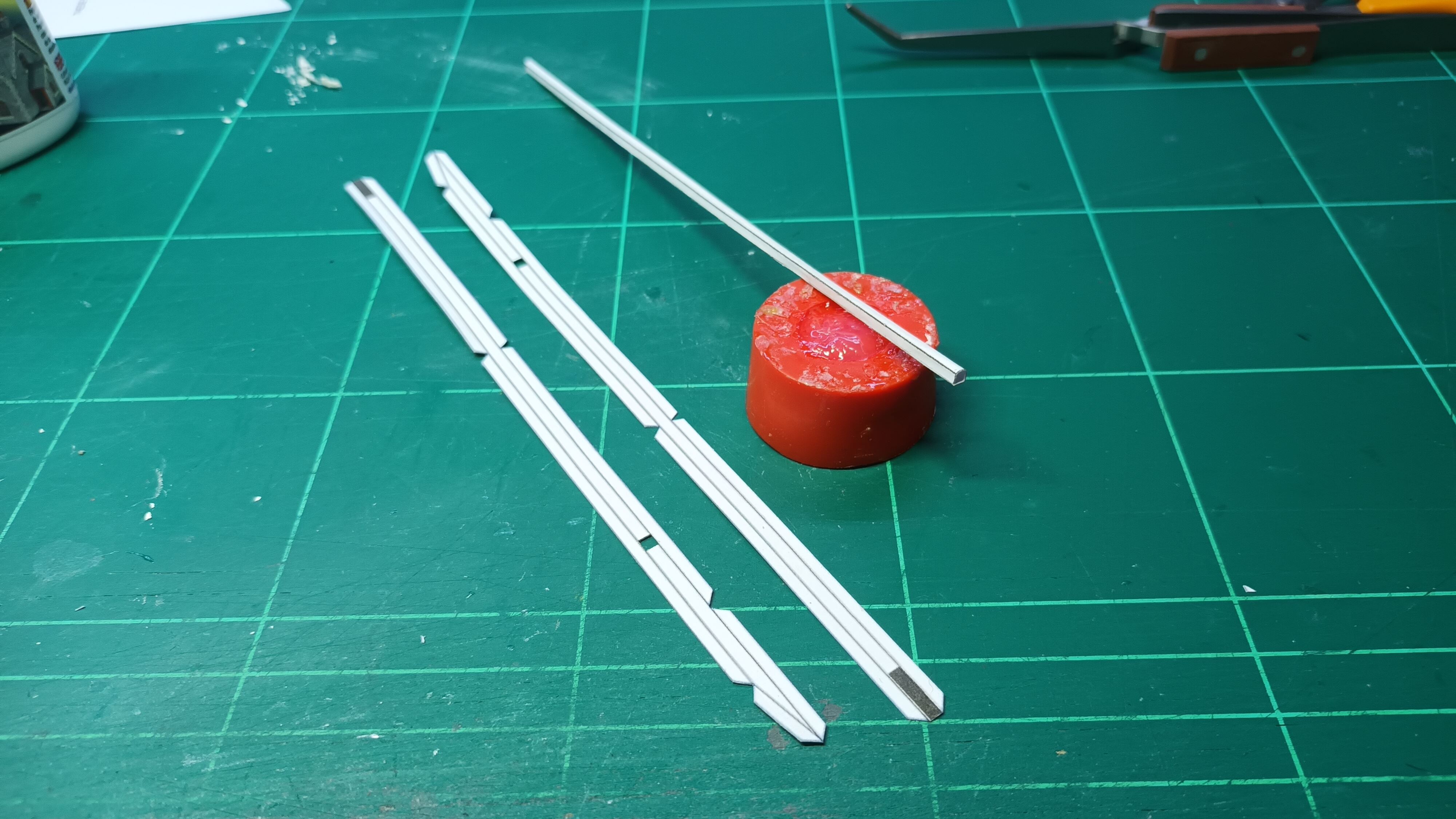

Spar constructed and fuselage side wing guides. Note square hole notched out.
Although the side guides matched the notches, I feel these have been labelled wrongly as left should be right & right should be left!
Once installed the black indicator should be at the front and the rear should have the sloping end trailing into the tail.

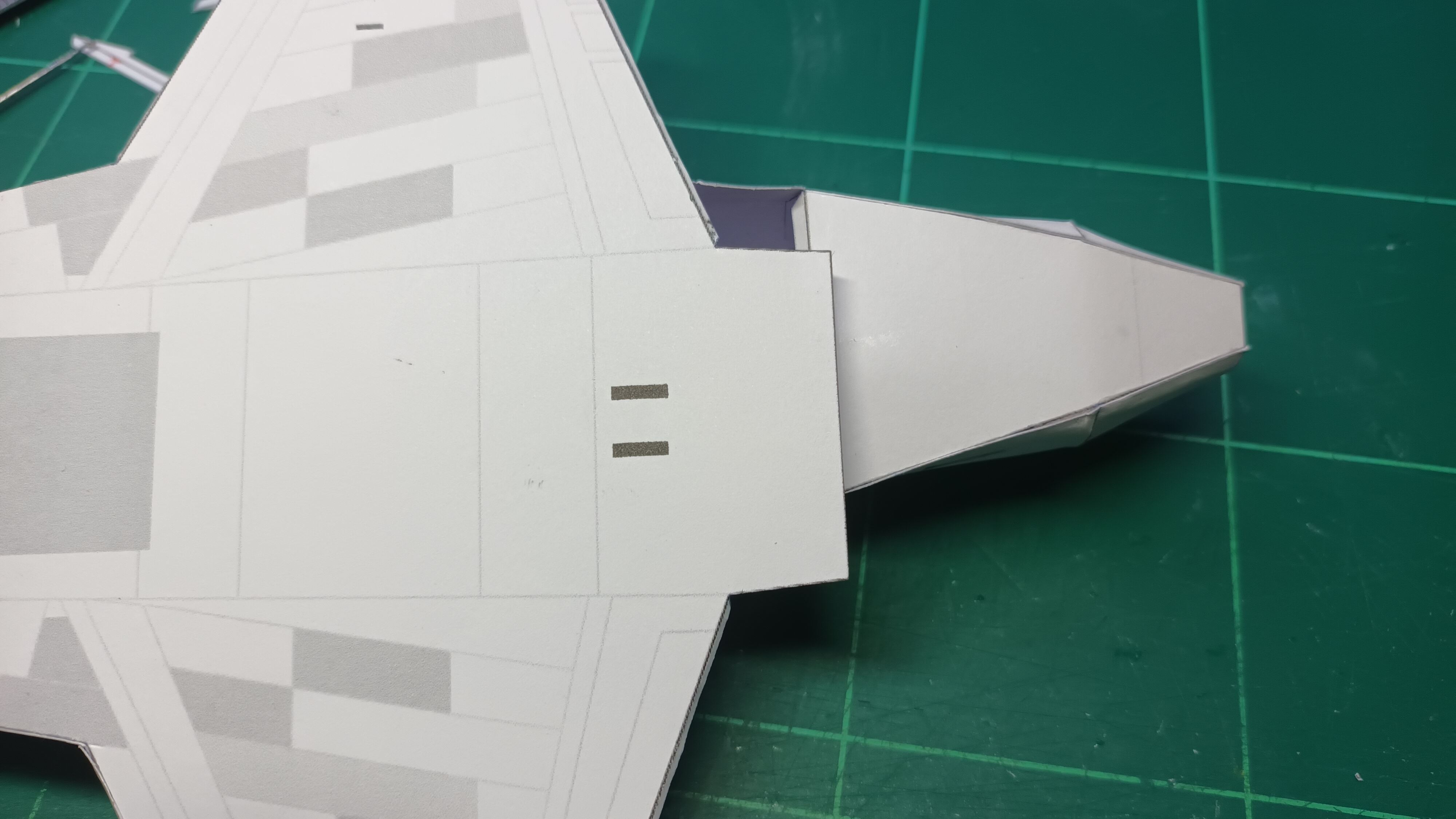

The belly is too long on the dry fit, but this is correct and will sit correctly once construction continues.
Note the angle which caters for the seemingly over long belly.
Installation of the spar, unfortunately it fouled the step in the wings, so I left it out.

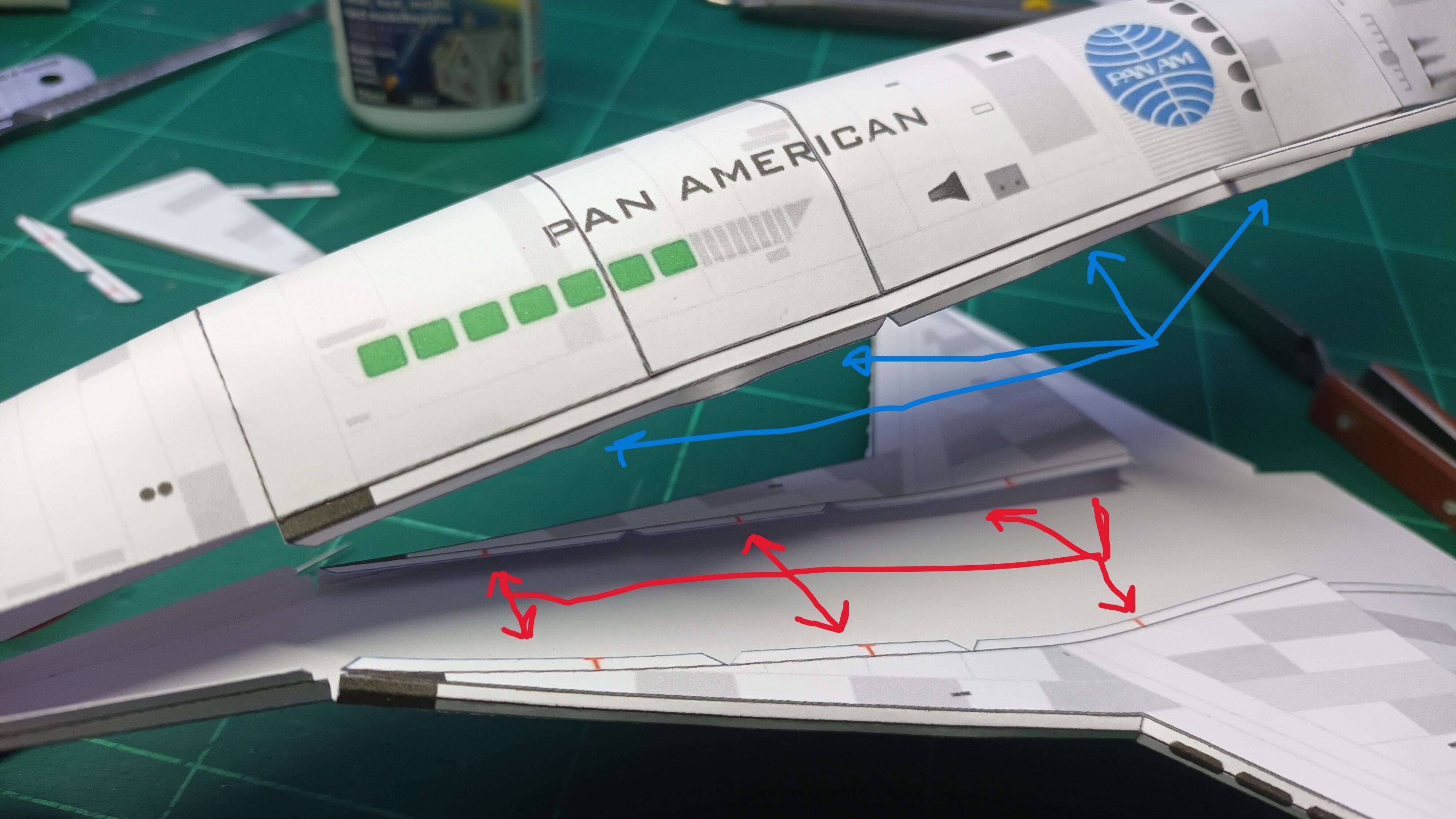

Hinged access

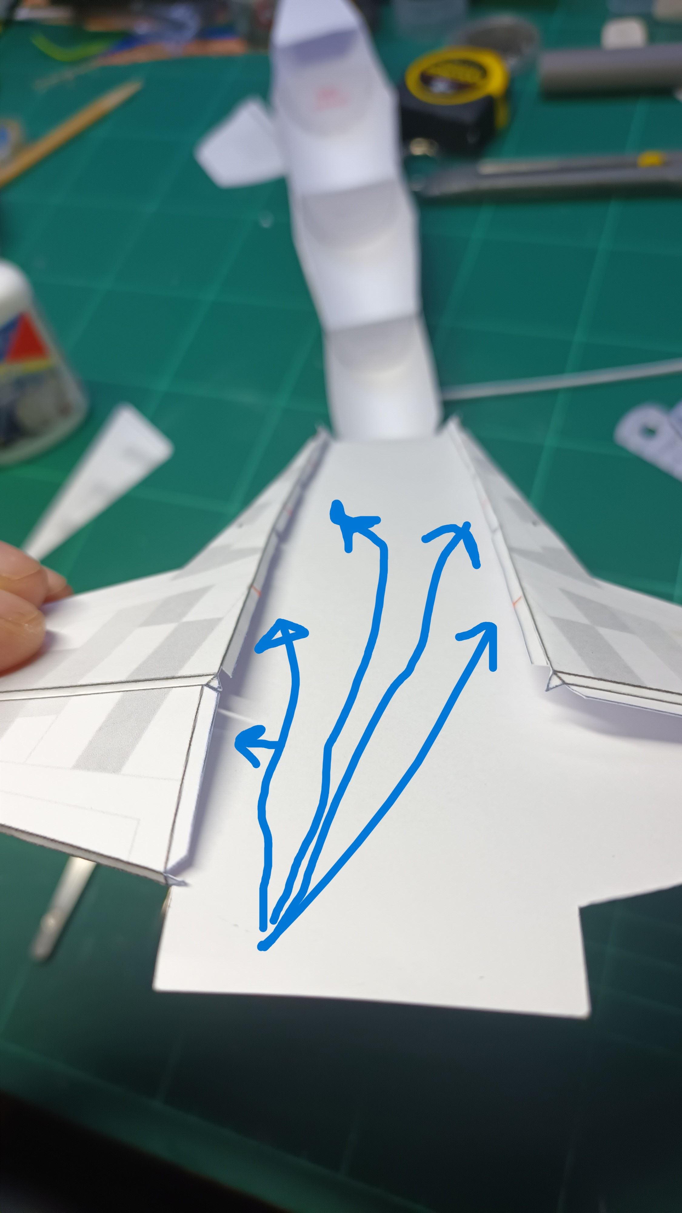

The blue arrows show these tabs to be folded inwards and will sit on the belly and the red tabs with the red 'T' on them should be bent downwards and not kept flat as per the inept instructions state.
Cursing and swearing about the flaps which the dry fit showed up, but slowly getting there!
The odd parts which were finally identified as fitting here.

Getting nowhere with the instructions and dry fitting becoming to complex to fathom, I attached the bottom hull to the nose cone tab.
Main belly dry fit.
View attachment 216368View attachment 216369View attachment 216370
Hinged access
