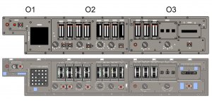

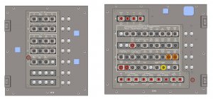

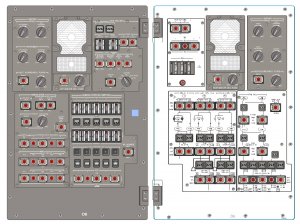

As promised here I am with my first completely redesigned panels. I decided to start with overhead panels O1 O2 and O3.
Above is the original Thorst 1:48 panel. Perfect for that scale but not enough detailed for my 1:16 cockpit. Below is my brand new panel. I started from scratch pasting a collage of NASA original schemes from the "Main Shuttle Crew Operations Manual" to act as a reference.
Drawing on it I recreated every single gauge, every screw, every writing that I was able to reproduce.
Another great reference was the complete 360° Endeavour cabin you can find at Gigapan website.

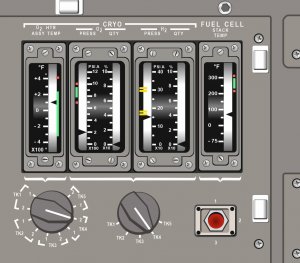

As you can see from a closer view I choose the hardest way to do this work...
(BTW, some of you may have noticed I put only black dots in the place where switch guards are to be placed instead of drawing them... :D)

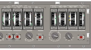

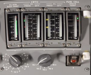

Let's go closer...
Compare with a real photo of the same spot.
OK I know the detail I'm putting in is too much for the dimension it will be printed and the great part of this work will be invisible once completed... But as this is fully vector file it will be scalable to any size you want so, if you want to realize a real size model of the cockpit - 1:1 - you'll be able to make it without any loss of detail.
Well, this is only the first piece of the digital work... much more to come... this will be a LONG way to walk... ;)
This is greebler pornography!! Incredible! Claphands
Reactions: Tonino
Actually the more detail you have in a vector, will show up better when you down size your print!! so as a perfectionist I say " Your getting there"!! ;)
Let me know when you get ready to cut out all your toggle guards...I have an idea for you!! :)

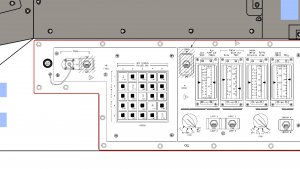

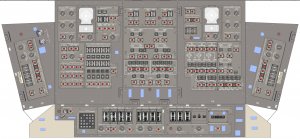

A little update.
Texture work is going on, slowly! As I feared this is a HUGE drawing work.
This is to show you how I'm working
I have reduced to scale the original NASA diagram and then I put all the objects on it. The various components have to be drawn only once, then I can copy and paste them repeatedly. This speeds up the whole process but it's equally a long work. Then I have to make all the writings and lines one by one. Finally I add the fill color to the panels, turn text and lines color to white and... that's it!

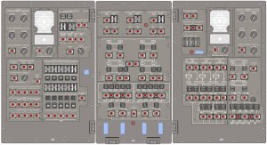

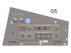

These are the completed panels so far...
And, finally, a complete view of all the overhead section as it appears once assembled
See you soon for the next update...

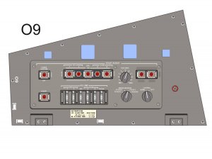

I've just finished drawing overhead panels.

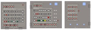

Here are the last ones, the aft section.
O13 and O14
O15, O16 and O17

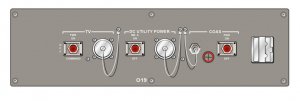

and, last but not least, the little O19.

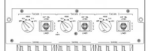

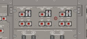

All NASA schemes I have show TACAN commands. I have substitued all of them with GPS commands that was in use in during late missions (like the STS134 I'm working on)
TACAN commands on O7 in NASA handbook scheme
The corresponding spot on Endeavour panel
And my panel...

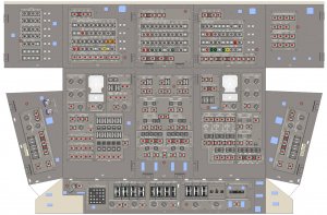

Finally a complete view of all overhead panels in their respective positions
