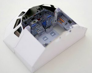

As I told you in a previous post I saw in a blog a photo depicting a shuttle cockpit paper model very detailed. Asked here and, thanks to @Nando, I found the original model files posted in Yahoo group Paper Space Models.
The cockpit, very nice and fully detailed, was designed by Thorsten Brand, a german cardmodeller, it's 1:48 scale and is part of a full Space Shuttle model that is going to be, I think, the best paper shuttle all around when completed. Unfortunately the project is in a Stand-By state at the moment.

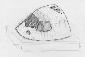

My idea is to start from this model section upscaling it as much as possible (considering I can print only on A4 paper) and realize a stand-alone display model of the whole Space Shuttle front-upper section with all the detail I can put in it.
This is a sketch, just to give you an idea.

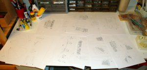

The first thing was to extract from pdf's all the vectorial information to paste them in Corel Draw and start rescaling and repositioning work. After some tries I concluded I was able, dividing the biggest pieces in 2 or 3 sub-components, to reach the huge 300% upscaling factor so my cockpit will be eventually 1:16 scale!!!! :D
The 2 pages from Thorst's original project now have reached the number of 20 (and I'm only at the beginning!!!).

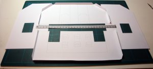

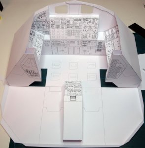

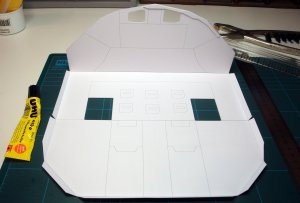

The floor is one of the BIG pieces I was forced to divide in sub-components. I added a second layer divided in longitudinal direction so I won't need tabs to join the halves and, in the same time, I'll strenghten the base of the cabin.
This is the full base, dimensions are pretty impressive...
And here are the first aft panels. Thorst made really a good work as the fitting is perfect.

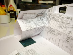

The aft side walls with those strange structures simulating part of the many recesses and ledges of the wall. With colors on them they will be somewhat better I think.

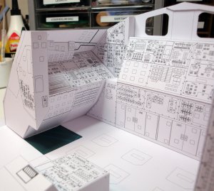

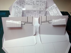

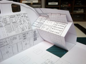

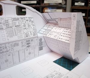

The walls and aft side consolles are in place. The fitting is always perfect so far.

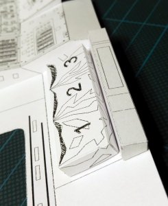

Those two elements, as you can see, was the first difficult piece to put on. The shape is pretty complex and perhaps the part can be unfolded in a different way. I should think a bit about this.
The weakest part is the join with the side consolles, especially in the lower section (see next photos)
On the right - especially - I made the worst join. I 'm sure it's my fault and not a design issue, but the next time, with the real thing... I should study something different for that spot.

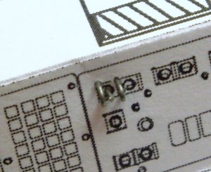

I'm sure that many of you know the Apollo Command module model by Ken West... with all those tiny switches...

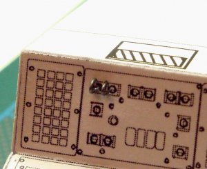

I was thinking about something of that stuff for my Shuttle so I made a little try:
I used a 0,3 mm wide metal wire to make two little loops and a micro-switch in the center. It was a hell of a work... I don't know if I'll have the force (Jedi style) to repeat this thing for the hundreds of times needed to cover all the panels... For the moment I'll just meditate on it... waiting inspiration...

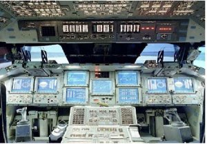

I'm still considering which mission to choose for my cockpit.
I think I'll decide for the STS134, with the Endeavour. That was one of the last missions (the second-last) and the last one to have an italian astronaut on board (Roberto Vittori). I've found several images taken inside the Endeavour during that mission so I think I can have enough documentation to help my build.
Roberto Vittori on the pilot seat aboard Endeavour during STS134.

You make me laugh because you are the demonstration that cardmodelers' brains work all the same way. I had exactly the same idea (exactly as you sketched it) but, when I printed my prototype, I realized that the switches are really too tiny to follow that way. I want to make some try with paper before surrender to the metal option... but I'm afraid it won't be possible. Anyway I'm amazed by how close our thoughts went along the same path...:)
I would recommend colored sheet plastic. Sheets of cellophane, or other similar products come in a myriad of colors. The are used as paper folder binders. :)

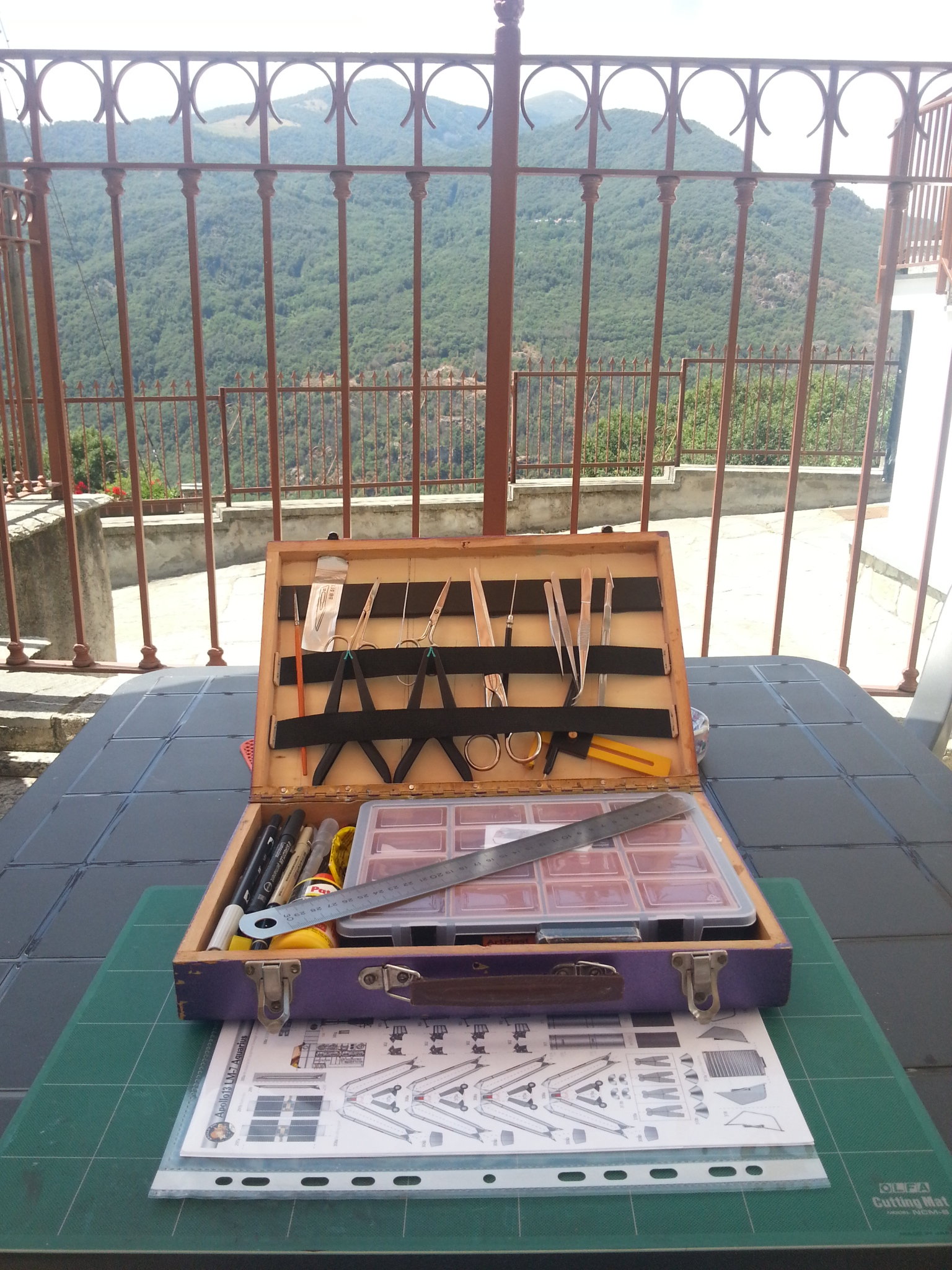

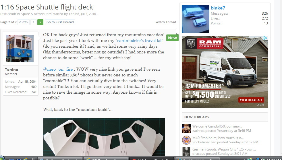

OK I'm back guys! Just returned from my mountains vacation! Just like past year I took with me my "cardmodeler's travel kit" (do you remember it?) and, as we had some very rainy days (big thunderstorms, better not go outside!) I had once more the chance to do some "work" ... for my wife's joy!

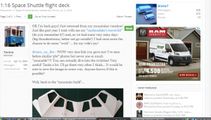

@nero_on_fire : WOW very nice link you gave me! I've seen before similar 360° photos but never one so much "zoomable"!!! You can actually dive into the switches! Very useful! Tanks a lot. I'll go there very often I think... It would be nice to save the image in some way. Anyone knows if this is possible?

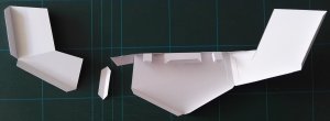

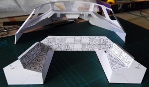

The front wall was divided (like other big pieces) in sub-components with "special" tabs realized to join them. This wall, as you'll see after, is a little too weak in this scale. Perhaps would be better to double it.

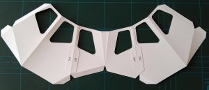

The upper console was divided in 3 slices in the same way.

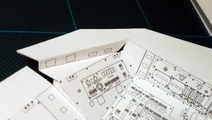

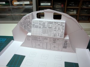

The 6 pieces are joined in one. The fitting is very good so far.

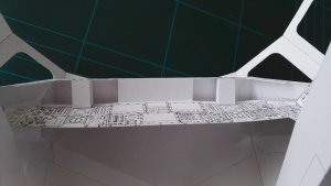

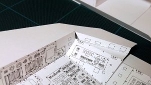

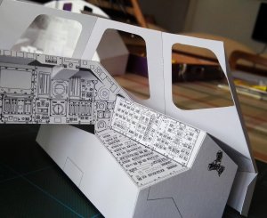

The dashboard is the most interesting spot (I LOVE dashboards... like many Flight Simulation enthusiast!) The two "TAB?" writings were soon disproved... there's no contact with the upper console there (as I thought).
After joining the parts I noticed that the HUD boxes are a little too big: they push back the dashboard. Another point to enhance is the lower side of the console, I'll have to detail it adding the underside and the lights.

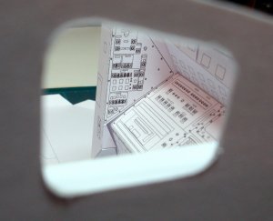

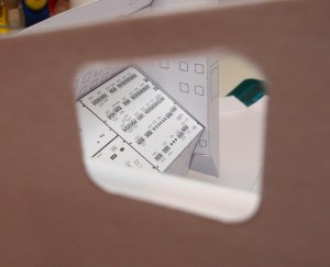

Here you see why the tabs in that spot would have been useless... In the front lower part is an opening that I will have to close somehow.
And the same on the other side.

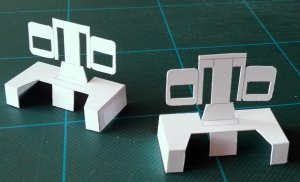

The pedals: their basic shape is good for a 1/48 model but I'll have to think to something a little bit more complex.

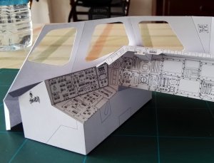

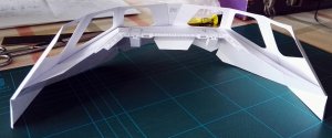

The ceiling is a really complex piece, but a great attention-catcher in this model. I'll have to do some work here also.
Here I found the first real fit issue. The upper-lateral right wall will need some adjustment.
And so will the left side
Those pouches will have to be less "square"

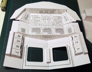

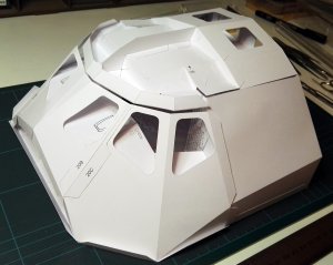

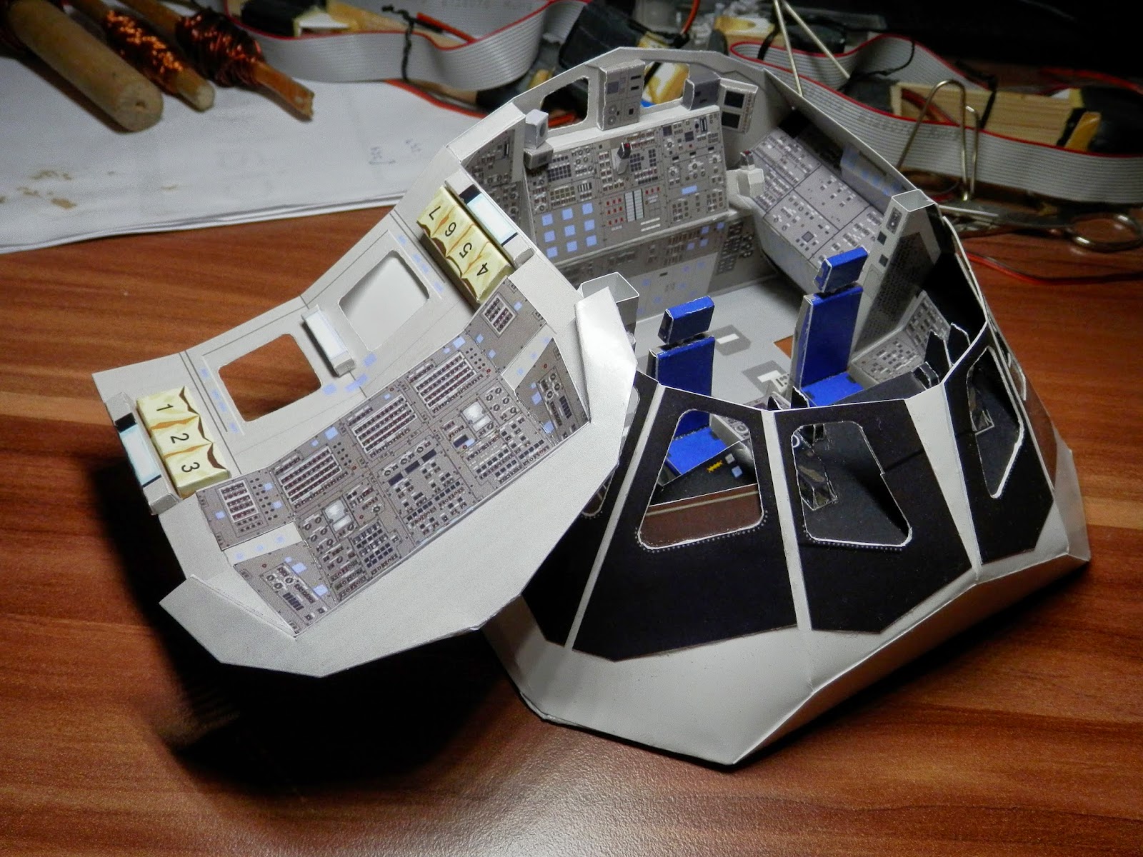

This is the appearance of the whole thing in its present state. I didn't glue the front section (it's only placed in position) as I'll have to take some measures and I need to reach the inner details easily.
This is the reason for I talked about reinforcing the front wall (previous post). During the transportation the ceiling section pushed on the windows distorting the frames, as you see here. The transparent pieces will add some rigidity but I think that a double layer of cardboard is needed here.

Thanks Blake, but I've found something even better, I think...
Looking to the code of the page linked by Nero I've found the place that panorama came from and, searching around, I've found two wonderful more views of the Endeavour - that's the one I'm going to represent:
by day
and by night that is great to study the lighting effects...
you can zoom until you have a single screw filling the whole screen... fantastic!!!!
Do you think I'm jocking?
See:
Moreover, seen in their original website, the images are much more usable (the flash applet embedded in NG site was not very practical: turning mouse wheel to zoom in and out makes the page scroll while zooming) and here you can put image in fullscreen, very nice! :D
