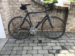

My recumbent Trike has a wall thickness of .050" but it's 2" inches on the O.D.. The larger O.D. gives the strength. I knew a guy who made world class hand made racing bicycles out of Chrome Moly tubing is they are only .010" of an inch thick!! Frank Strnad was his name. His passed Set. 2019, an true gentleman. I truly could not say enough good things about him. He was selling his miller Econotig Tig Welder for $1000 bucks, but when he found out I wanted it, he gave it to me for $300 bucks, with wand and foot pedal!! I was shocked. He wanted me to have it. It is so new, he built only 60 bicycle frames one i but needed something that could go lower than .015" of inch thinner. Every bike he made was measured to the person buying it, and made to order. People came from all over the world. His bikes et a pretty penny but you never see them for sale. Of the 2 pics below, the blue one is the last bike he made, and the Carbon Fiber one is one of his also. He used the finest components and laced all his rims. All frames, as I wrote earlier, were built to spec, and you had to come in to be measured on a jig he built.:)

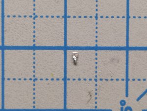

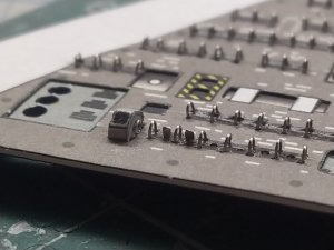

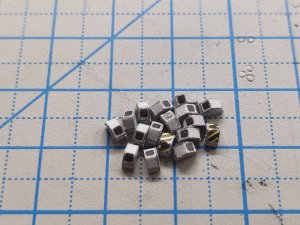

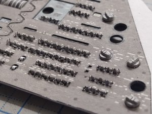

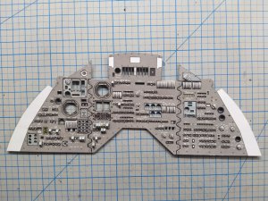

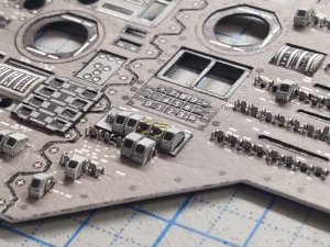

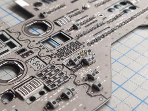

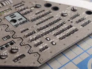

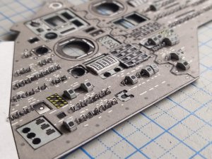

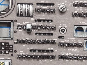

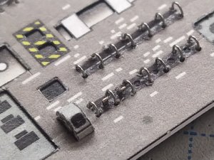

Woe this is looking fantastic. Smart move to solder the wires. :Drinks:
In this case, I glue the back side with glue so that the wire does not fall inward, since I had to make 0.45 mm holes, due to the fact that it is very difficult to get into the 0.3 mm hole fitted to the diameter of the wire during weaving.
