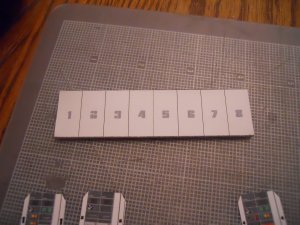

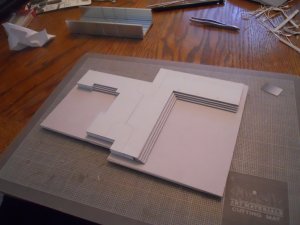

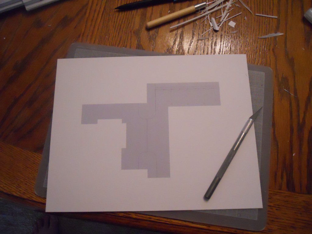

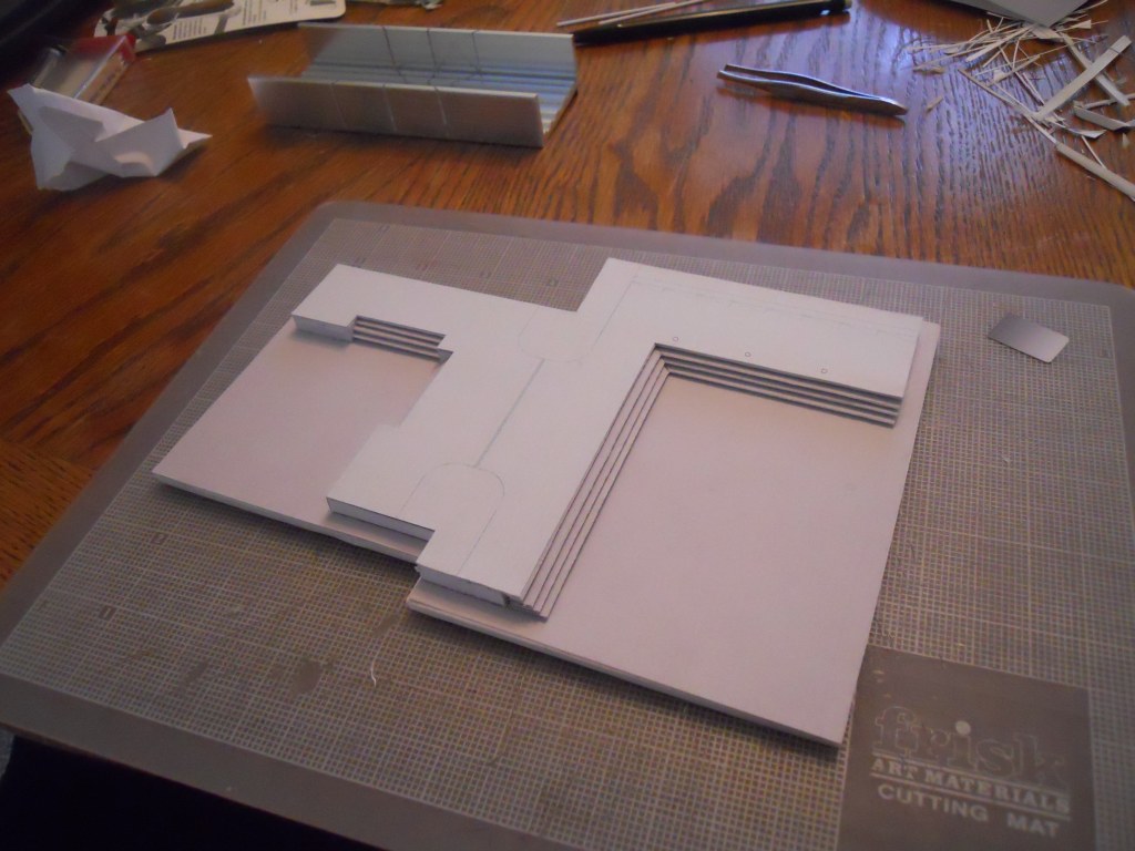

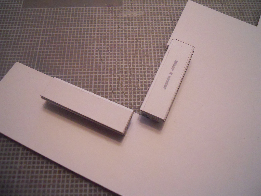

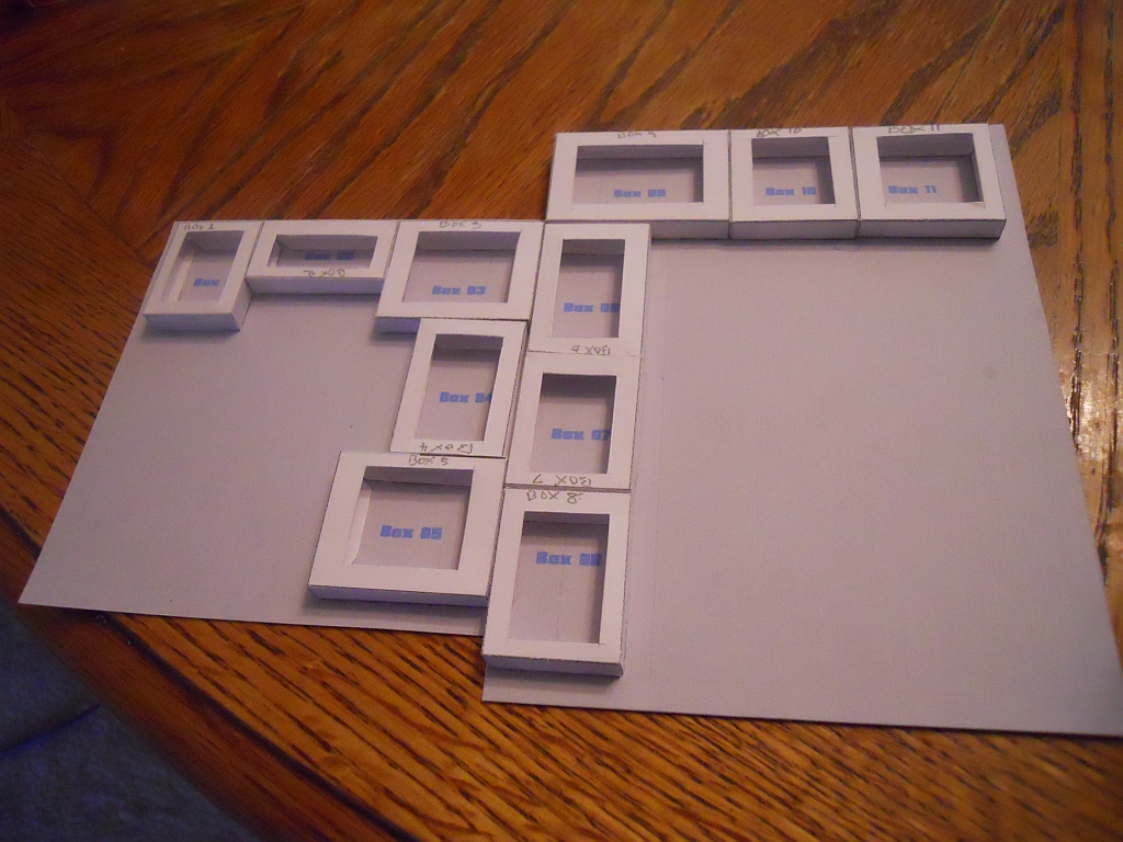

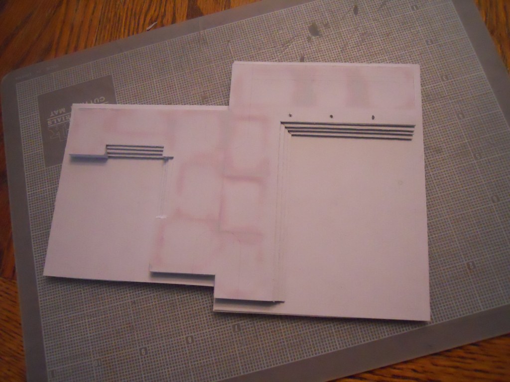

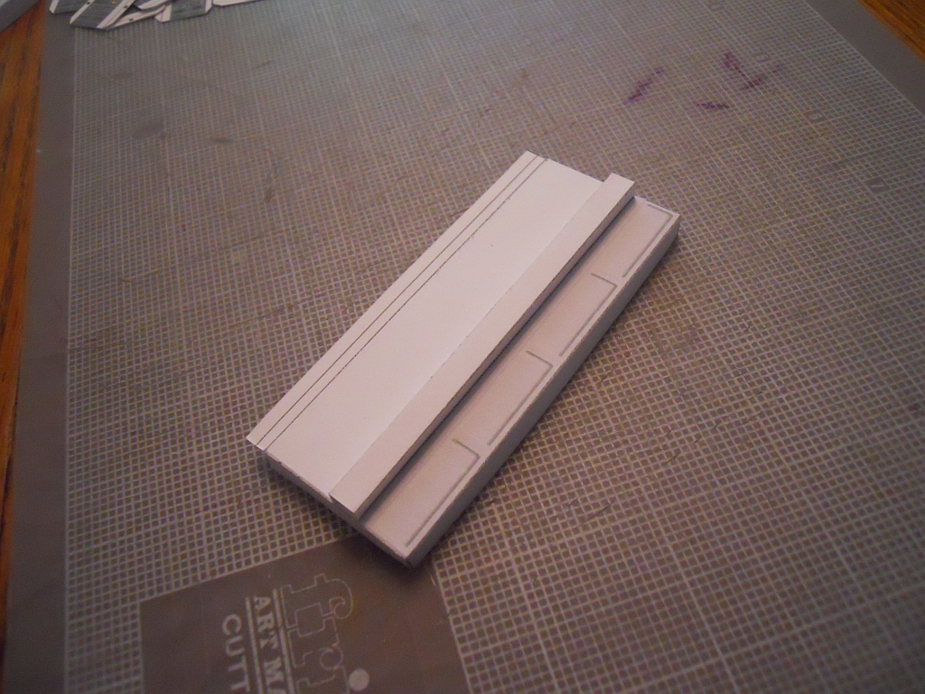

I've completed the lower floor supports and the stairs. Have to wait for the stairs to dry thoroughly, then I will trim the edges so everything fits. DSCN0334.jpg
When all is glued and done; the edges of the upper floor should fit perfectly over the box supports. Then it's on to the walls. I've redesigned them so they will be easier to position and glue down.

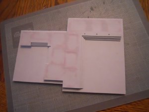

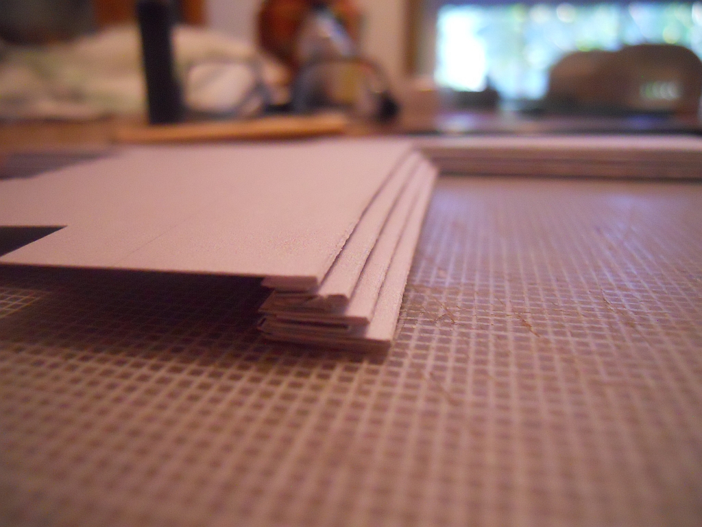

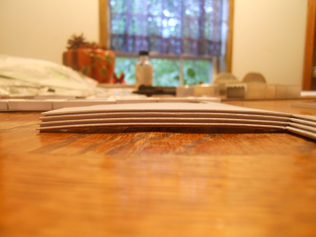

YET ANOTHER SNAG!!!

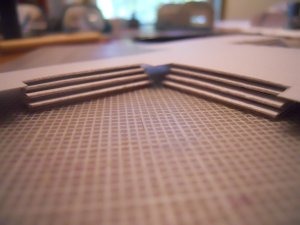

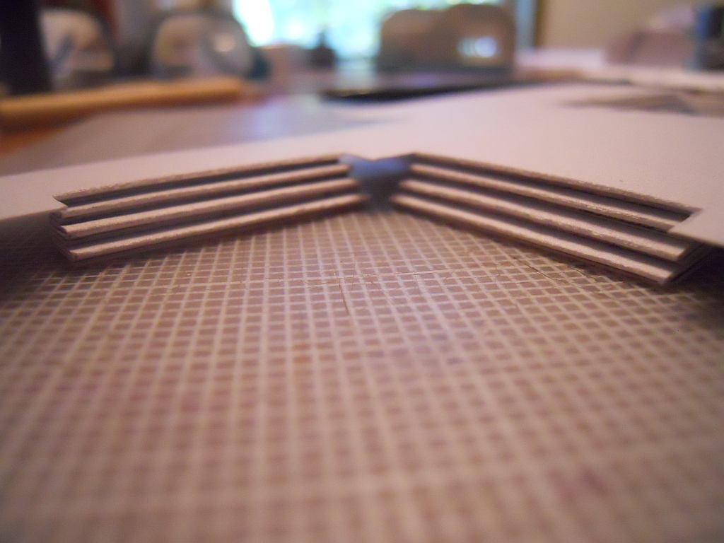

The upside to installing the stairs one tier at a time is that they line up wonderfully...

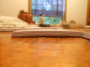

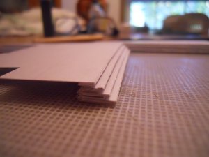

The downside is that; because the stairs are composed of several layers of cardstock... THEY BOW! If I try to glue them down to the main floor, it will just wind up bowing with the stairs...
Solution?

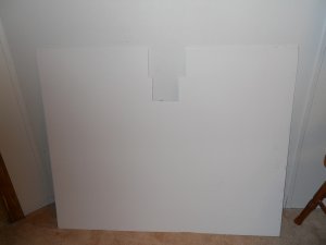

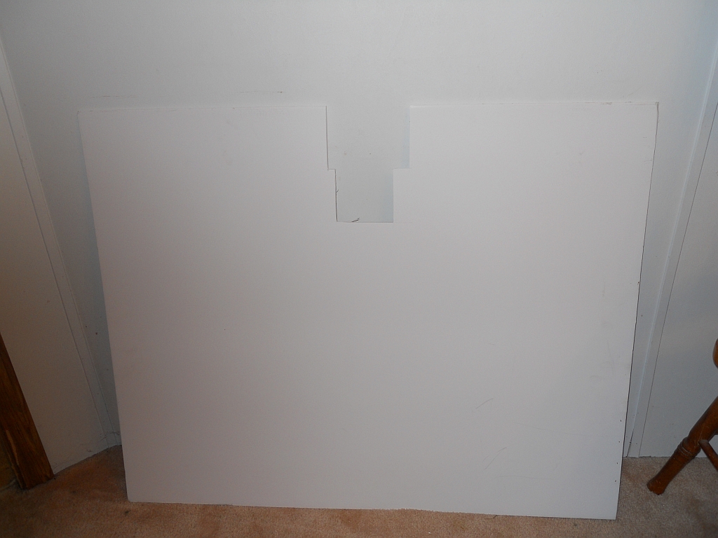

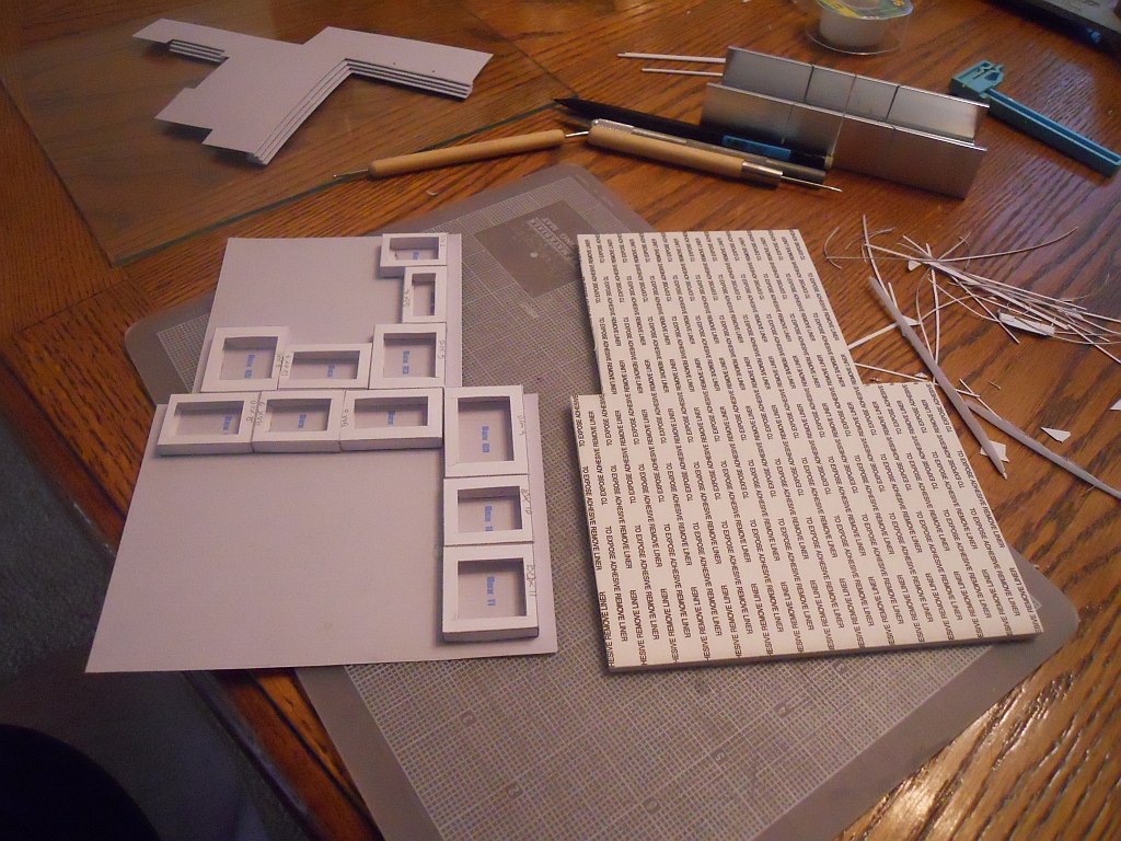

FOAMCORE!
Adhesive backed foamcore with a nice bite out of it!
Mount the main floor to the foamcore and the stairs will have to relent and conform.

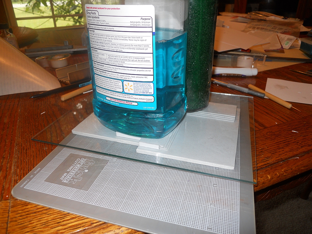

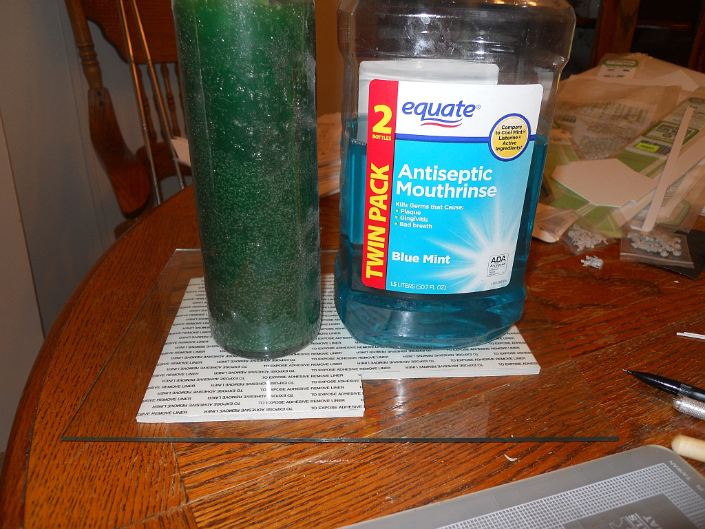

Mind-bogglingly...the foamcore was also bowed and needed to be flattened out a bit.

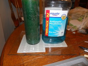

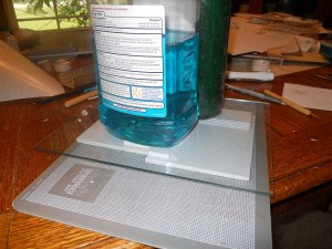

Sufficiently flattened; the main floor is adhered to the foamcore, the upper floor is glued to the main floor (after trimming the stairs a bit, everything lined up perfectly) and the whole paper model sandwich gets pressed under glass so it all dries as flat as possible.
If this all works it should look really good.
Fingers crossed!
AAAAAAAARRRRRRRRRRRGGGGGGGGGG!!!!!

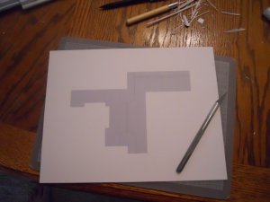

Okay, so... one of the drawbacks to using weight to glue something down is that it can cause the glue to bleed through your cardstock...
Solution: Glue another layer on top of everything and count yourself lucky.
No, it won't be perfect anymore but it is only a study model and it doesn't take that much away.
Anyway, The floor is done once again and it actually does look a lot better than the first attempt. I think I'm going to glue an extra layer of cardstock on the outside margins where the walls get glued to the floor, just to make certain everything winds up fitting where it needs to.
*sigh*
It's still worth doing but dues on this one are high. :headbange:

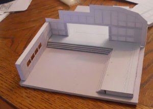

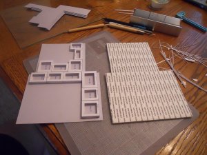

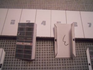

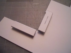

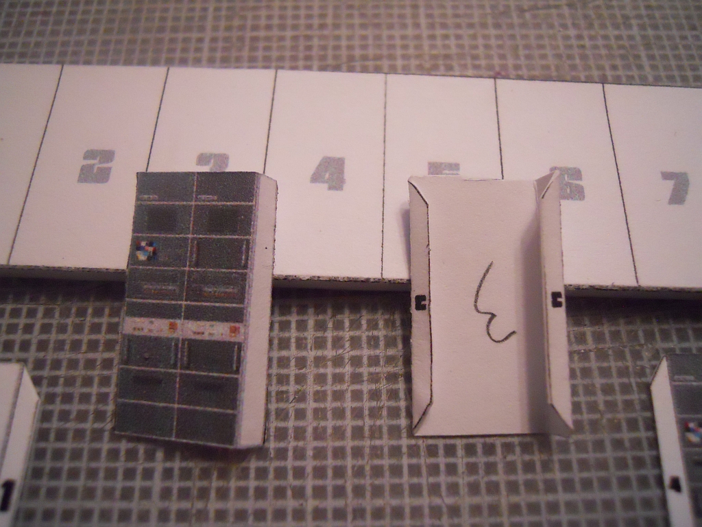

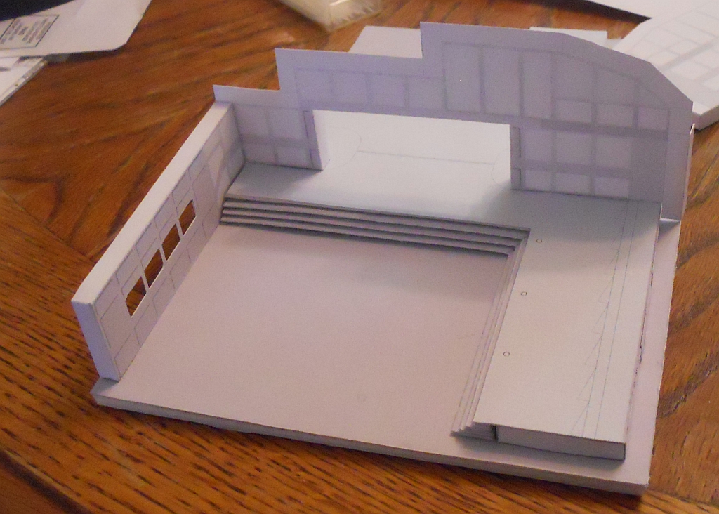

This is taking longer than it did last time but the results are much better. Here's some more progress pics;

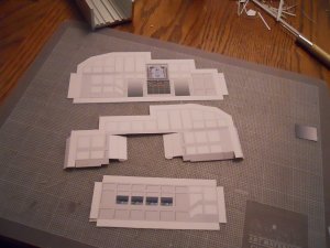

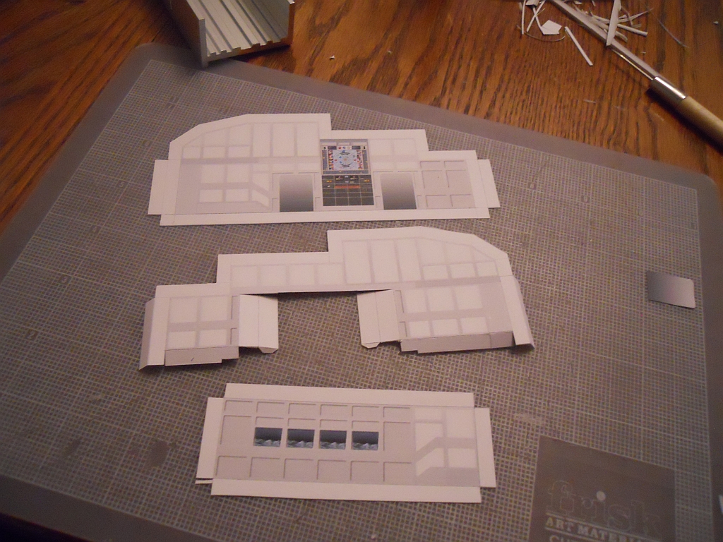

The walls of the main room cut out and scored...

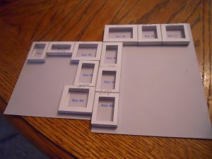

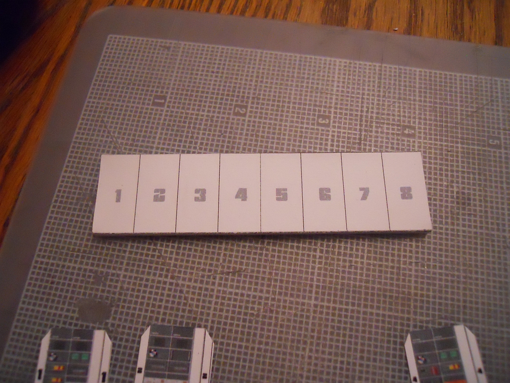

The redesigned computer wall assembled and ready for the consoles.
This is actually much simpler than my first design. The consoles get glued in between the lines of the wall so they will all be evenly spaced and hold their shape better.

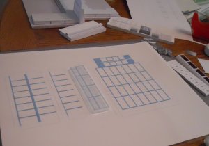

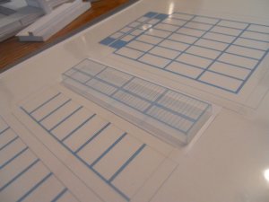

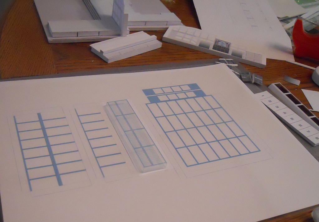

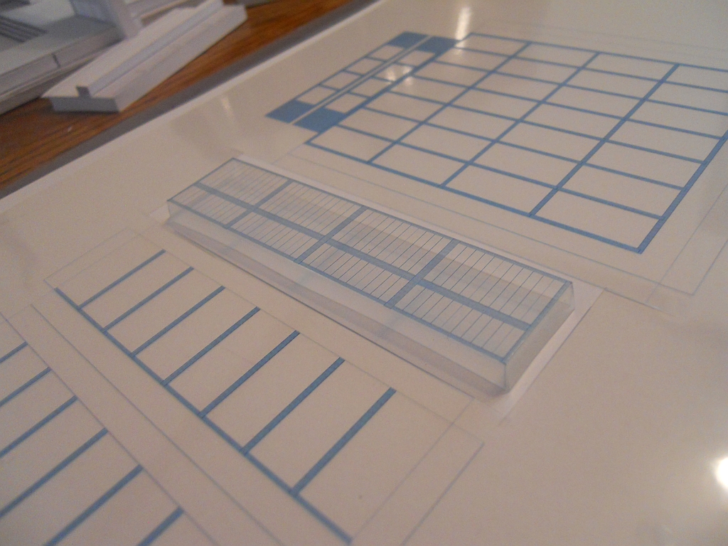

It occured to me that if I redid the ceiling panels as transparencies, I would save myself a lot of cutting, have a more structurally sound part and be able to see the model better.
Close up of the air conditioning panel that will go above the view ports on the balcony.
I installed the wall that is the least repossitionable first and then glued the "window" wall to it and not the floor... The window wall will get glued down when the other walls go up so I can make certain it's where it needs to be.

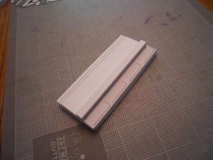

This is the back wall for the balcony which gets installed behind the computer wall. Note the ledge I added to help support the balcony.
That's it for the moment but I'll keep working and posting photos.
