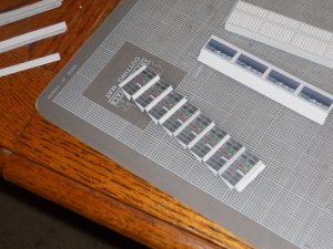

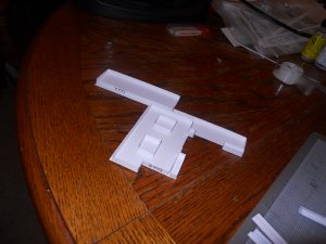

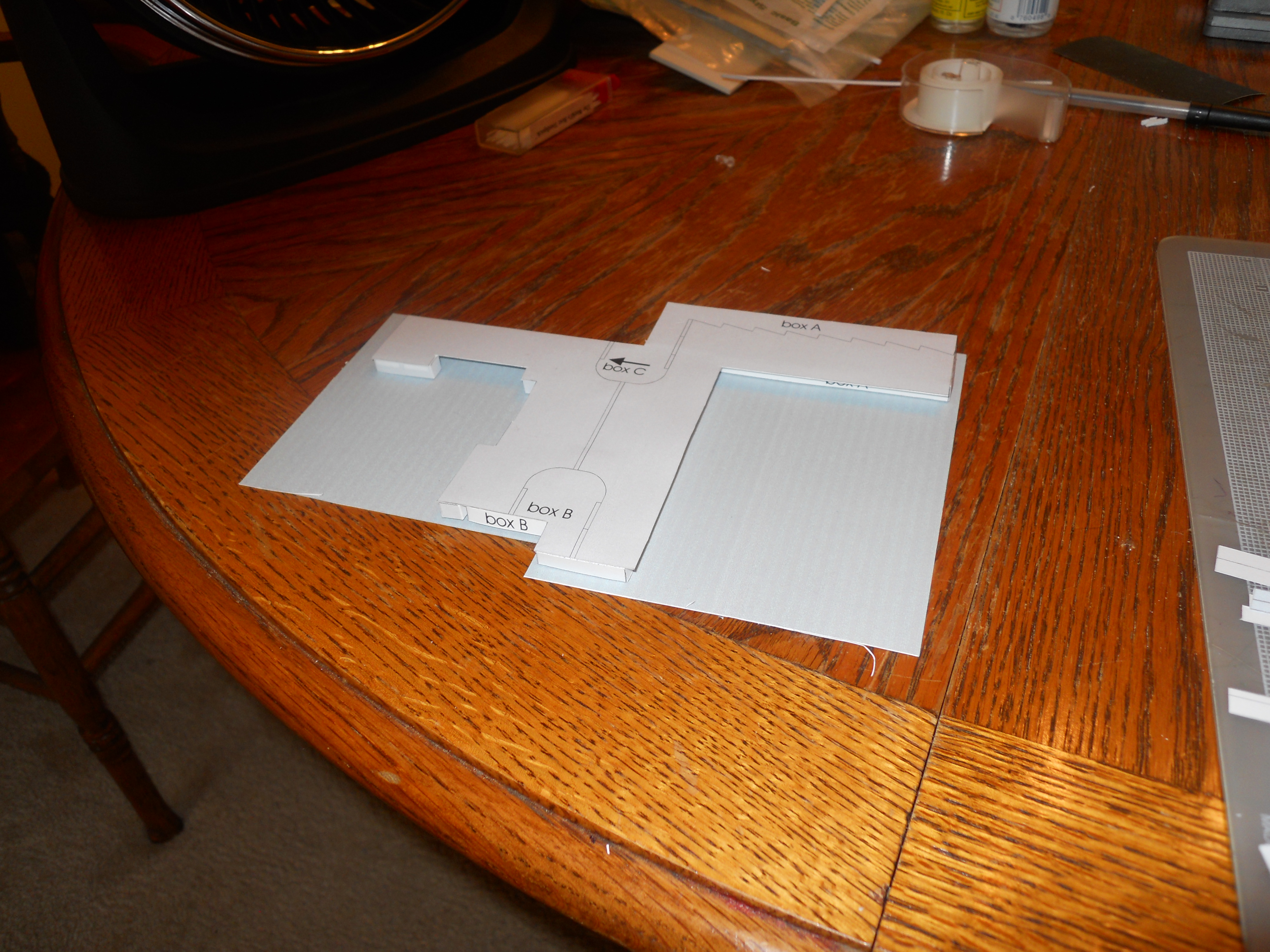

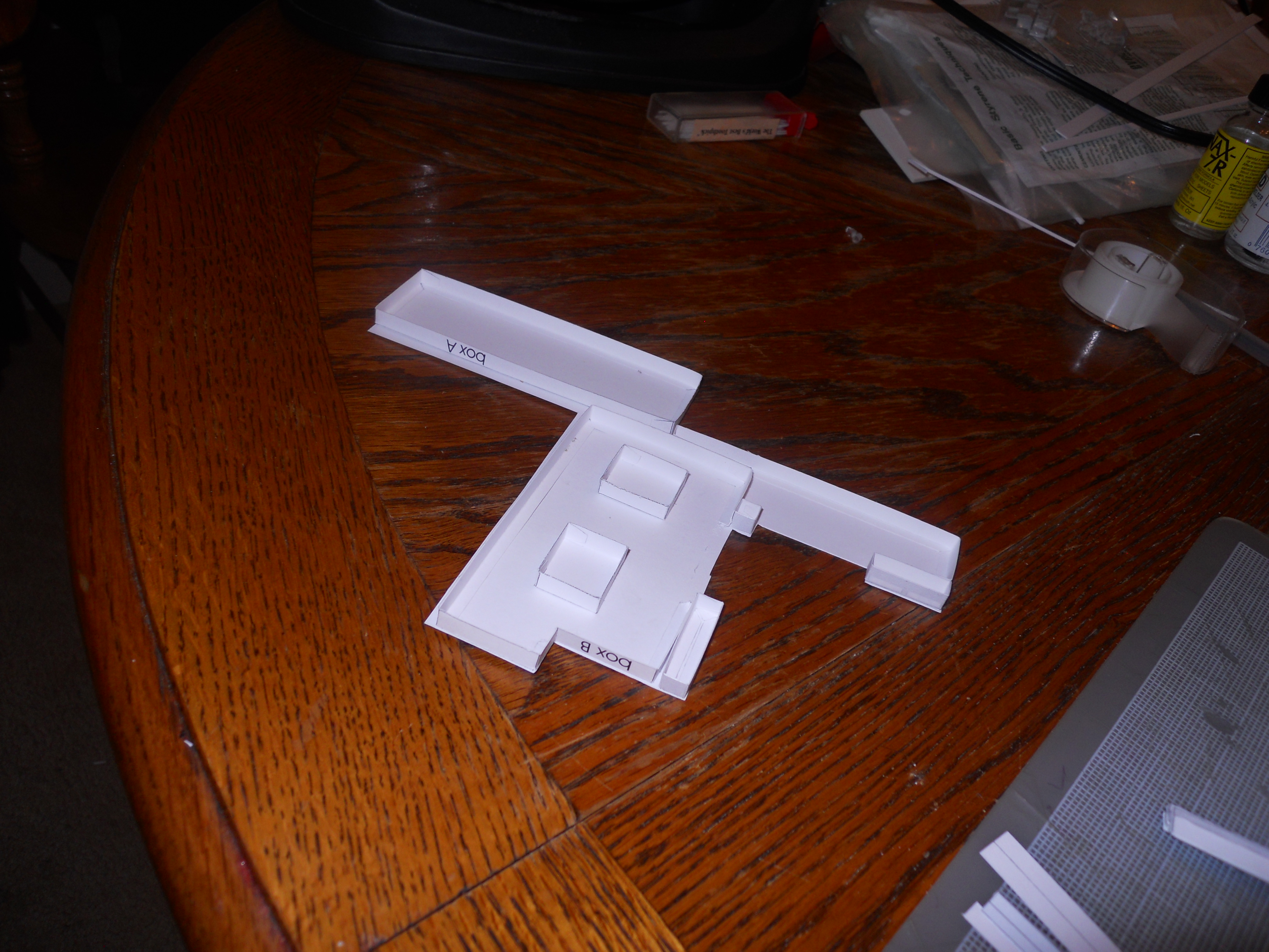

Thought you might be interested in this study model I’m making for a scratch built, plastic diorama of Main Mission from “Space 1999.” Round 2/MPC recently rereleased the “Space 1999” kits including the Moonbase Alfa diorama. I wanted to light the "Main Mission" diorama included with the base itself and it became clear pretty quickly that scratch building something in the same scale would be much easier than trying to modify the kit pieces. About the only thing worth keeping from it are the tiny figures which turned out to be around 1/107th scale (okay, whatever!) so that's the baseline for the build.
The first thing I did was look for available accurate blueprints… Guess what? THERE AREN’T ANY!!!

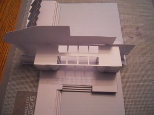

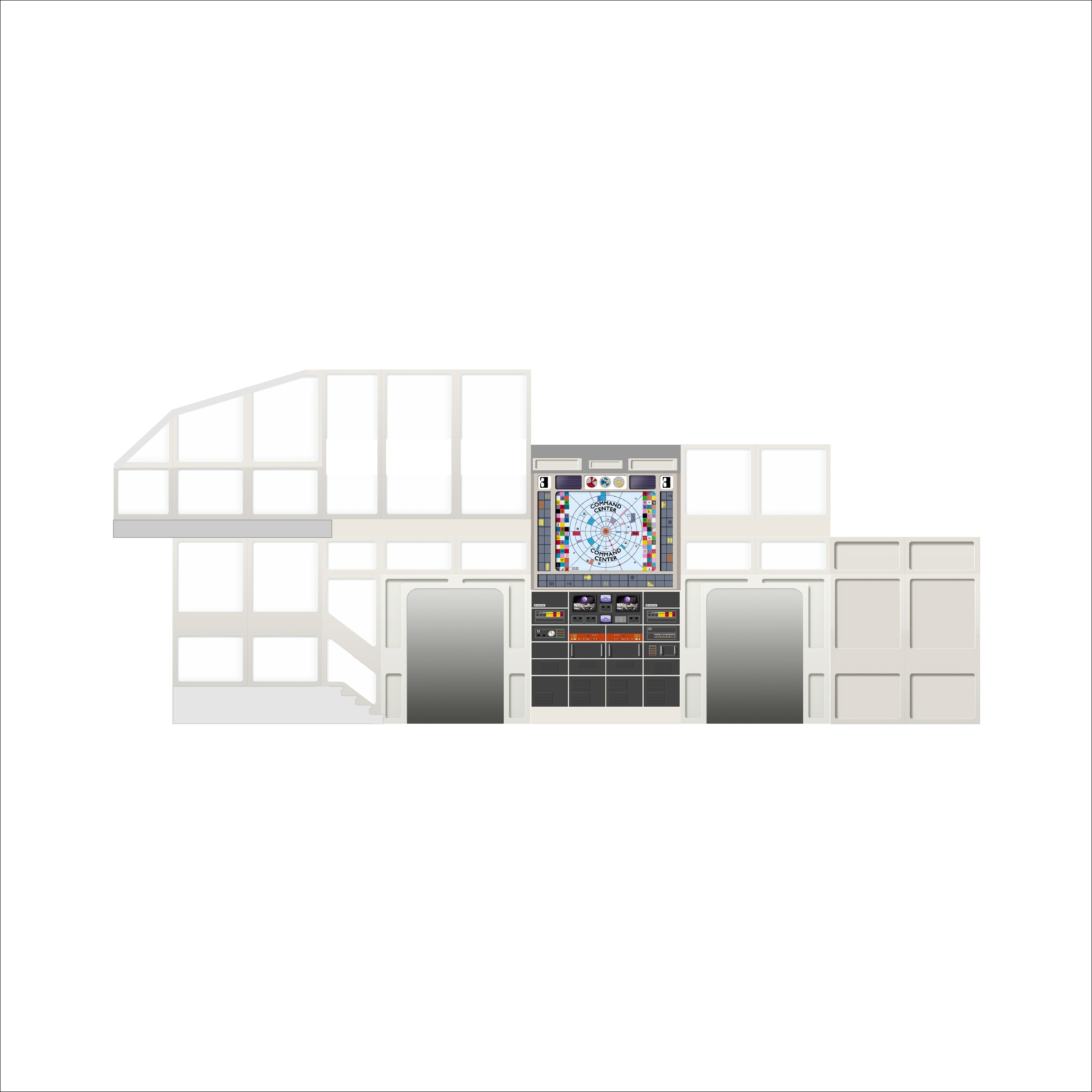

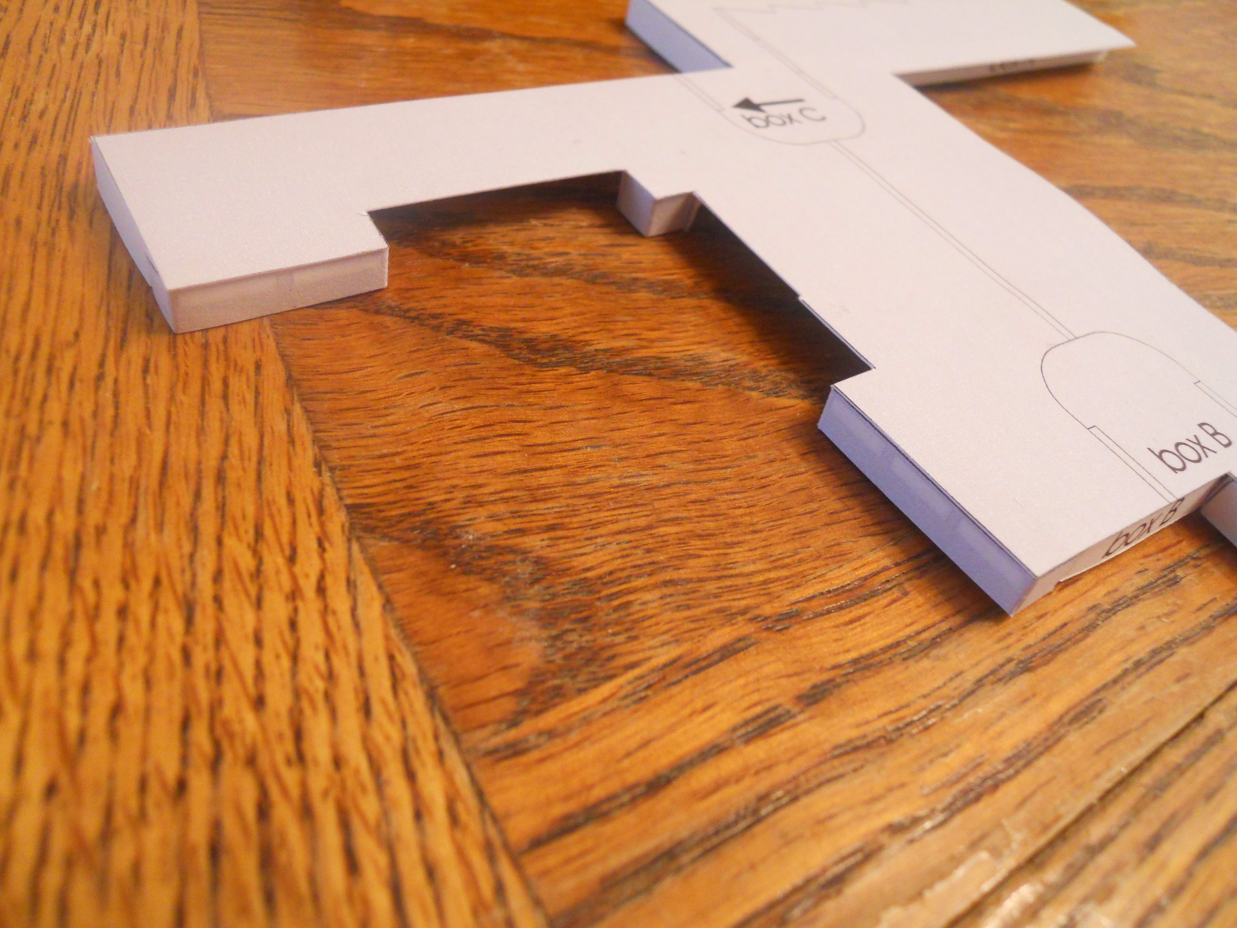

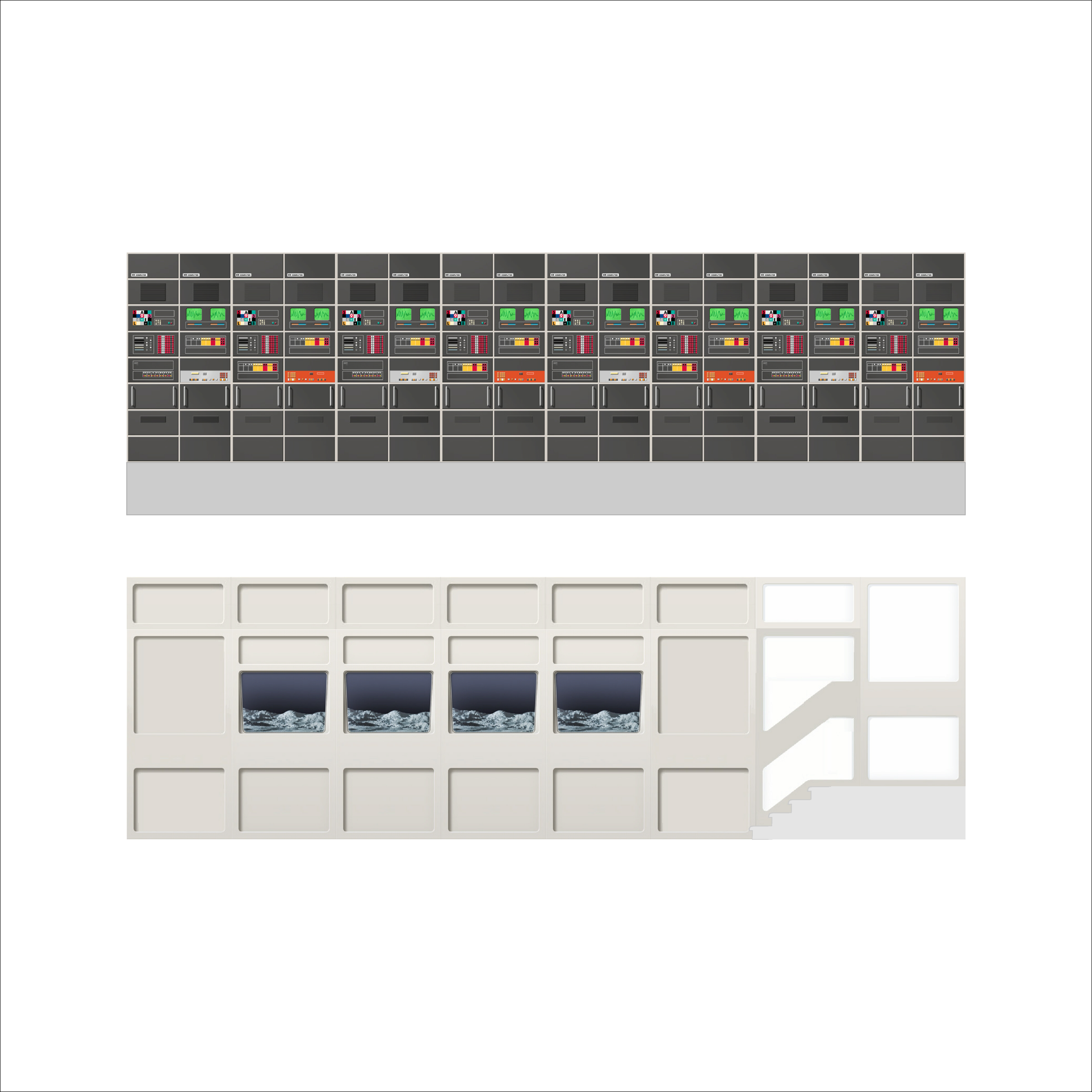

So I went back through my archives and found a bunch of CG panel art from 15 to 20 years ago and using some set dimensions I found online; I made templates. These templates were all in scale so I could print them out and start gluing plastic strip over them, which I will then glue over frosted, clear plastic sheet but I noticed as I was working that I needed to decide how the parts would fit together, how the ceiling components would be removable for viewing and so forth. The templates were all in color because I was using someone else artwork and it occurred to me that all I would have to do is add some tabs and folding boxes in Corel Draw and I could put together a dandy study model for figuring everything out in 3D! The following offering is the assembly of that model.
This is just a study model, so it isn't perfect but I'm pleased with the results so far and it's already helping me figure out how to design the scratch build I'm doing

This study model is paper? Looks like quite a fine project. Will you be using PVC?
Reactions: Octoman
Yes, the study model is cardstock. The artwork isn't mine (if it were, it wouldn't be so elaborate because it's for a scratch build), I just adapted it to make templates but they look so good that the study model looks much more like a paper kit. The actual model I'll be building will be mixed media. I'm using evergreen styrene plastic strip to create the panels which I will then paint and glue over some frosted plastic (I believe that is PVC as it's used to make stencils) for the lighted areas. It's in a very tiny scale...smaller than HO so it won't be that much bigger than the diorama that comes with the R2/MPC kit but the detail will be much better. I have to say, I'm having so much fun with the study model that I'm considering redoing the artwork, re-engineering it and doing a more elaborate, larger scale card model. I was thinking 1/48 or 1/35 scale. The latter would be quite large (over a foot long if I'm not mistaken) but it might be worth it. I could even add some options for lighting it.

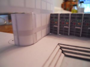

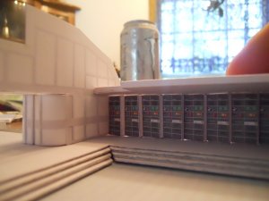

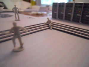

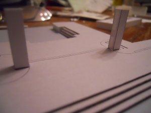

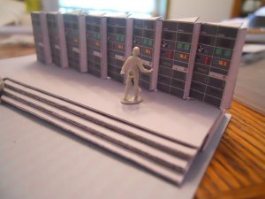

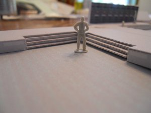

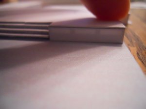

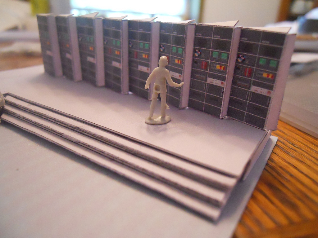

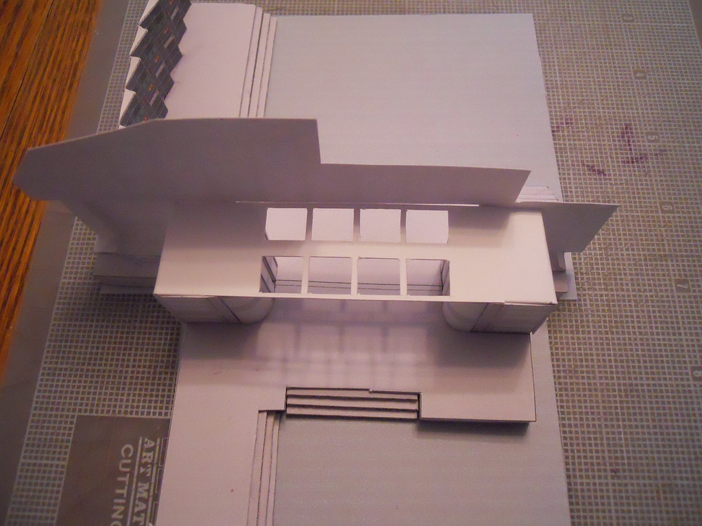

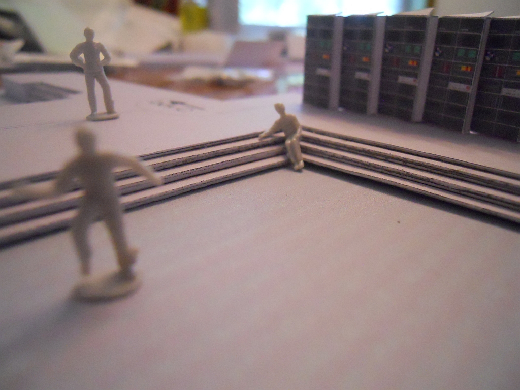

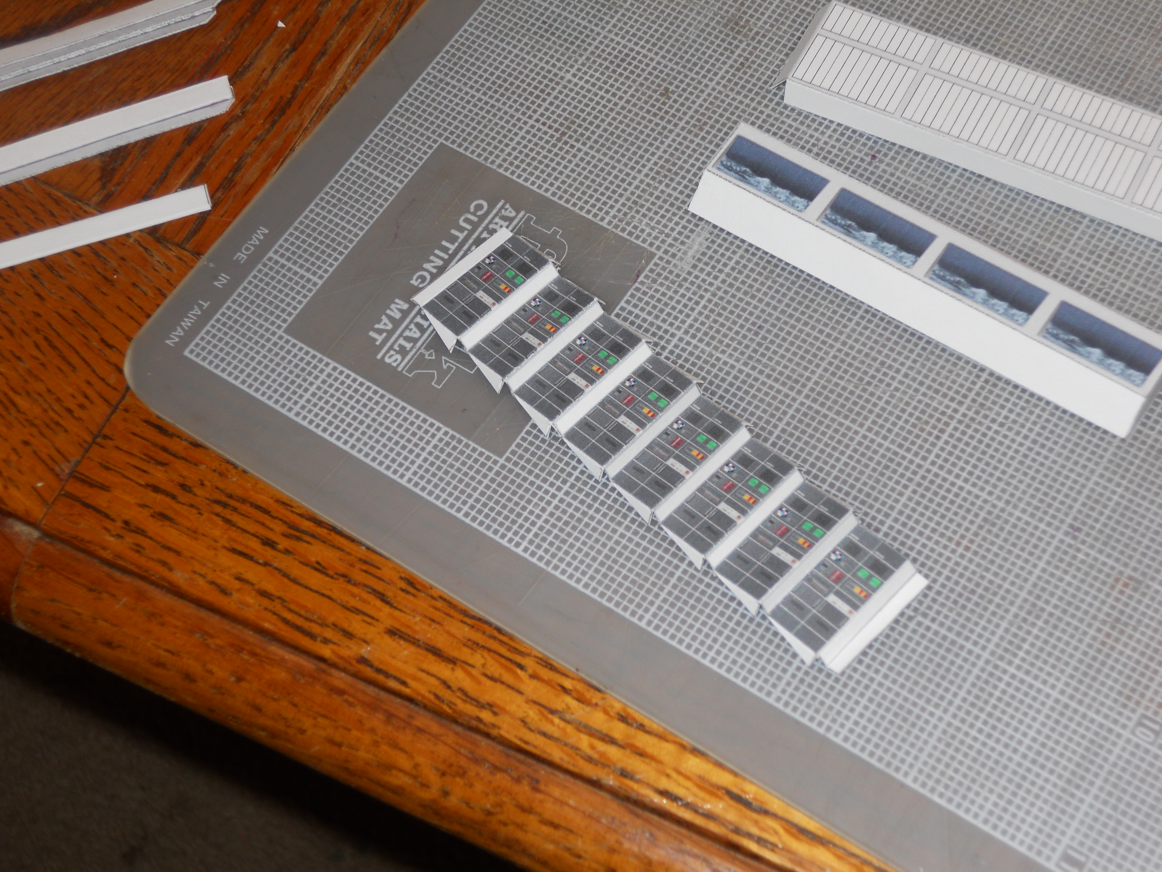

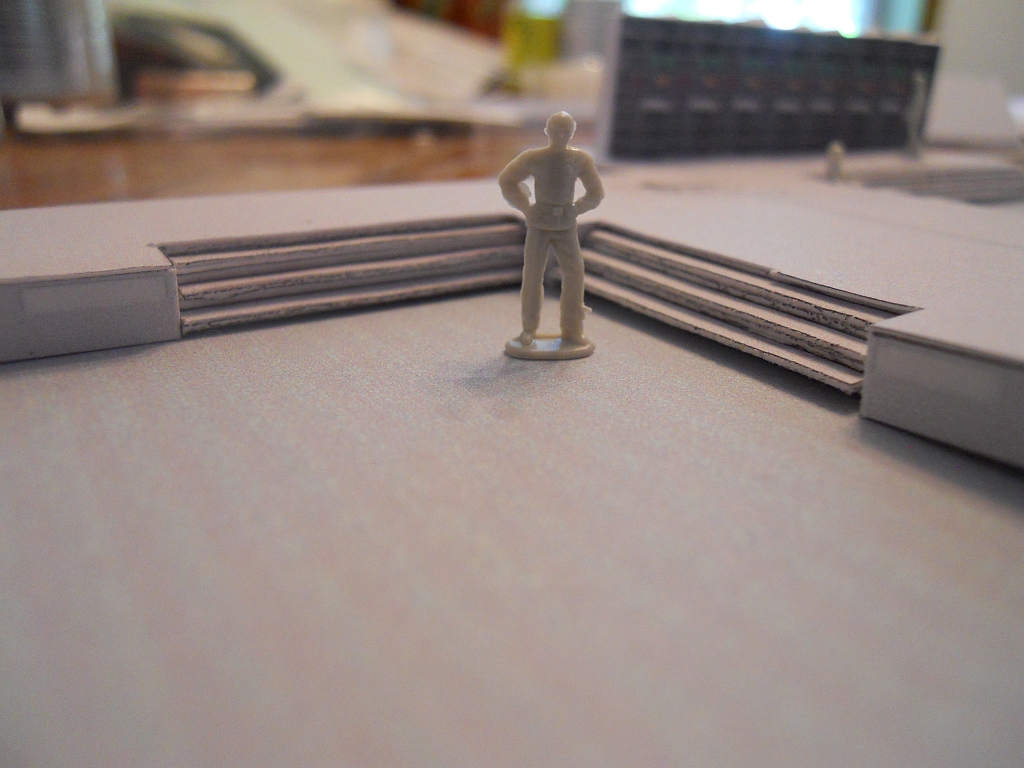

All of the stairs are in place as well as the computer wall under the mezzanine. This model is already helping me figure out what NOT to do on the plastic version. I put together full stair cases before gluing them to the base and they did not match up at the 45 degree angle. Solution: install them one tier at a time on both sides. The figures in the photos are from the R2/MPC kit.

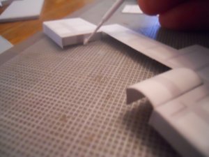

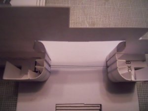

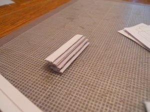

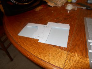

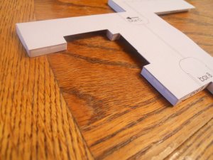

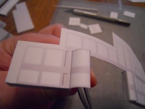

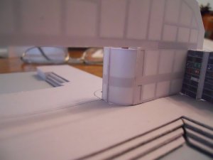

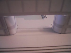

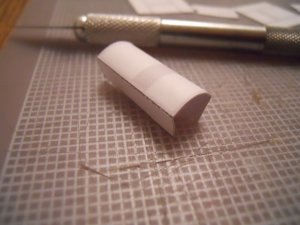

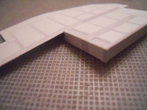

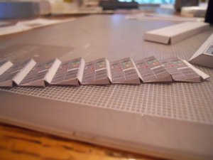

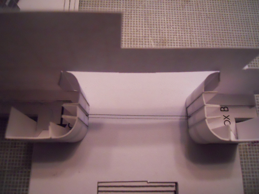

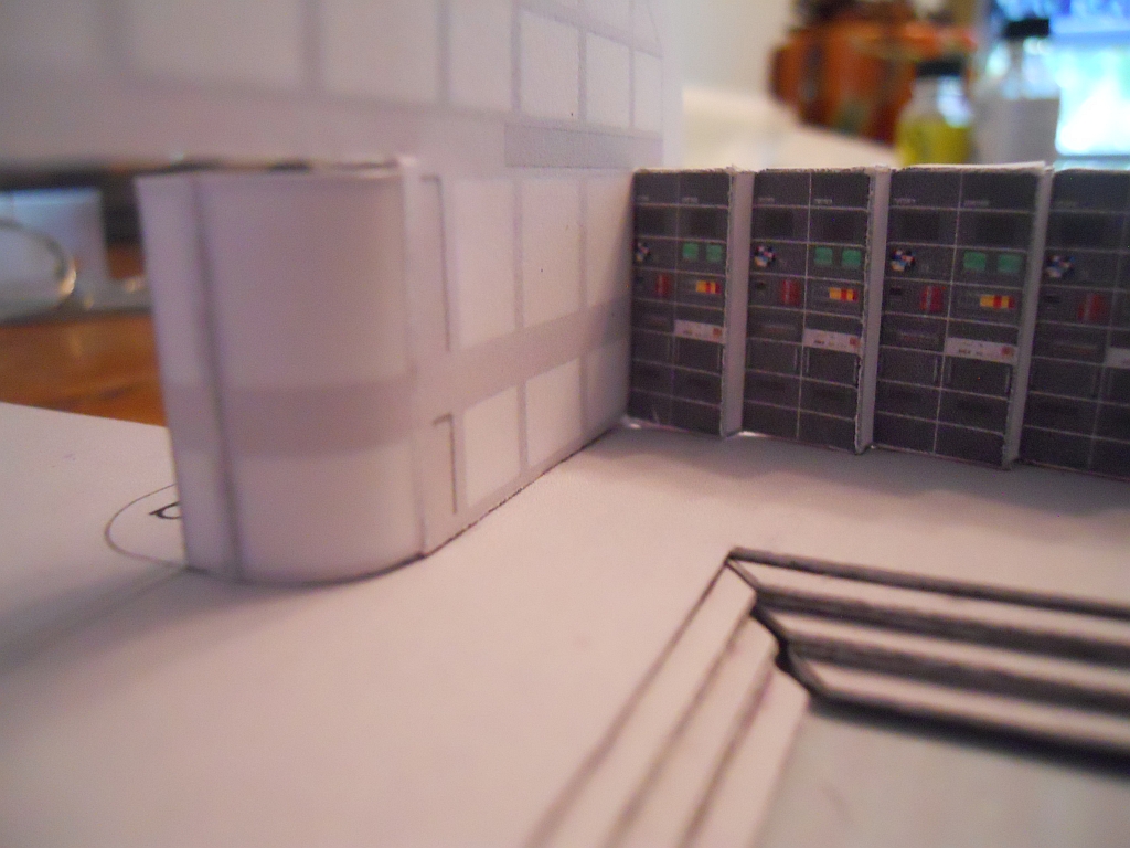

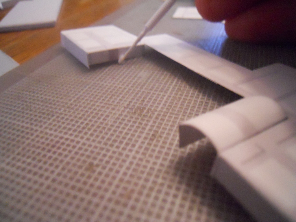

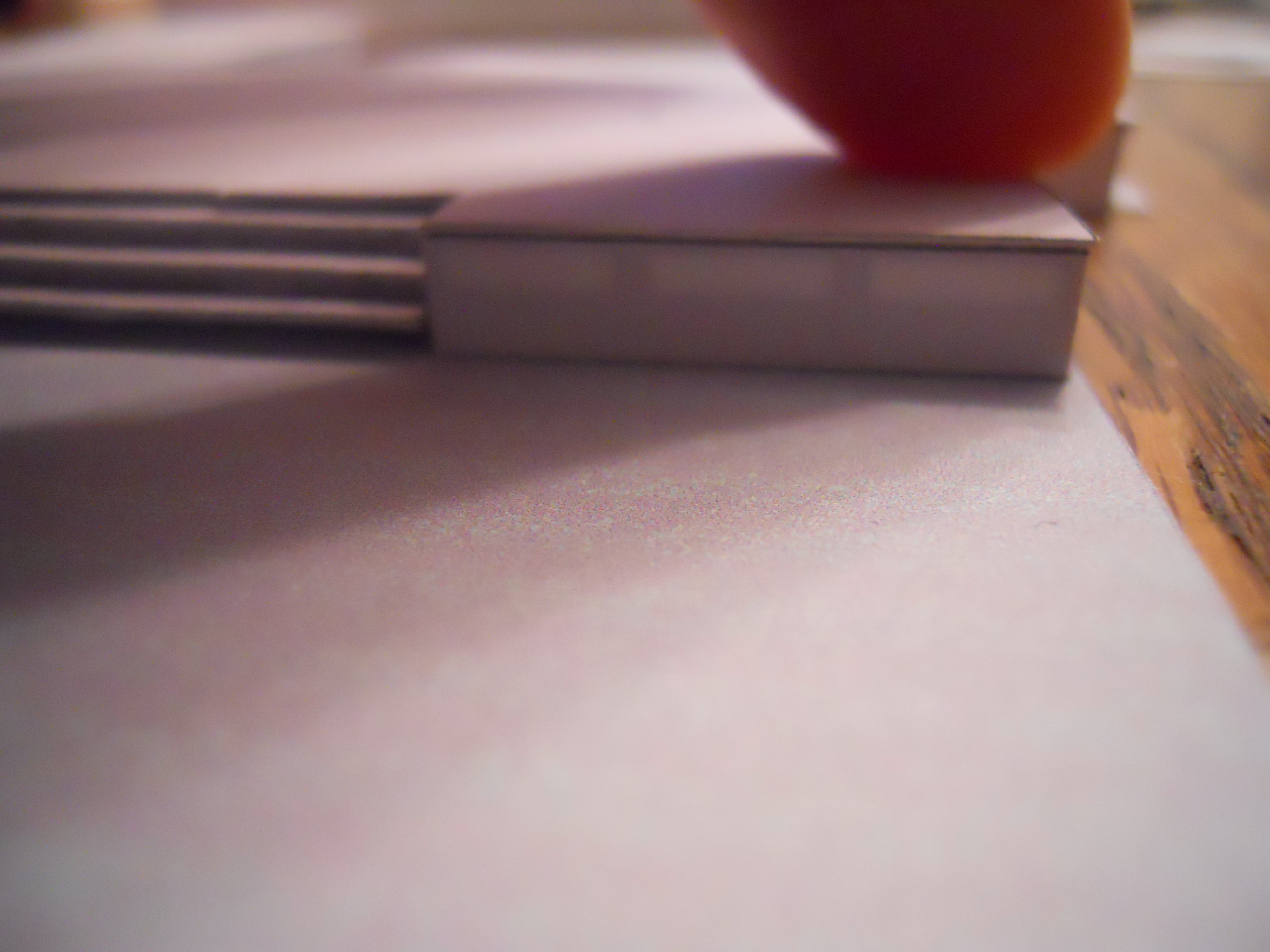

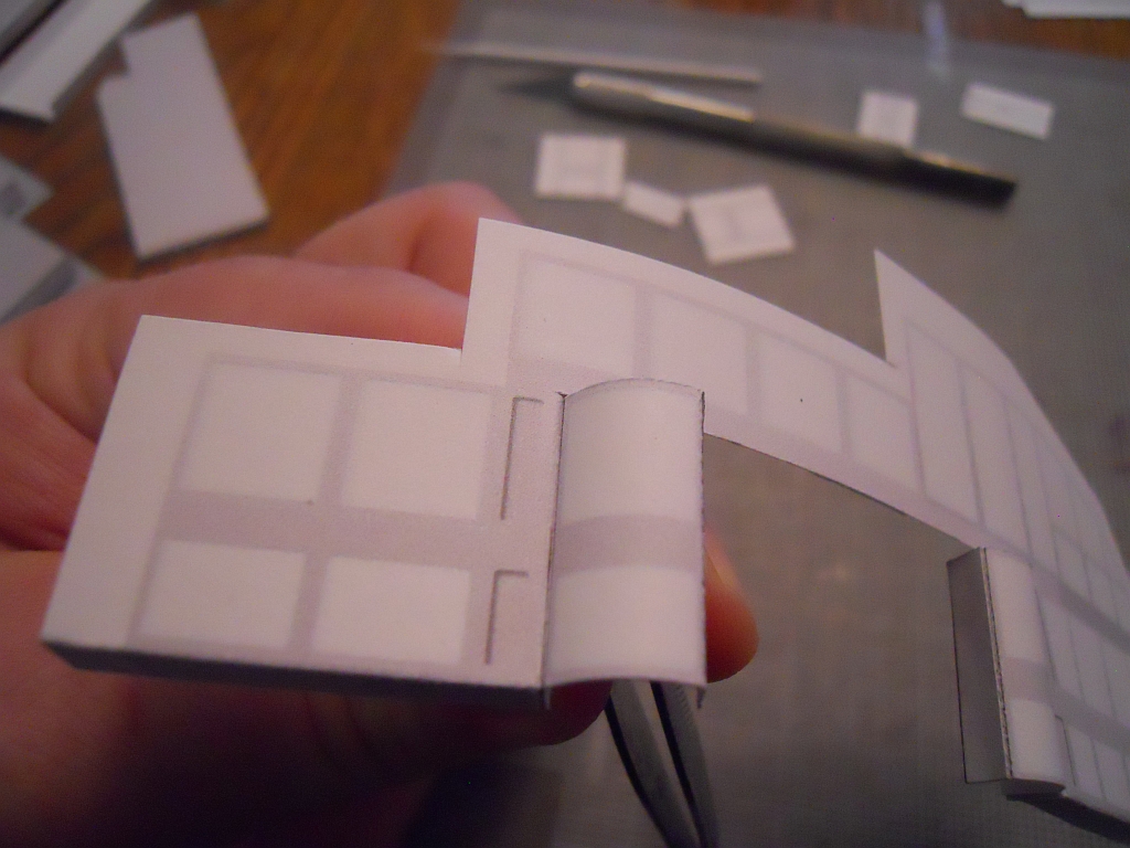

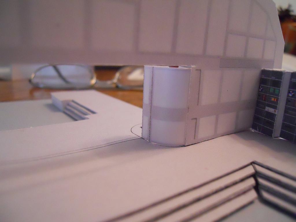

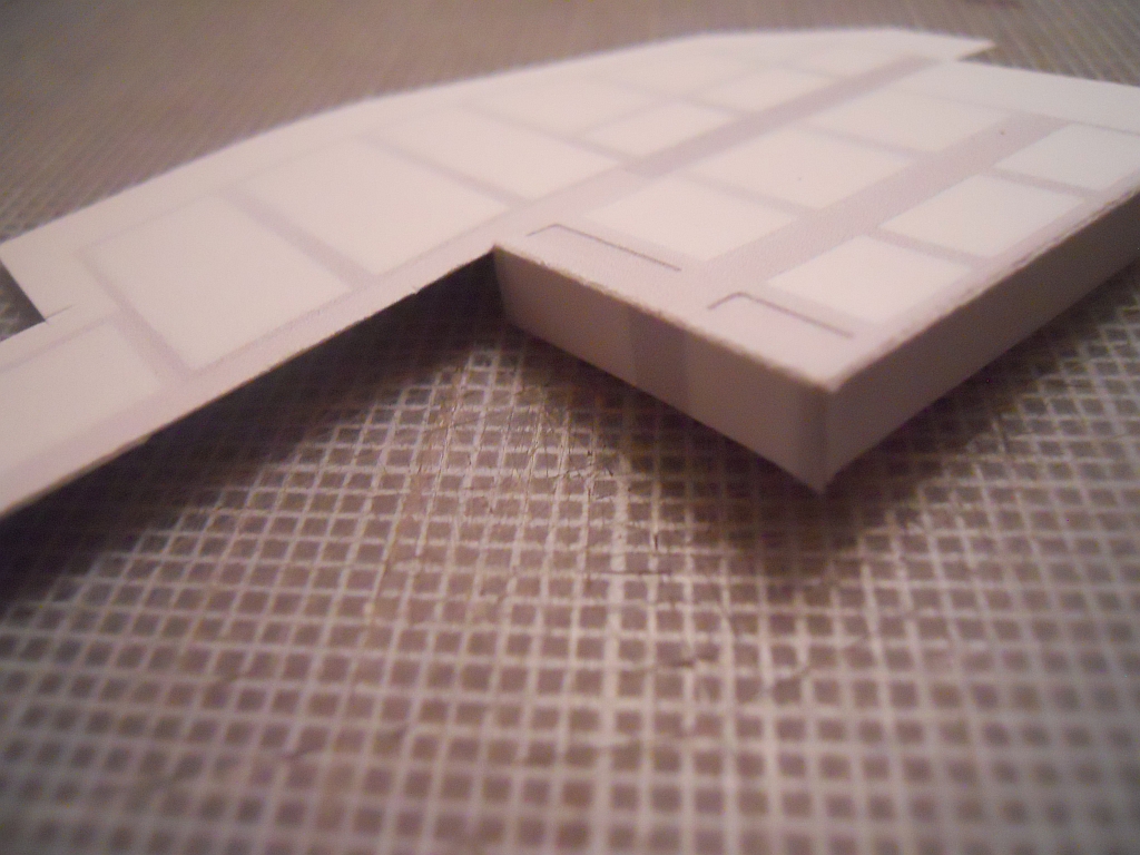

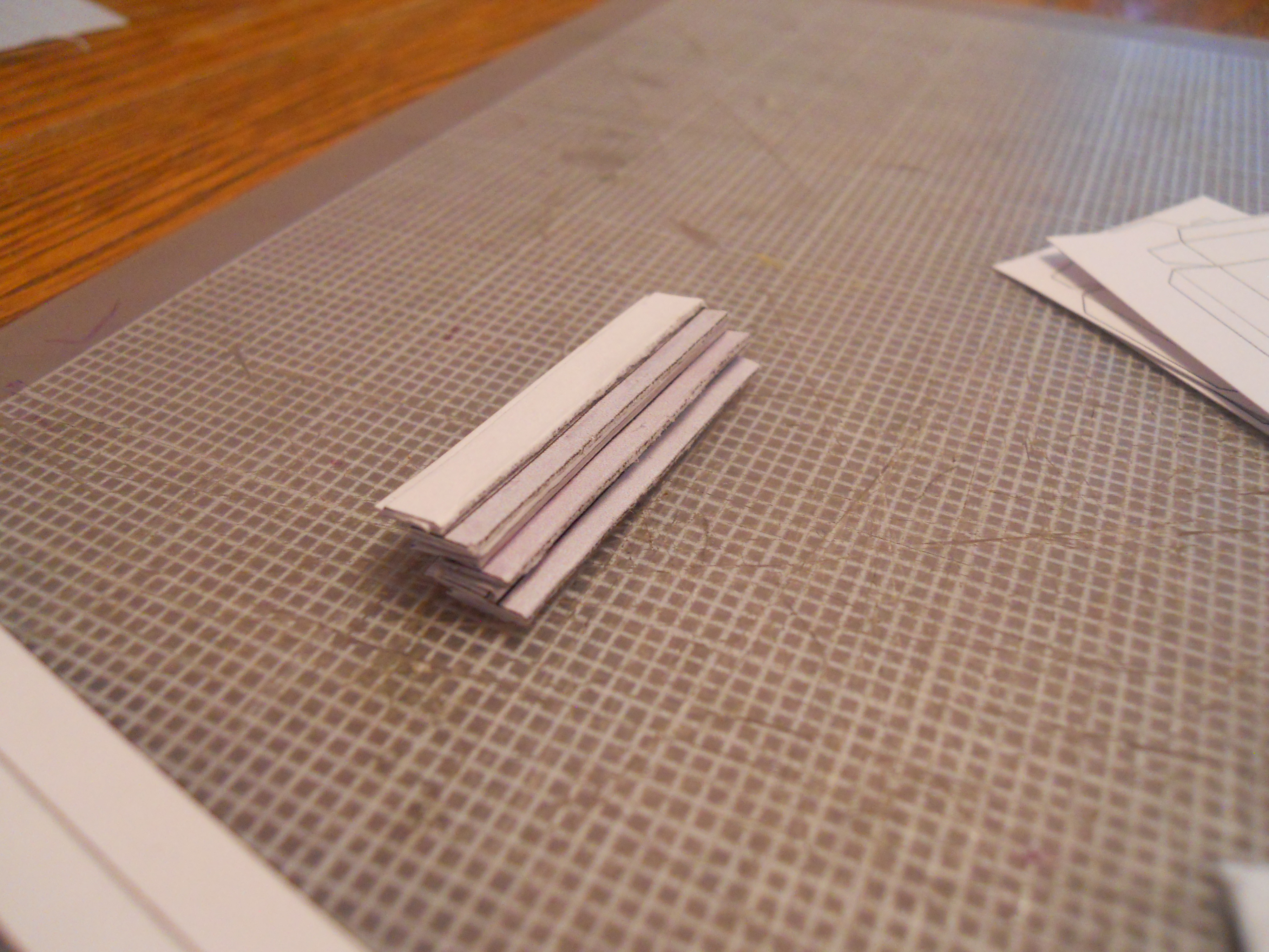

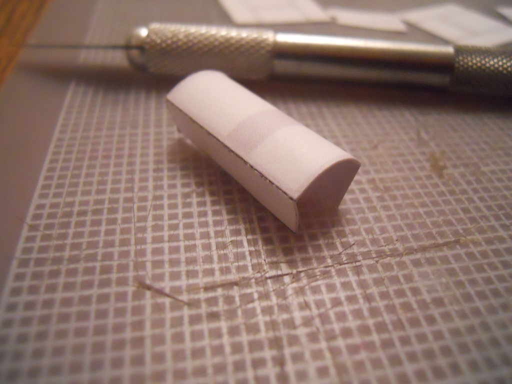

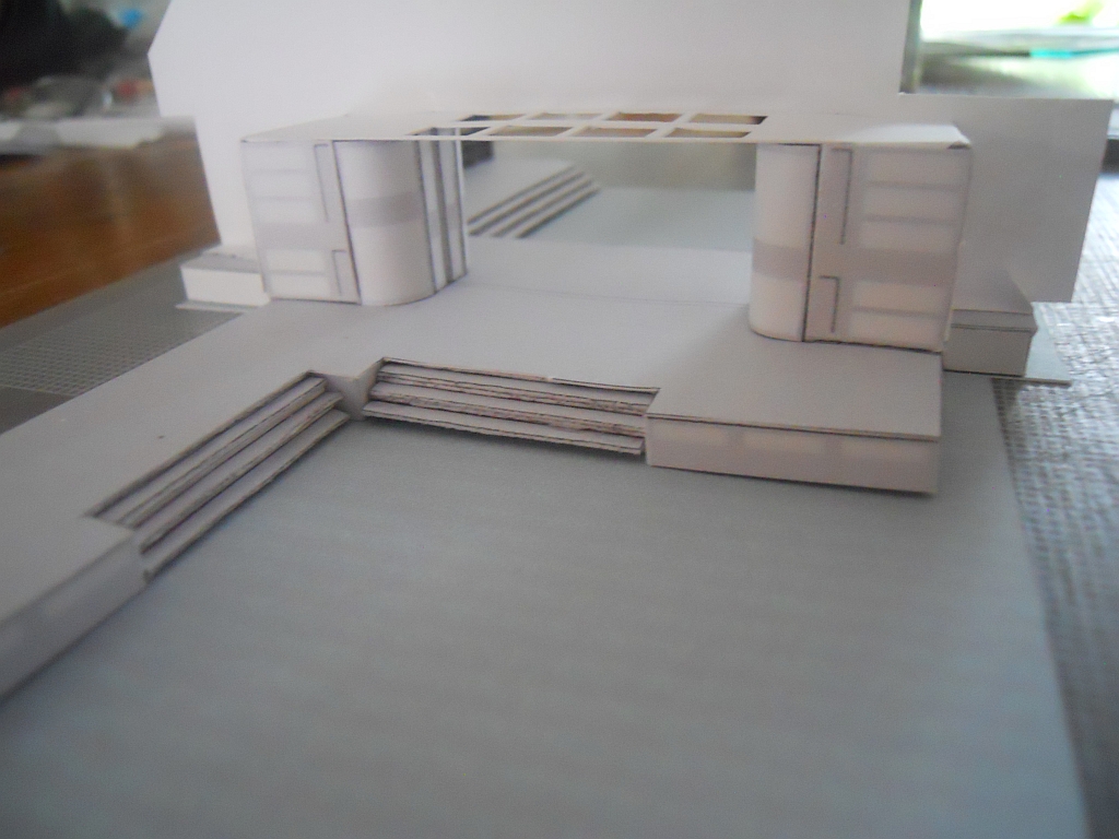

If you are like me and was dropped on your head at birth, you will require things like study models to save yourself from the endless frustration of "trial and error." This study model has already helped me so much in that regard. The scale of the model is so small that putting tabs for making boxes or trying to bend cardstock into columns is extremely difficult at best...especially if you have huge hands with fingers like Bratwurst! Great for giving massges but not so much for finely detailed work... I started off making the raised floor a modified box, which caused all kinds of problems. I redesigned it as a flat surface suspended by several boxes, some with artwork and some simply for support. I had the same problem with the half rounded panels that lead into the command office. Originally they were just one section that would bend around some inward jigs. Turns out it's REALLY hard to bend cardstock in a quarter round shape at a small scale. Solution: Once again, break it all up into components that fit together. I made posts out of the panels on either end of the quarter rounds, wound the rounded piece around my hobby knife and flattened out the tabs on it (see photos). I will install these later today and post more photos soon.

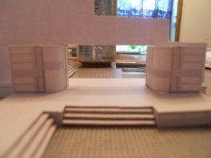

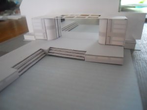

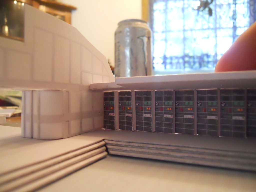

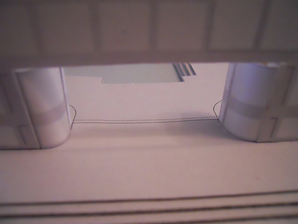

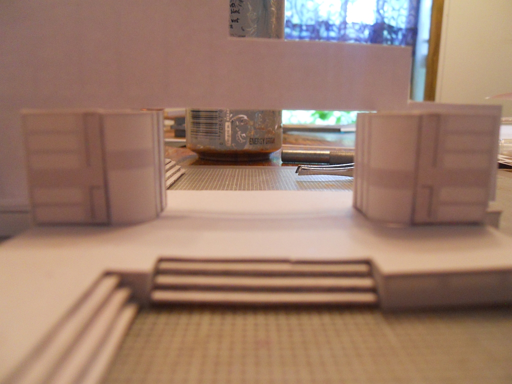

I installed the half columns on the Main Mission side of the model and will do that on the Command Office side next. The right side went together perfectly but I noticed some bulging on the left. Not certain why this happened but it could be anything from a misalignment of the part to a measuring error some where. This is going to be REALLY tricky on the plastic scratch build. Still haven't decided exactly how to do it.

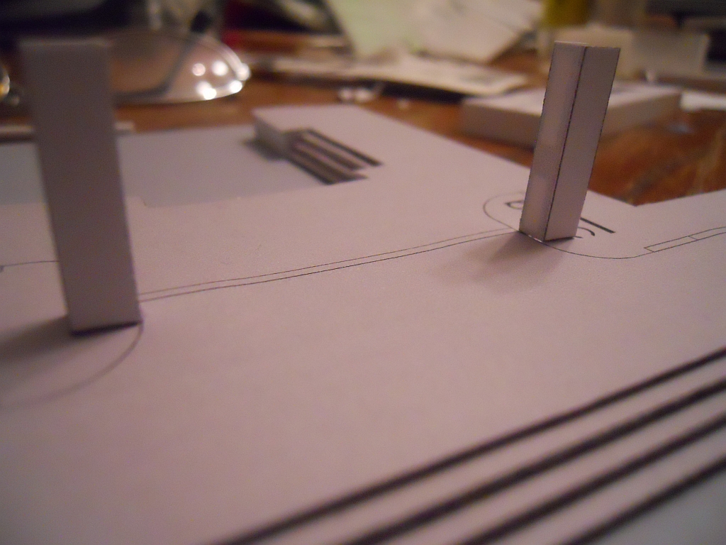

moving right along... I've attached the columns on both sides of the middle wall and added the ceiling piece over them. On the actual set, this ceiling piece is actually lighting but on the scratch build I'm doing (and likely the larger paper kit I'll be offering) the light panels are cut out so you can see the model.

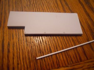

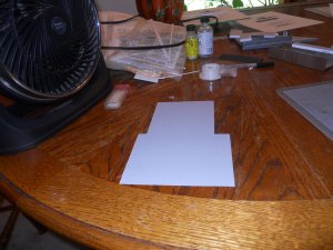

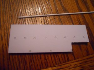

Next up;

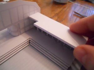

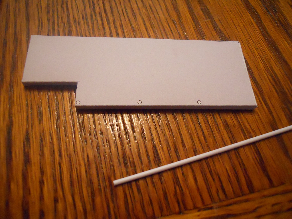

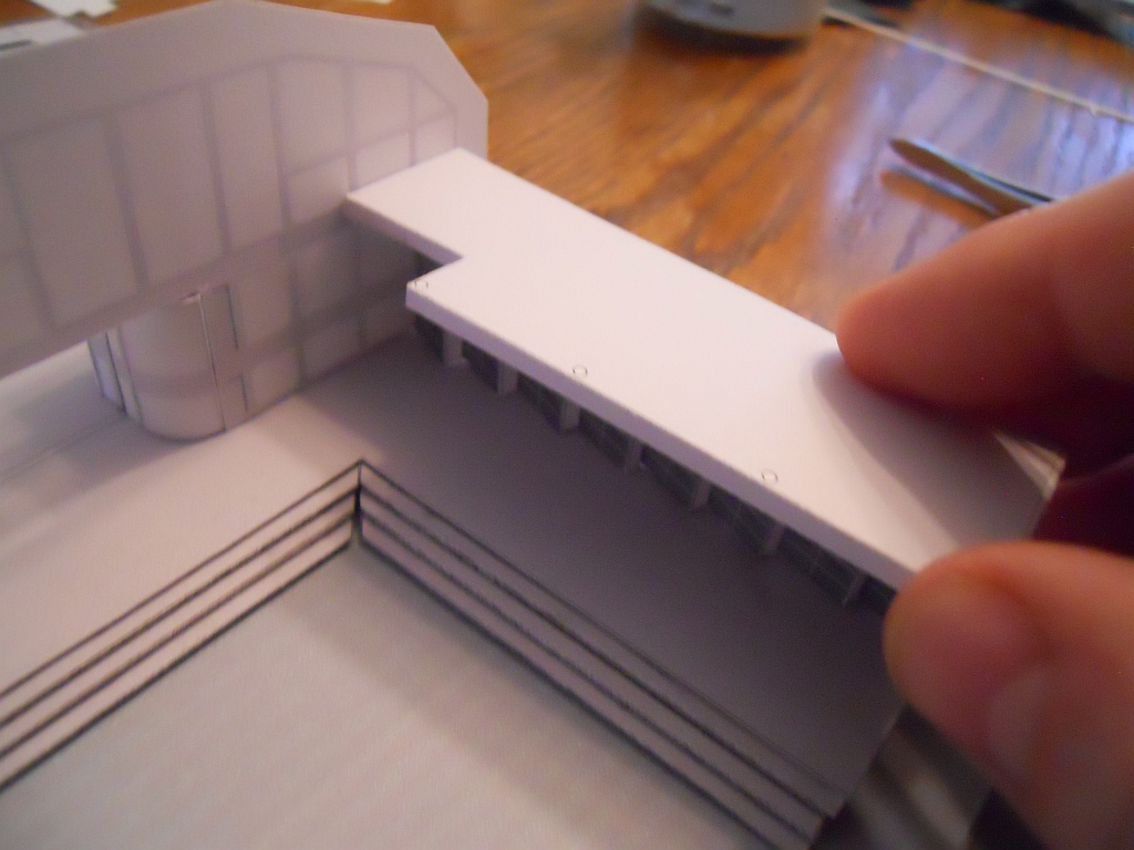

Attach the remaining walls in the control room and then; the mezzanine!

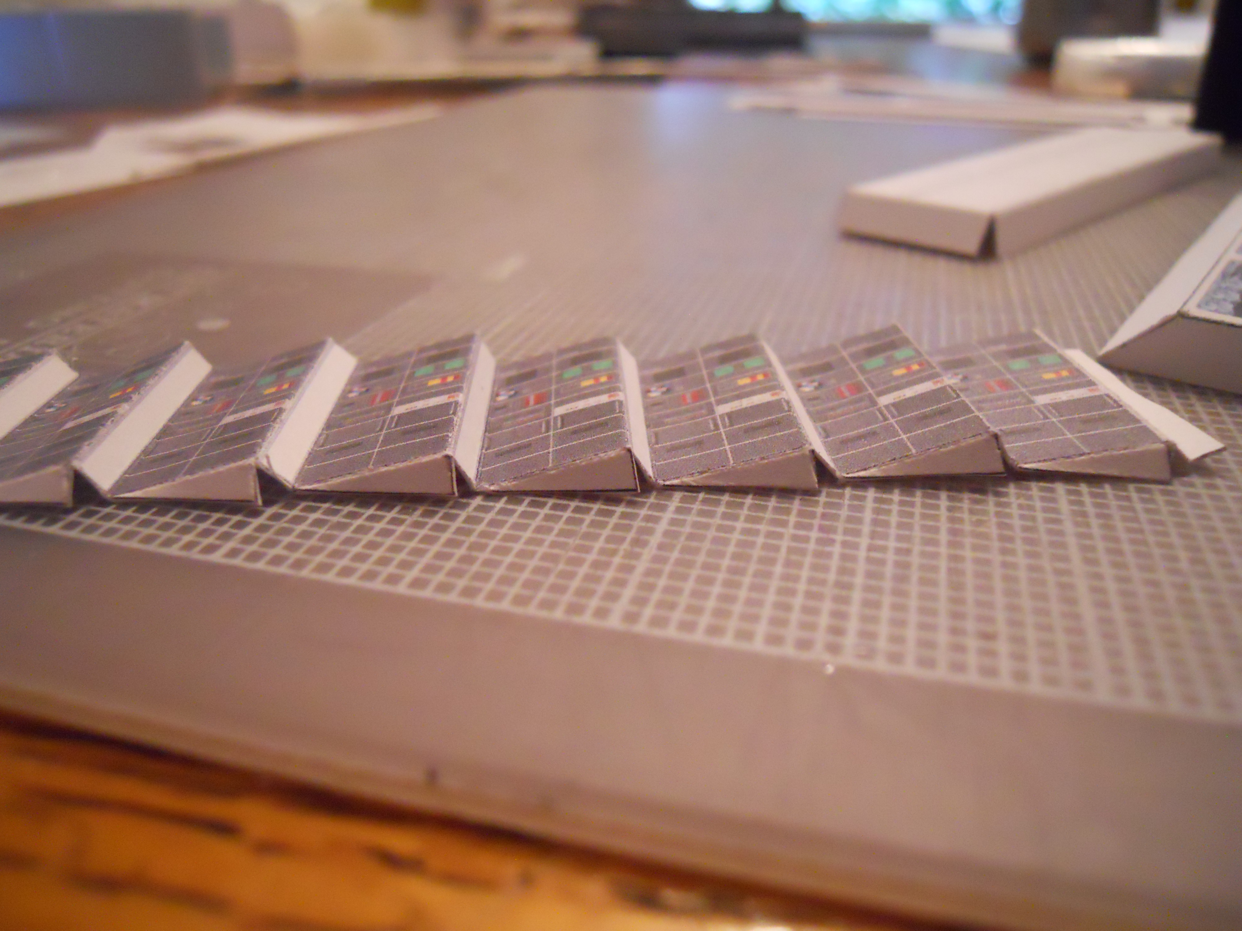

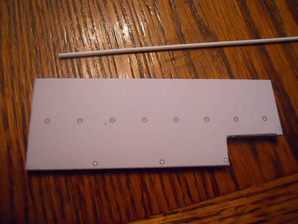

You can see the cut out for the stairs on the left side and on the underside, the eight "can lights" (it WAS the 1970's) that illuminate the computer stations. They're just graphics here (to mark location) but I'll be making tiny ones for the scratch build out of silver beads and tiny washers and then lighting them with fiber optics.
I'm using 1/16th inch plastic rod for the polls and I don't actually have the stairway worked out yet because it's COMPLICATED! But, I'm going to spend some time this weekend working them out. DSCN0278.jpg DSCN0279.jpg DSCN0280.jpg DSCN0281.jpg
