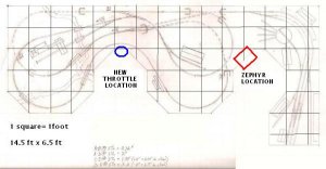

I'm going to buy the UT4 throttle to use in conjunction with my Zephyr.
The pic shows the existing location of the Zephyr (red) and the proposed location of the UT4/jack (blue):
Question 1: Does any one know how far you can walk from the jack or in other words, how long is the cord that comes with it?
Question 2: Do you have to buy the Digitrax UP5 jack or can a "generic" jack be bought at Radio Shack or some such place?....and while I'm asking questions
Question 3: Do I even need a jack or can I buy a 6 wire cable with the right connections (1 male and 1 female...I think) to make the UT4's cable longer and plug directly to the back of the Zephyr?
Question 4: Have I totally confused everybody?.....LOL:D
If anyone can help me...I would appreciate it!
Thanks
Looks good. Did you consider a UT-4R and radio receiver for wireless operation? (You'd need a UR-91 radio receiver panel as well.) It's quite nice to be "unplugged". Actually if you have good sight lines, you can use the IR function that comes in every throttle (i.e. UT-4). The only thing you'd need then is the IR receiver panel - UP-5 I believe.
It comes with a long coiled cord, which will stretch, but remember that the force is all concentrated on the little phone-style jack at the end... I would not go much more than about 4 feet away (plus your reach might give you about 8 feet).
No. As long as the "phone" wire and jacks that you get are 6 wire, you should be fine. Just make sure you wire them correctly (see www.digitrax.com). Standards diagrams can also be found at www.hotrak.ca in the standards section.
That is another option. The jack just fits nicer into your facia, but there is no reason you can't run an "extension cord". I found a box of 6 4-wire double jacks at a local electronics shop for $1. I made 4 6-wire jacks out of them. $0.25 each is not bad. 6- conductor wire runs about $0.30 per metre (I think....).

Not confused yet - you're obviously not asking the right questions...! ;) :D

Hello Steve. Here's a simple $10 solution. Go down to your local Home Depot store and into the electrical section where they sell the telephone components. Find the six-wire telephone jack. The type you are looking for is a surface-mount one that has one jack on the surface and 3 jacks on the sides. You will probably have to do a bit of rooting around to make sure you get the telco jack with the six spade terminals. Cost is about $5.95
In the same area, you will find telephone extension cords. Find an extension cord that has the six wires. has two male plugs on each end, and is about the length to stretch from your Zephyr to the location you have shown above. If you aren't sure, go for the one that is 25' long. Make sure it has two male plugs on each end! Cost is about $3.95
Install the surface-mount jack onto the side of your layout in your favourite location. You can easily do this if you pop off the front cover (locate the 4 tabs on the backside and press them out with a slotted screwdriver), and then screw the jack onto the fascia of your layout.
Unroll the extension cord and plug it into one of the female plugs on the side of the jack. Run the other end to your Zephyr and plug it into one of the female plugs.
Voila, you have extended the reach of the LocoNet.
To extend the reach even further, install another surface-mount jack, and connect it to the first jack with another male-male extension cord. Keep going until you've reached the end of your layout.
Of course, from here, if you want to get even fancier, you might want to really get into the swing of things by purchasing a crimper, some male plugs, and making your own cables. Or, you can probaby find a place that can make the cables for you at a reasonable price.
Have fun. (I am!)
Bob M.
