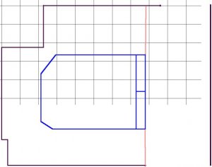

I'm having trouble with my yard design. I'd appreciate some input on these two designs. The bottom yard is the one in question.
or
Looks to me like they both will work. The lower one looks more realistic with the yard tracks straight as long as there is enough room for the ladder tracks. It's one thing to plan them but another when it comes to the actual track laying. The lower one also has more realistic tracks leading to the roundhouse with good loco servicing space.
Thanks Robin & Shaygetz. That was what I thought. :thumb: :thumb: It is actually an adaptation of an earlier version, before I started trying to cram too much into it. :rolleyes: Just wanted someone else to confirm my thoughts. :wave: It'll be easier to wire for DC as well, another plus, :D

I have a couple of questions. I am assuming this to be N-scale, so let me know if that is incorrect. I am also assuming that this is going to be placed against the wall with access inside the "U," rather than an island layout.
I don't see any dimensions. Just make sure that you can reach the back of the layout easily. That means that anything over about 30" deep will be hard to reach.
The lower layout design will be easier to wire since the two reverse loops will be easier to isolate. (In the turntable and on the upper pennisula)
Maybe a point to point layout would fit your needs better, keep the track closer to the front edge of the layout, and also make it more suitable for inclusion in a modular group should you decide to do that. :D

I knew there was something I left out. This should help clarify things.
You are correct about the access. Only the right hand wall will be open, but it will be open the entire 9 feet. The depth at the base of the U is 36". There wasn't a way that I could come up with that would make it any shallower and still fit in the things I wanted to include in that area. The biggest problem was the loading docks in front of the right hand pair of buildings. They are a warehouse and a freight transfer co so I needed to leave enough room for a 40' semi to back in to load/unload and still maintain a passable road in front.
It looks like there are some problems with access to the far corners--the back wall may be 36" deep (which is pretty deep--try reaching something 3' away without smushing anything in between you and the thing) but keep in mind that the corners will be less accessible--the upper corner 38" deep isn't much worse, but reaching anything behind the roundhouse will require just over 5 feet of reach! I assume that the little indentation in the corner is to make room for something structural in the room--it is not big enough to be an access hole.

Thanks jetrock. You have some valid points that need to be addressed. The first and most inflexable item that I have to take into consideration is that I'm confined to a wheelchair which really limits my ability to reach over long distances. Doing some work with the local club really drove that home.
Re the loop behing the roundhouse, I had put that in as part of the runaround track so that the switcher would have access to both sides of the yard. If you have another way to accomplish that I am all ears. :) :) I am currently working on a method to do more or less what you are suggesting. Two things I am considering is 1, the use of swingdown gates that would allow a full circuit of the room (as per attachment) and thus reduce the need to bunch everything up like it is now. and 2, the use of dropdown shelves as described by Train Clown in the thread 13 year old needs help page 4 entry 55. These would be kept in place until access to the back areas would be needed. (need to start a thread thanking TC for the idea)
I'm also considering starting all over from scratch. :rolleyes: :rolleyes: A lot of work, but less than tearing out something already built. Thanks for the input. Every new suggestion helps.
