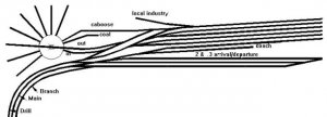

Heres something you may be able to use as a jumping off point for designing your yard.This is a particullarly well done example of a functional yard and service facility.
