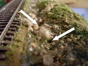

heres a couple pics showing what the WS Realistic Water did where i put it down
Not an expert, but a guess.
I do see a lot of tiny little holes in the scenery. A couple really sticks out and looks like where the Real Water might of seaped out. Try plugging them up with some of those rocks you have. Then try re-pouring only a little bit in the spot you plugged.
