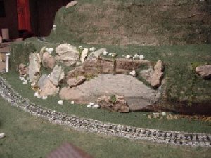

Here is a shot of an N scale hill outcrop I did just using the joint compound and a putty knife.
That looks great Don. :thumb:

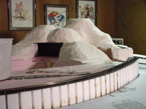

Here's my two cents worth ... when I started my layout, I realized I had a LOT OF SPACE to cover ... so after putting the builders foam in place, I talked with someone at the local hospital ... and was able to get some of that plaster material used to cover broken bones ... plaster rolls. I also purchased some in bulk, and found that it works quite well. The trick is to use only a foot or so at a time, overlapping, and the result is a hard surface for the layout. In the picture below, I wrapped the "mountain" and later covered with grass, trees, etc. I think I used several dozen rolls overall, and still have some left over in order to "modify" the layout.
I found the Smith + Nephew Gyposona "LPL 2" rolls after a web search. It is Plaster of Paris, extra fast setting rolls. It was also helpful in building rock outcrops, simply by placing some odd shaped chunks of styrofoam on the "hills, then using the plastic cloth, then pressing the cloth into the holes and depressions, and painting the "rocks" after it dried.
