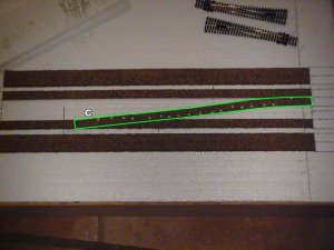

Temporarily pin down a diagonal...
Using pushpins, lay piece C along the track line and let it overlap on top of piece B. Use pins to secure it firmly, but DO NOT GLUE it yet.

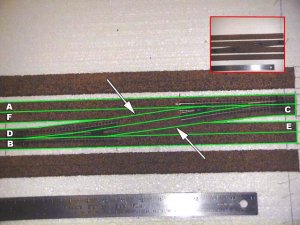

Remove Bevel, Cut and Glue...
Now, place part E along the edge of part A and let it overlap over piece C. Note where it overlaps part C and taking your X-acto knife, go along the edge of C and remove the beveled edge where E meets it (the white arrow).
Next, cut piece E along the diagonal where it meets the newly cut edge on piece C and then glue it down and wedge the pointy end between C and B.
Repeat this step with the piece alongside part A. Don't forget to remove the beveled edge on part D.
Finished product...
Here you see the completed crossover with all the parts labeled for your reference. The two white arrows point to the edges of C and D that you need to remove the beveled edges from.

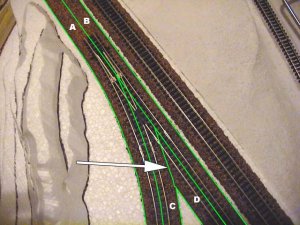

"Corking" regular turnouts...
Thanks guys! Just returning the favor of all the fine help and good advice I've received over the months. To think I used to do this a different way and it would take four times as long to do! I'm glad I started doing it this way! :D

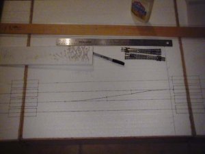

If this thread is to be submitted to the "reference library" then there really is only this to add: On the original thread asking how this was done, I posted this on how to do a regular turnout:

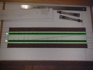

(To make this easier to explain, I have labeled the 4 pieces of cork A, B, C, and D in the picture, and outlined them in green.)
Here's what I do:
You should have your track plan drawn out already, it makes this a lot easier. First I lay the easy complete sections (A and B).

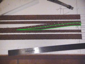

Next, I take a strip of cork, and lay it along C. I let it overhang completely over the top of piece B. I tack it down with pins, then, along where it meets B, I cut it with an X-acto knife. Should have a nice pointy end. Glue it down.

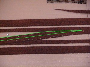

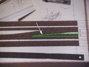

After C is down, I take piece D and do the same thing - let it overhang completely over C and pin it down. Taking my X-acto knife, I cut piece C removing the beveled edge where piece D covers it (the big white arrow). When that is removed, I then cut piece D along where it meets piece C and glue it down.
If you follow these steps, its pretty easy and you can cork your entire layout fairly quickly. The trick is to have LOTS of pins handy. I bought two packs of 100 and found that is not enough! :D :D

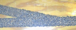

Gave your meathod a whirl
Arlaghan
I used your meathod for my last 2 turn outs and it was so much simplier and faster than the book meathod.I'm not going to redo the few i have already laid but i will use this meathod from now on.Tell me what you think?
Thanks again for the help!!!!
Very Apt Pupil!
Very well done, cpNscale! Nice joints, don't see any gaps. :)
The ultimate test is to place the turnout over it and check the spacing on either side.
Glad I was able to help. :)
