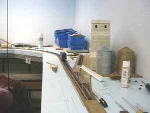

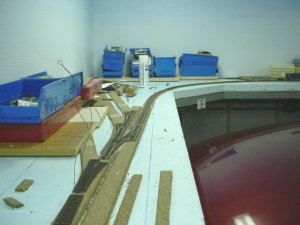

Here's a couple of shots of the track I have down so far. Please excuse the mess!

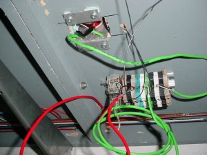

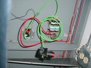

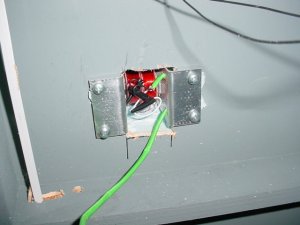

Here is an uncoupling magnet and controls. The wiring is messy at the moment. I'll get it cleaned up and cut to proper length later. If anyone has any questions, I can take more pics and give details. I'll also take some pics of the actual installation process, later.

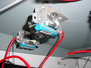

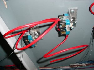

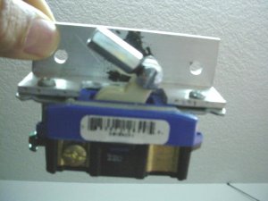

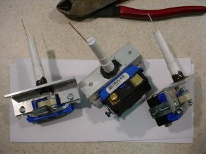

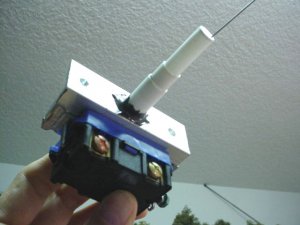

And some pics of the turn-out controllers. These are simply a 3-way electrical switch like controls the lights in your house. They are mounted to an aluminum bracket which is used to attach the switch to the underside of the layout. There is an eyelet attached to the toggle part of the switch. This will be connected to a threaded rod which will extend out the front of the facia, and will have a knob on it. Pushing and pulling the knob will change the turn-out direction. There is a "music wire" going up through the benchwork which moves the turn-out. The wire is enclosed in a plastic tube. I can give more detailed pics and instructions if anyone wants to vbuild some of these.

Looks like you left a roll of solder or wire on the outlet...just in case you're wondering where that got to...I once did that and couldn't find it for months! Had to go to Radio Shack and buy more in order to keep working on the wiring.
Outstanding work, btw. I especially like the grain elevator complex set at an angle to the backdrop and through track. Very nice.

I was wondering where the solder was!

The "3-way" switches I am using are more expensive than a regular single-pole wall switch, but the 3-ways allow me to power some indicator LEDs for the facia. Right now, I am going to go with unpowered frogs on the turn-outs. In my preliminary experiments, my locos didn't have any problem with them being unpowered. If it was desired, the 3-way switch could be used to power the frog, but not sure if you could put LED indicators to work with that.
I am fully confident that this whole affair is going to ROCK the house!:thumb:
The red wire from the switches is some 4-conductor cable that will be used to power some LEDs on the facia. These will show the direction that each turn-out is routed to.
