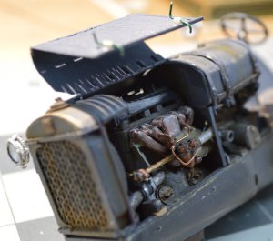

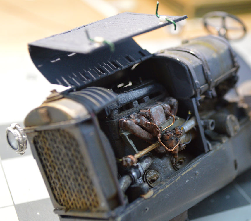

Fitting Hood and Louvers...Test FIT...As far as I can tell there is not a way of mounting the hood to the body, at least in this model. I will have to work out something as it is difficult to open the louvers while trying to hold the hood in place! Figure it will take just some small bits of tubing and insert the hinge wire on both ends, should do it...Got the room and seems logical.
Test fit without the louvers attached ( want to burnish the hood into better shape, before glue up! Hinges for the louvers can be seen lower right.View attachment 171244
A quick view of hood dropped on to show hinge in place...

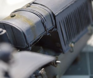

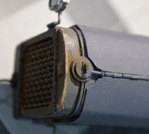

Still here...and got back to this a while back...but didn't have the time recently...just wanted to show some of the updates that have been done...

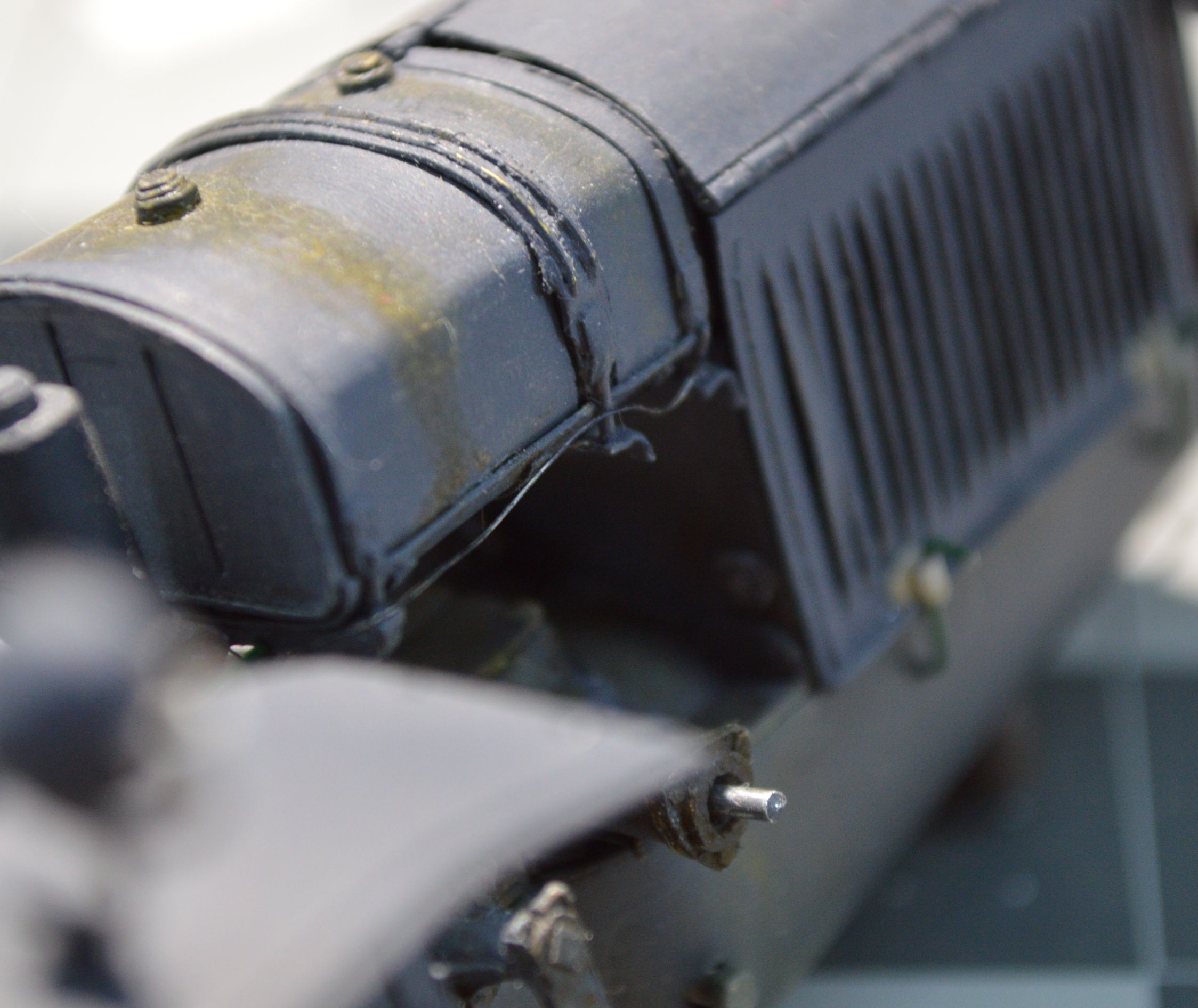

First Got the hood and louvers mounted...and the left louver actually clears the carb with a little room to spare... here is a shot with it in the open position...
added some latches but not really happy with them as yet...perhaps I can mold a socket for the bottom end to turn into...

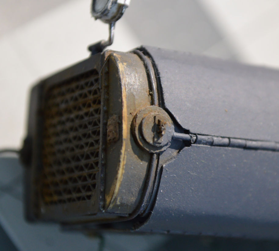

Here is the hood attachment I came up with..and yes ...VERY small tubing to hold the hood pin worked just fine...
and for now at least a view of just part of the wiring with fine wire from a section of a ribbon cable that had braided wire... about human hair size...A Nightmare to get into place !!!
Still needs work..but very close to the end ( if I don't think of more GREEBLES before then) ...oh wait! A Diorama of some sort...) Damn!
