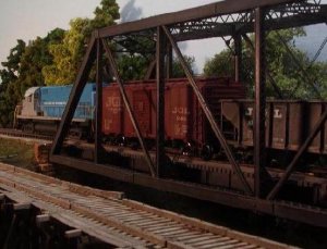

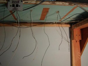

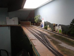

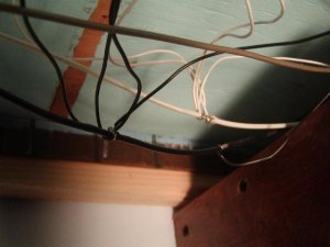

Funny, I'm in the midst of wiring a yard too! My answer to your question is it doesn't matter. Well, between choices 1 and 2 anyway. Yes, you should keep the length of a small gauge feeder short, but what is short? For me, about a foot is ok. I use 22 gauge for the feeders. I took a couple photos of my work in process. It is rather unsightly! I have a lot of feedres because in addition to a feeder for each length of rail. I use 7 feeders for each turnout. Yeah, a bit anal. I'm using Micro Engineering turnouts thrown manually. They have a nice spring locking mech for the points, but I still solder feeders to the points, using something like 30 gauge. Also feeders to the stock rails, and the short rails coming from the frog. The closure rails come with a wire attaching them to the stock rails so don't need feeders. The 7th feed is for the frog, which I won't use unless I need to in the future. But easier to solder before laying! I solder all my feeds on the workbench to the underside of the rail.
So, you'll see in the first photo I have several white leads in one batch, and also a lone black lead. How many I attach is determined by how long the feed is and how much of a mess it would make if I ran too many together. In the pic I haven't soldered yet. I have one more section to do, see photo 2.
The 3rd photo has absolutely nothing to do with anything!

Nice looking work there... 7 feeders per turnout! You are dedicated my friend! Love that last shot of the train on the bridge.

Gary, instead of running a lot of wires from the turnouts, I soldered the ladder tracks together. It's short enough that I don't anticipate any buckling. What you've done with many feeders in one place, but soldered to the bus wire is more or less what I will do. Love the bridge btw!!

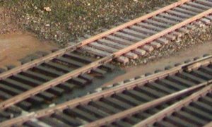

Hi Val, Yeah, soldering the track together is logical and fine, I wasn't concerned with buckling either. For this small yard I only used rail joiners where I felt they would really be needed. Mostly I glued the track down to plywood with the rails lined up and said good enough. How smart this was will take awhile to discover! I used scale railbars ca'd to the rails to join the track pieces together, and every 39" feet along the flex track. I don't have available photos of this specifically, I thought I would do so after ballasting and final painting. But I found this corner of a large format pic which just barely shows one joint between turnouts, in the lower left corner. In the center of the photo you can see where I used similar railbars to connect my code 70 rail to a length of code 55, representing the old original yard lead. with the wood trestle replaced, a new yard throat was built, and I wanted to represent brand new ties next to original ties/rail. It'll look better when done, of course (I hope!)
I screwed up and used quick reply, photo to follow!

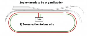

Another quick question. Is is okay to take a secondary wire off the bus wire (same gauge) to feed into the Zephyr power inputs? I'm thinking a T configuration.
Edit: the reason is that it will save doubling the bus wire back to where I want the Zephyr to be.
Val
Not sure what you're asking Val, are you asking if you can have, in effect, the buss be connected to the same power source in multiple places? I say yes, others may say no, but I feel it is no problem. However, don't do this with your digitrax loco net. The loco net should not be arrainged in a loop.
Gary, hopefully the diagrams below will explain. Because the Zephyr is also the throttle I want it adjacent to the yard ladder. I also want the tracks shown in darker grey to hook up to the front end of the bus wire, while the lighter grey tracks will hook up to the tail end of the bus wire.

Hi....Either one of those 2 configurations will work. #1 is better because you'll have a shorter length.
My bare bus wires run perpendicular to the yard tracks, with one end of each soldered to the main bus wires. My feeders are about 6"-8" long.
