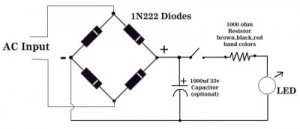

Here is your wiring diagram. The diodes will have a band on one end. That corosponds with the bands in the picture. The capacitor is optional. It is for smoothing out any ripples in the voltage. As Pete said, there are resistance calculators on the web. There is a link to one in the electronics section of the link pages that are in my signature. Usually a 1000 ohm resistor is a safe all-around value for mose aplications.
You only need one rectifier for all of your LEDs, although if you use more than 8 or 10 at the same time you probably should use heavier duty diodes.
Hope this helps.
Oops, a correction. The diodes should be 1N2222. Sorry about that. :oops:

Thank you all for the great info
Clark, excellent diagram and info. Thank you

BTW I just did as instructed and it works!! Wonderfull. thank again
