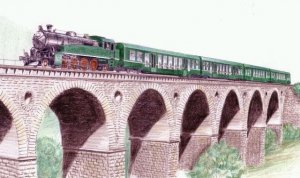

Only now I stumbled over this very interesting thread. Here is some update about modern steam:
Triplex mentioned the Swiss firm which builds modern steam engines. The DLM (Dampf (= steam) Locomotive and Machine works) is a spin-off of the former SLM and exclusively produces steam engines since 2000! They also have an English website (click on 'Welcome') where you can see what is possible, using today's technology in the construction of new steam locomotives (and ship steam engines). They also do revisions of older steam power.
Environment protection is a main issue, and the efficiency of their newly built steam locos beats the diesel locos on the same mountain rack lines anytime. They use light diesel oil, computer controlled firing, extensive thermal insulation and modern, lightweight materials.
Their newest project is a steam powered commuter train (near my home BTW) between Olten (a major railroad knot in the center of Switzerland) and Sissach through a lovely landscape. The idea is to attract tourists and steam fans as well as the daily commuters of the whole region.
Here is a leaflet in English which explains the whole idea.
The picture [drawing (c) by DLM] shows the proposed shuttle steam train with a one-man 2-8-2T engine. She pulls four cars with panoramic glazing. The 'end' of the train is furnished with a cab from where the engine can be run by remote control! So a perfect push-pull service without need to turn the engine is possible.
You can bet that I am very anxious to see if this project really will be realized. Of course I hope so. Imagine - to hear the chuff and the whistle of a steam engine every day, and this in the year 2009 (hopefully)!
You know, that was done back in the "steam era" in Britain... the Great Western Railway, I think?
Also the German 'Reichsbahn' made such experiments even before WW II. But the difference is that at this time you still had a complete crew on the locomotive plus a second engineer in the cab at the other end of the train. They were connected by telephone. At least in Germany the experiments were ended because they realized that the reaction in an emergency case would be too slow.
In this modern project there really is only one single engineer on the train who runs the engine by true remote control.
