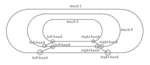

Hi Mike, welcome to The Gauge.
First off I think we need to get an understanding of the layout you are planning. From your desription it sounds like this is what you have in mind. If it is we can go from there. if it isn't you can let us know what changes to make.

Ok guys heres the state of play Track 1 has 1rh/1lh set of points track 2 has 4 points 2 lh 2rh track 3 has 1 rh and 1 lh points all the of above points connect together points to points IE TRACK 1 RH GO TRACK 2 LH TRACK 1 LH GO TRACK 2 RH AND SO ON problem i then have is small wheel base train find going over the point a struggle or come off the long wheel base trains seem to kick a bit when passing over the points how if poss do i set all point so that they square to each other and the trains pas s over with no problems.mike HO for a bigger hammer
