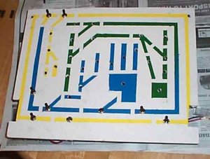

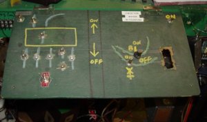

I am doing DC and made my own on masonite.
I have three colours for the three different sections/levels of my layout. It is only 4 feet by 6 feet but has three levels or two decks depending how you look at it.

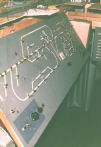

The first pic shows the main panel of my former N scale layout. Trains were powered by conventional DC. I used two throttle panels (darker blue-gray in the lower corners) and the power was assigned by selector switches on the track diagram (rest of the panel).
Turnouts: They were wired in groups of 3-5, powered by a capacitor discharge unit (CDU). Their setting was preselected by switches on the track diagram. When the route was set, I 'fired' the turnout by pressing a button which activated the CDU for this turnout group.

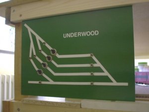

The second pic show the panel for my underground staging tracks. The little buttons also activate several turnouts at once through a CDU, setting all turnouts for this track. The big switches simply turn the track on/off.

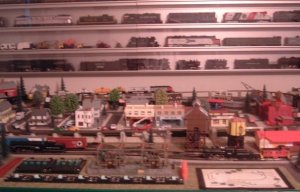

I've got a "Duke's Mixture".... but it looks OK and works good. I used brass plates for some of the switches for added pazazz. Throttle control is an EZ Commander that I can walk around with. Switches are toggles and momentary, and the lighting contol is there too, all one panel as seen below;
I was going to say a funny like High Roller or some such, especially with a dream setup like yours...I restrained myself tho :p

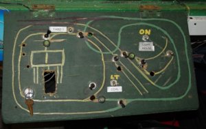

Mine's a good plug for old school---Atlas. At a time when it was a real chore to wire for block control, Atlas came thru with their ready to wire components. This panel came with the N scale layout that was given to me earlier this year, should I ever get to build my HO layout, I don't plan on doing it much different. I'll be adding push buttons for electromagnetic uncouplers to the track diagram on the right later this year.

Tom...You've got too many push buttons on the "facing" switches. I've got mine set up so that when I hit the button for the diverging route on any one of the two facing switches, they'll both line up to the diverging route, since you don't want a train coming from the "through" route to run into a switch that is set for the diverging route. The same holds true for the "through" route. Try it, you'll like it!!

Gus, thanks for the tip. I'm familiar with cascade style wiring but have mine wired so I can isolate one locomotive while I run another. I use power routing turnouts (never ws a fan of relays and extra wiring) and isolate a lcomotive by throwing the turnout against it.
