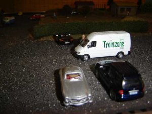

I was thinking of just using Styrene my self.If I want it to look like Blacktop I was thinking of using super fine sand to give it some texture,not sure how that would work out though.
Chris

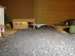

I use a mixture of sand blasting grit- can also be used for model coal, matt black powder paint and plaster(in powder form). Ratio: 2 (Sandblasting grit) : 1 (Matt black powder paint) : 1 (plaster).
This gives me satisfactory results.

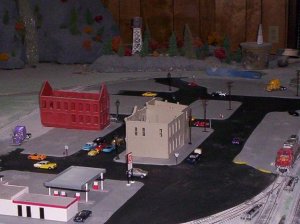

Hey Heath, I used a sheet of foam art board as a base and cork board for where my buildings set with enuff space for a side walk. I covered the cork board premixed wall plaster mixed to a gray color when dryed i sanded smooth never losing the color of concrete it made drive entries easy to make realistic. I just paint the roads with black paint and planning on using auto pin stripe for my street lines. Pin stripe for the curbs too.
