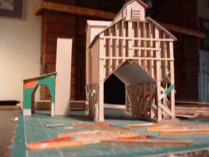

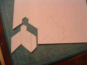

As I start this new project I thought I would ask you what you think this is going to be?
Just for fun, but I will name this after the first person to identify what this is going to be.
Tyson Rayles steel-truss wood coaling tower
Thanks for the responses folks. Tyson and Pete are right that it is a coaling tower to be but as Tyson was first I will name it in what ever way you choose Tyson.
This structure is based on the Fairbanks-Morse steel-truss wood coaling tower. There was an article on this with photos and drawings in the February 1998 MR.

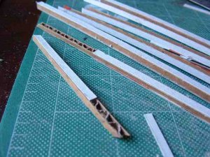

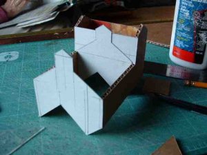

Just thought I would show you here how I make wood beams.
Just cut strips of corrugated cardboard. These are 1/8th inch . Next I cut strips of cerealboard and glue them on both open sides.

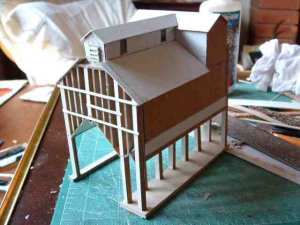

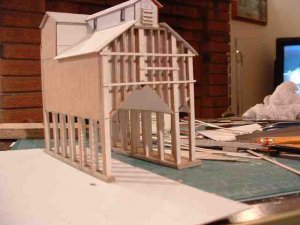

Here I am adding wood beams to the coaling tower. Lots more to go but this is where I am at today Sunday the 27th. Did quite a bit while watching NASCAR Winston cup race

Todays progress 29th. I glued in the cross braces and started the coal hoist. In the foreground you can just see the steel girders that go in next.
In addition to this I finished running the bus around my double track mainline and added feeders about every 4ft.

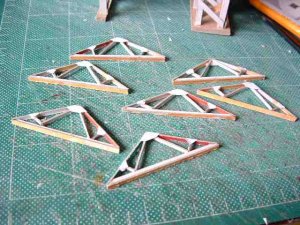

Progress to the 30th.
Steel trusses ready to install. These are designed to support the weight of the coal. The gussets are paper. Next step before installing, is to paint them rusty black.

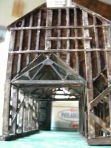

Some of the steel trusses in place. I have stained part of the coal tower with a dark walnut stain to make it look like the original tower had been coated with creasote.
