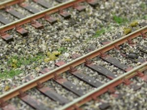

Pic 2: Next step is ballasting the track. I use bird sand, a sort of granite sand which I got dirt cheap (a 2 kilogram bag about $1.50) in a local pet store. I fix it with the usal mix of 'wetted water' (i.e. water with a few drops of dishwasher rinsing agent added, or a water/alcohol-mix) and white glue (water:glue about 3:1). But then I'm also adding a shot of black india ink to the water which helps to tone down the clean ballast.

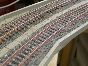

Pic 3 shows a short piece of double track with additional weeds in the ditch between the two tracks.

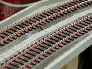

Beautiful results Ron! I weather track before installing it by using a quickie method I saw in Model Railroader years ago. I spray paint the rails from an angle with inexpensive brownish red spray paint to paint the side of the rails and not the ties. Then I randomly spray a little gray and a little black straight down on the ties to give them a varied appearance.

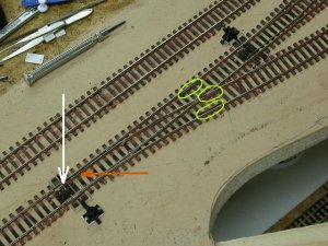

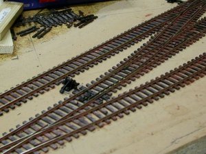

As an addition: A few remarks about rust-painting turnouts:
Try NOT to get paint between the switch points and the stock rails (--> WHITE arrow). This is e.g. quite important for PECO electro-frog turnouts. On the other hand, the inner sides of the switch points SHOULD be rust colored and not glossy (--> 'RUSTY' arrow).
And finally you should also paint the upper surface of the guard rails and the wing rails near the frog (--> GREEN rings) a rusty color. In reality, the parts of the rails which make actually contact with the train wheel are the only shiny rail sections in a turnout.

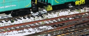

Inspired by your pictures Railron, I encouraged my self and have done my first attempt to weather a rail.
I used Humbrol number 70 enamel diluted with white spirit and a small brush.
What's your opinion?
