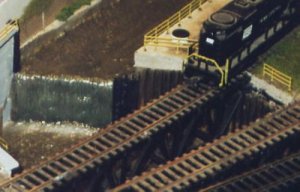

Here's one I made at the end of a canal that spills into a river. I followed an MR article (sorry don't have it anymore or know which issue) that used fishline to create the texture of the waterfall. I cut a piece of plexiglass to size, wrapped transparent fishline tightly around it and glued the ends to the glass. Then I glued the assembly in place in the scenary. I had painted the area behind the falls black. After installation I poured acrcrylic glss medium on the canal and pulled it down over the falls. It took several coats to make it look "wet". Then I added a little cotton at the bottom to simulate churning water and dribbled more gloss on that.
Ralph

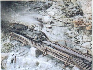

:wave: Hi UP, here's a small one I am working on using the WS Water Effects. No fuss, nothing extra. Just do it the way you want. I like this stuff it is very easy to use.
