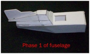

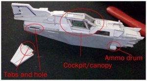

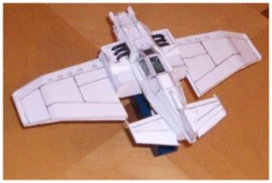

I finally got around to the Thunderbolt. Again it was a toss up as to where I wanted to post it, here or in the games and accessories section. The basic plans are Leigh's, and could be found at his post, at the Games and Gaming Accessories, but his plans seemed to have disappeared. If he reads this post, he may want to re-post them again.
They are not my plans, I just modified them to my taste and abilities.

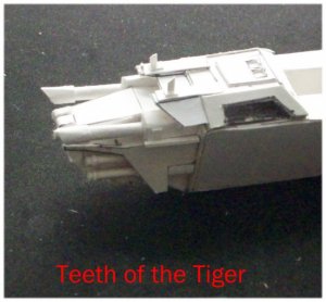

I started to build the model before I searched Games-workshop, White Dwarf and Forge-World for reference material and if I have done that first, there would have been more changes. Albeit I will make do with this build.

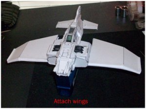

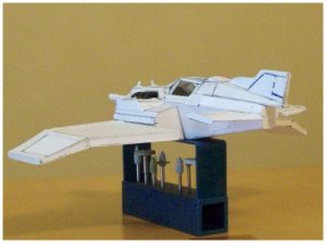

The first pic is where I am at now. This is not a complete build process because I scratched built as I went along.
The model is in a basic Beta style white. At the end of the process I will color and weather the Thunderbolt :wave::wave::wave::wave:

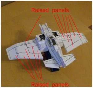

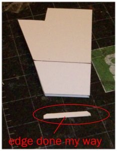

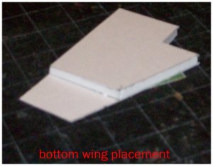

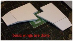

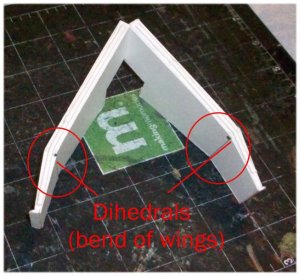

Thunderbolt

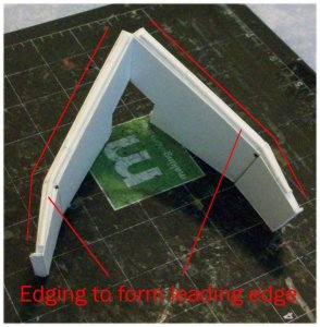

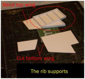

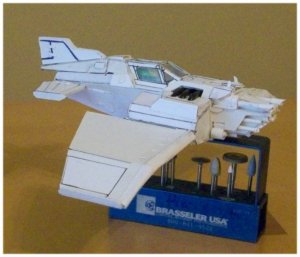

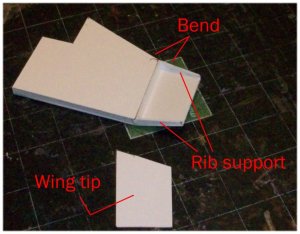

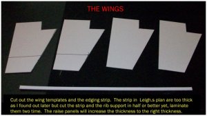

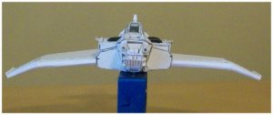

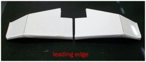

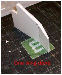

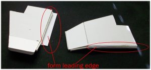

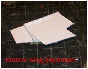

Thunderbolt wings. Here you can see that the wings are too thick. If you make them thinner it would look better. Because of this, I had to make the raised panels later on out of thinner paper. I was tempted to draw the lines for the raised panels.
The leading edge formers are paper sticks formed into the dihedral shape.
I also added a wingtip panel for something special later on, maybe fuel tanks or missiles, I have not decided yet, still building at this time.:wave::wave::wave::wave:

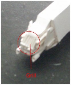

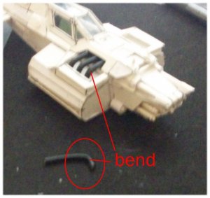

T-Bolt

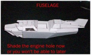

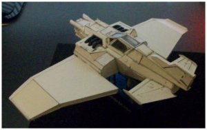

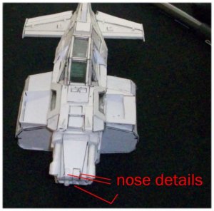

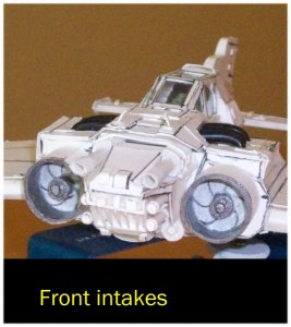

T-Bolt continuation. When you get to the engine fuselage ports, Color that portion in with a dark color. I used gunmetal for it but black will work as well. If you do not color it now, it will be very hard to do later unless you can train and ant to use a paint brush and do it for you.:twisted:
I did not do a tutorial on the nose and I should have slowed down as to how I built up the nose section. Especially the grill section as well as the guns. The top cannons are a bit long in comparison to the Forge-World model but I believe mine look more menacing. :wave::wave::wave::wave:
More to come.........

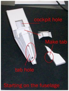

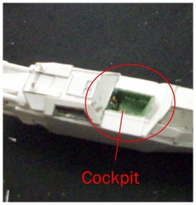

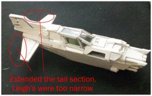

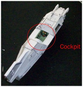

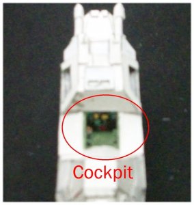

T-Bolt. Started on the Cockpit and canopy. I made a mistake too late to fix unless I tear up the canopy and you know how hard it is to make one with clear plastic. I forgot to finish the seat, seat belts and the joystick.
The Canopy is a three piece item and I used super glue. I roughed the edges of the acetate with my knife to get a better bond and it worked for me. I did the top part first and then the sides. There is enough of the paper to allow for the white glue to adhere. I am not done with the canopy yet. When it comes time to paint, I will use the sticky label technique to go over the frame of the canopy.
I added a few surface details like an access panel to the rear of the fuselage, another electrical panel behind the cockpit.

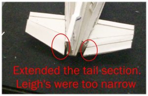

Leigh's rear stabs were too narrow so I extended them. They will need to be trimmed later on for a proper fit of the tail engine exhaust.
Don.t forget to make tabs for the stabs and a slot for them to go in the tail section of the fuselage.

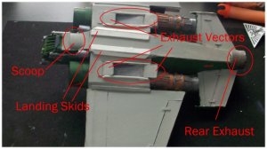

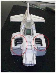

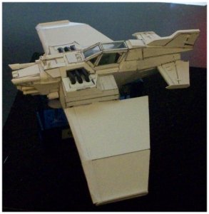

Thunderbolt

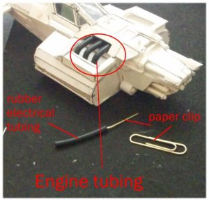

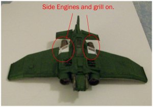

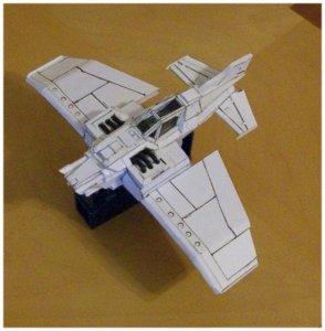

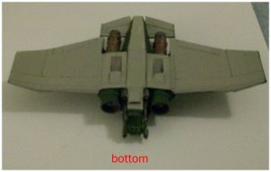

Attached the wing sponsons and a few details on the nose and other parts. Built up the box for the engine tubing. This is the area where I deviated from paper and used Electrical rubber tubing. I was thinking of using Glue impregnated string or jewelry wire to simulate the ridges but decided not to.
I am in the process of hand painting the T-Bolt. Finished the wing engines and making the rear exhaust. I believe it is coming out way much better than the Lightning. Just got a little bit more to go.
On the wing tabs that go into the sponsons, since I laminated the bulkheads, I had to carve out the tab to be able to fit into the slot.

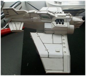

Thunderbolt
T-Bolt raised wing panels. Don't worry about the rough look now. Believe me it will much better when you see it painted.

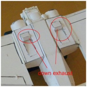

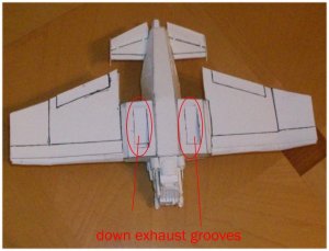

T-Bolt

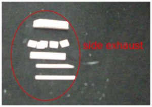

Continuation, Cut slot and angled ramp for the down vector exhaust., Did the front intakes and the front vector exhaust.
Cut small squares for the side exhaust on the sponsons and a few other small items.
The T-Bolt is now starting to take shape, wait till you see it colored.

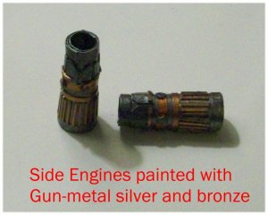

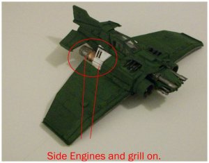

T-Bolt

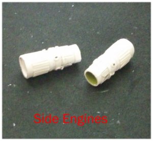

Bucket of Bolts. Constructed the side engines, and initiated the first stage of the paint scheme.

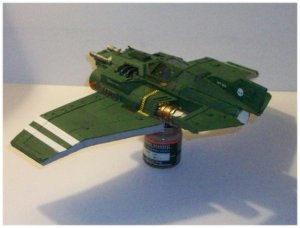

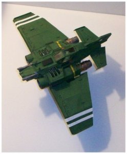

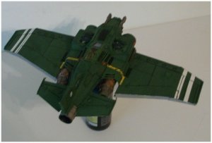

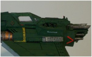

T-Bolt

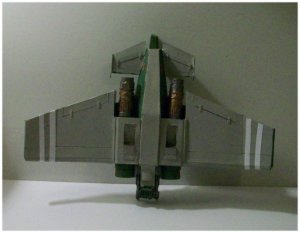

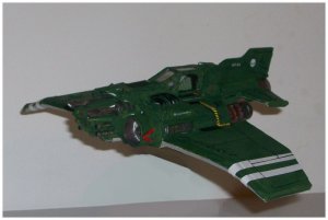

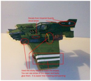

Coming to the end of the T-Bolt but not quite finished. I have the bombs and missiles and a base to construct. Next posting, I will show how to do the sticky label method.
Pic #1 has the warning line done in sticky label as well as The stripes. You can also make them out of thin reg paper. It is easier than masking off the area and painting. It is almost like working with a decal in a certain way.

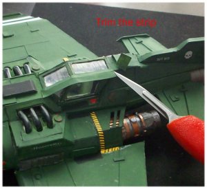

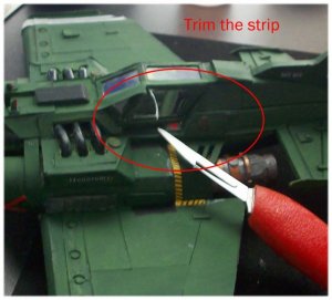

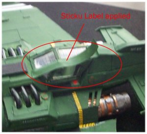

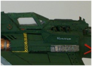

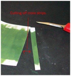

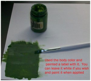

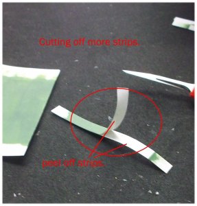

Canopy Frame
Sticky label method. I stumbled on this method when I was putting together A toy for my Grand-kids. It called for sticky graphics to be place on the toy. Light bulb went off and hey this could work!!!
I use The Avery label but any kind of adhesive labels will work. This method is useful for making stick-on drawings/graphics. Also great for letters on the side of Aircrafts. In you word processing program do the insert graphics and place them on the label format of your program.
If you are graphic capable, draw your own like I did for the caution tape on the wing engine sponson and the engine intake triangle.
When trimming, be sure to use a new blade to be able to trim the excess off without it catching and dragging.
If you paint the label prior to gluing, let it dry first or it will also dragg and rip.
The next post will continue with the sticky label method.

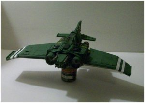

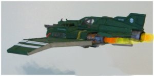

T-Bolt
This Sticky Label pic is out of sequence but I believe that you all get the idea.
Here are some pics of the T-Bolt, it's almost done. I will update it a bit a time. Contemplating that base and a clear Plexiglas rod or pylon. Working on the wing under armament, missiles, bombs and stuff OH MY!!!:wave::wave::wave::wave:
