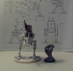

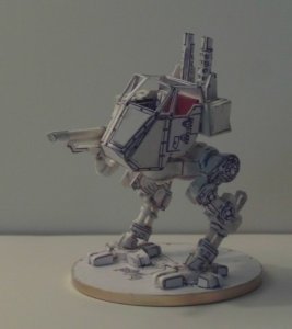

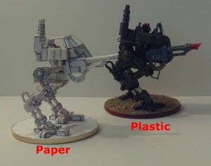

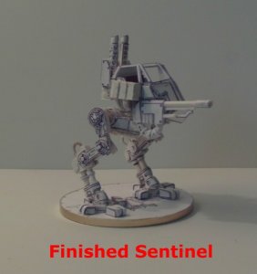

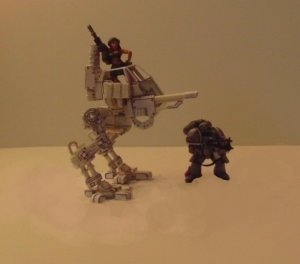

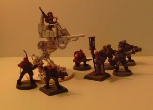

As mentioned in Flarebaffle's thread, I will start a Warhammer section with some of those fabulous models uploaded by Armorman. Eli Patoroch has done a remarkable job in the designing and constructing of those armor vehicles. My first attempt is the Sentinel and by no means will it end there. This Sentinel is about the correct size of the original and it is very well detailed. There where some modifications done like in the foot pads but over all, the model went together rather well. Here are a few pictures of the model and soon I will start a build thread with the color version.
I have placed some of the Warhammer Imperial troops next to the model so you can compare the size and also a Plastic Sentinel so you can compare and see how close to the size and detail is the paper model.

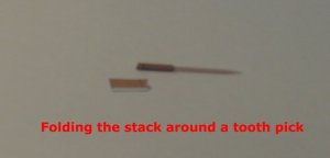

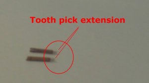

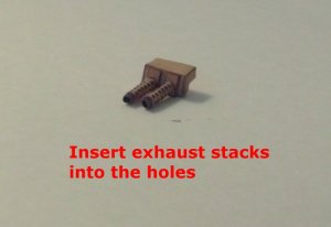

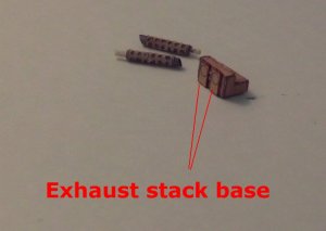

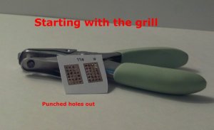

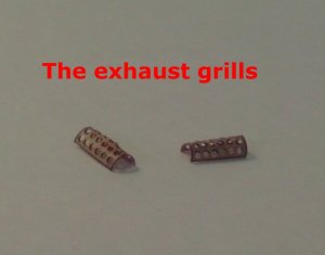

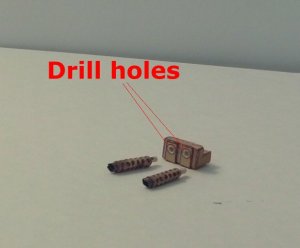

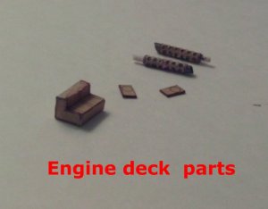

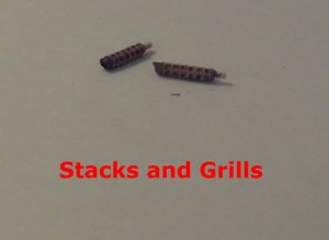

To start this session, I begin with the Exhaust module. With a small punch, I made the ventilating holes for the exhaust stack.
Next I took the exhaust stack and wrapped it around a round toothpick. After the stack is set, I placed and glued the toothpick half way in. There is a little of the toothpick sticking out of the bottom. This is done different from the plans, in that it will be inserted into the Engine block and it will be more sturdy. The backs and edges are colored in.
There are about twenty pics for the the exhaust section. There are more sequences to come.:wave::wave::wave:

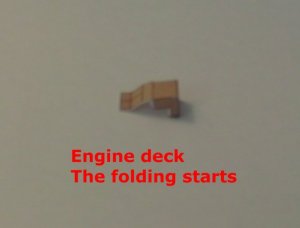

Continuing with the build. Used part #9 and started to fold the parts. Parts #9a, the stack base are laminated and then placed in to their locations after coloring the edges.
Once the plates are set. Drill a hole big enough for the toothpicks extensions in the stacks to go in.:wave::wave::wave:

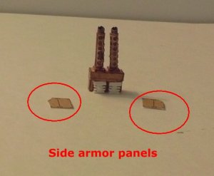

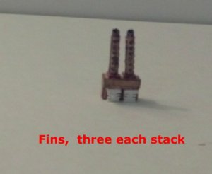

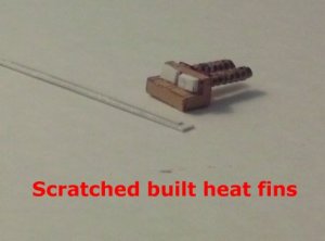

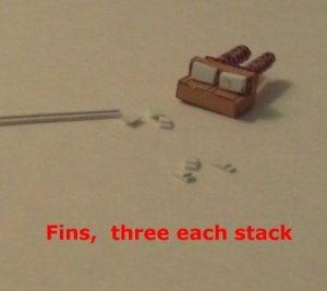

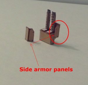

More on the exhaust stack. The pictures are a little out of line but you can see that I made some modifications with the heat fins. Those side armor panels will come in the next installment. The white sections are the scratched built parts, But you can use the ones in the kit as well. The small strips are on the original plastic model but you can do without them as well.
The fins were done by gluing a smaller strip on top of another slightly wide strip. Measure the width of the fins and glue three stacks as shown. It will give the illusion of the fins.:wave::wave::wave:

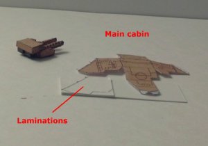

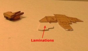

Chrispysurfer. There are different weights of paper and the most common weight in the USA is 60lbs. I prefer to use 120Lbs. For lamination or to make the pieces thicker, I use a cardstock about the same weight as that used for shoe box or pizza box. In my case, I am lucky enough to acquire the same box materials that are used for jewelry boxes.
Sometimes I use markers but I would rather use acrylic paints. In this build I will probably show some of the paints that I use. When the scratched built pieces are done, I paint them sometimes by themselves if they differ from the main color scheme, for example, the exhaust fins and the stacks. For the body, I found a color that is almost the same as the body "Teddy Bear Tan".
Now for the base, It is a heavily laminated round center pieces that were left over from my building a horse drawn buggy on the sister site "papermodelers.com". When I reached the desired thickness, I edged it with a gold colored cardstock.
Keep an eye out on this build and you will see some of my techniques and tricks that you can use on your own models. Enjoy and see you around in the forums.

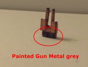

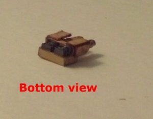

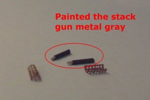

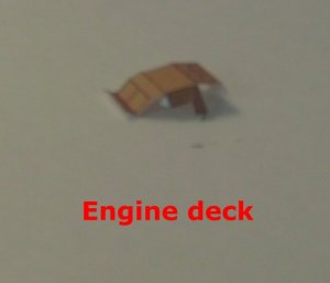

Almost finished with the exhaust section. For some reason the pics are out of order again. The main cabin should be at the bottom. You can see the lamination of the side panels. They are thick enough for edge gluing and does away with the tabs.
As for the engine portion, I painted the fins a gun metal and colored the white side of the armor plate a darker brownish color. The side armor engine plates are also glued to a heavy cardstock for thickness. More to come and see you next installment.:wave::wave::wave:

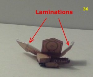

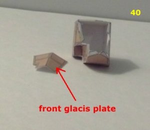

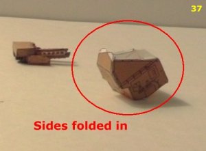

Some more work on the cabin. I guess the size of the pictures in pixels, determines the positioning of the photos. To make it more flowing, follow the numbers on the top right corner of the photos for the correct sequence.

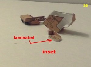

36. The sides are laminated and only kept the front tabs in place. Folded them into position.
37. The sides are in place.
38. The indented part is folded with the top portion laminated.

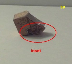

39. The indented part is place into position
40. The front Glacis plate is ready for placement.
More to come, See you all next round.:wave::wave::wave:

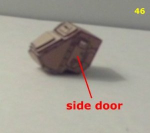

Sentinel.
More on the cabin.

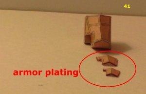

41. The front armor plates, laminated.
42. Side view of armor placements

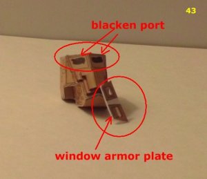

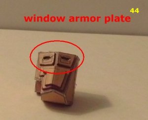

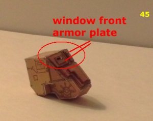

43. Blackened the cabin area where the view slits are to be. Trimmed out the view slits on the view port armor. This is also laminated.
44. Armor view port are in place.
45. Side view of view ports
46. Side door added. Not laminated.
So much for now, more to come, enjoy. See you next posting.:wave::wave::wave:

I am learning so much from you build here. Great postings!! Let me see if I have this right, so in some places, specifically the indent in picture 38 and 39, you laminate the back side instead of tabs for a cleaner edge. The other case for lamination is for thickness as in the glacis. So far for my builds, I have only folded tabs and have been using a 110 weight paper. Looks like I need to find a good source for some thicker stuff. Any recommendations?
Do you prefold the laminated piece prior to gluing it to the front piece? I could see that for sharp bends the pieces might separate.
This is a really great post, thanks again!
Chrispysurfer
Chrispysurfer[/quote]
As for paper recommendation, 110lbs or 120lbs folded four times will give you the approximate thickness or shoe box material. Also posterboard is a good source, it comes in a thin and thick version. If it is the thin board then two ply is recommended. Also bristol board is also good but not the thick version used for matt board. For the bend in the laminated pieces. If I do a cirlcle or a wheel, I form the first sheet first and then I layer on top of that to the right thickness, if you do not do this, the circle will warp on you, it has to be done a layer at a time. For flat pieces, one on top of each other is fine, but if the laminate is say 2ply, then you need to do each bend on top of each other or you may have to cut a V cut on the reverse side to bend it to shape.:wave::wave::wave:

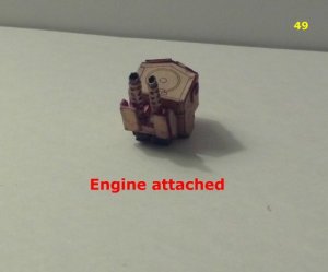

On with the show and more stuff.

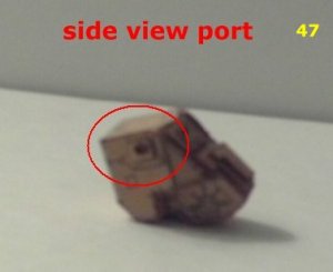

47. Placed the side view port, laminated 1ply.

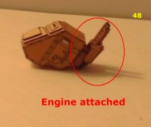

48. Attached the engine module on line bottom edge of the lower back of the cabin.
49. Rear view of the engine module.

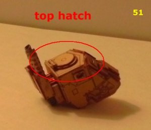

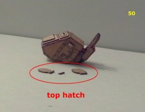

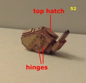

50. The top hatch is made up of three pieces
51. Stack the hatch pieces as shown. All the pieces are laminated.
52. Attached the hinges straight from the sheet, non laminated.

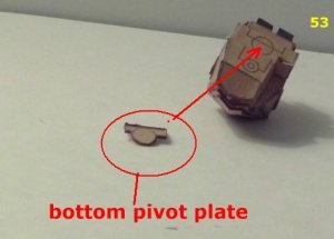

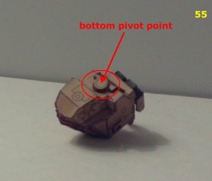

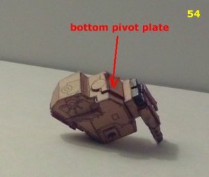

in continuum, more on the cabin. How about that.... This post came in out in sequential order.
53. Bottom Pivot plate laminated bent into position and glued on.
54. In place, you can see the lamination.
55. Laminated the round pivot point and placed on plate.

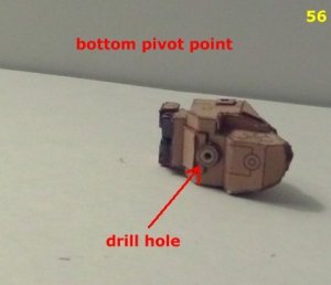

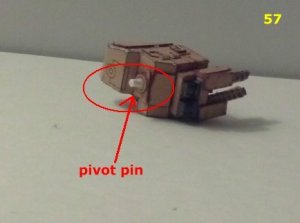

56. Drilled a hole for the shaft. I am not using the one in the kit. I will be using a paper stick. (Paper Q-Tip)
57. Paper stick from a Loli-pop, Q-tip.

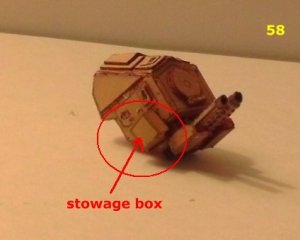

58. Starting on the outside cabin boxes.
A few more details for the cabin, it is almost done at this stage before I go to the Legs and the base.:wave::wave::wave:

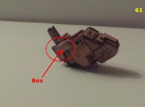

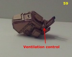

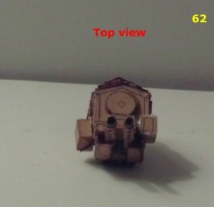

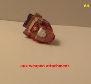

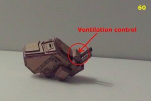

59-60-61 Placement of the external boxes and things.

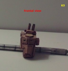

62-63 Views of cabin.
64. Scratched built front weapons auxiliary attachment point.
See you all next posting.:wave::wave::wave:

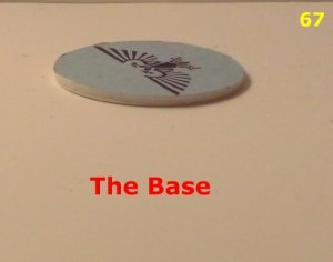

Sentinel.

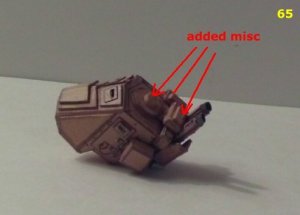

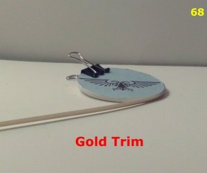

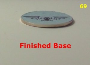

More details.
65. More external boxes

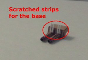

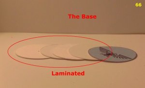

66. 67. 68, 69 The making of the base. Place it to the side and have it ready when the model is finished.:wave::wave::wave:

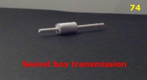

Sentinel.
Getting there. The devil is in the details.

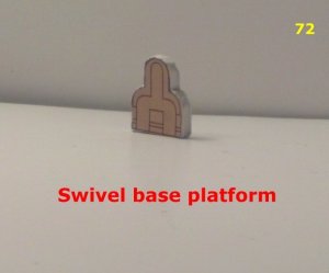

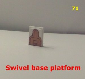

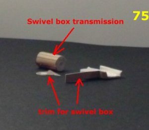

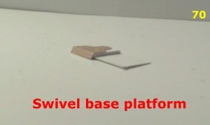

70. 71. The swivel base platform. I laminated the whole section by mistake. Should have laminated the front section and left the channel open for the Gear box.
72. The edges are rounded off.
73. Here is the channel carved out. Should have left this area open.
74. The gear, transmission box made by rolling the paper strip around a shaft. In this case a paper stick but a micro screw driver would work better.
75. Placed the trim around the swivel base and the pivot point panel on the base.
Stay tune for more.:wave::wave::wave:
