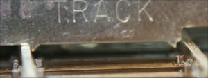

However, before installing it, I checked it over with an NMRA gauge since I had a little trouble connecting it to the flex track. I should do this every time, but I confess that I don't always think of it. I was shocked to discover that just before the points, the NO-GO part of the gauge dropped easily between the rails. (see attachment)
A quick measurement with the calipers showed that the actual gauge was .6785", well beyond than the NMRA maximum of .672". I do run some fine scale wheelsets, although on a curve this could potentially wreak havoc on any type of wheelset.

Regarding how severe this problem is, check out these pictures! I brought out an Athearn 60' hi-cube boxcar (these come with fine scale wheelsets) to get a grip on how severe this problem might be. It was as bad as I had feared. Here's a picture, and a closeup:
