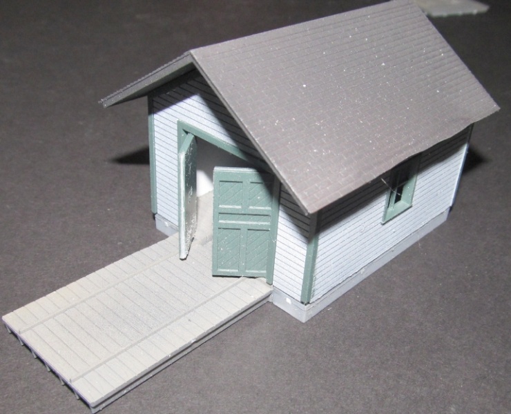

I figured with this new set up I needed an interlocking tower for the Southern at each end of the shared track, and I chose the Walther's Cornerstone trackside stuctures kit, which has an interlocking tower, a crossing shanty, and a speeder shed. I bought two kits, and will paint and build both of the interlocking towers and the crossing shanties for the Southern, and will paint one of the speeder shed for my own DG CC & W RR, in the white and green trim color scheme I have been using for the last ten years, some of my older buildings are red and black.

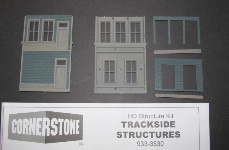

I am writing this review because I really like the way these kits are set up with the multiple piece walls, which allows some serious strength, and detail, while allowing great seperation of colors for the trim and windows
I always paint every piece of a plastic kit (excepting window glazing) with spray paint to kill any plastic shine. while it takes a little . head scratching to figure what should be painted what color, The fit of the parts and the way the wall is set up allows for very neat construction, and color seperation. I've only gotten results this neat with laser cut wood stuctures. these produce real quality buildings with relative ease.

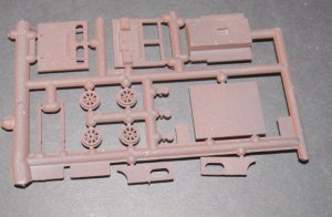

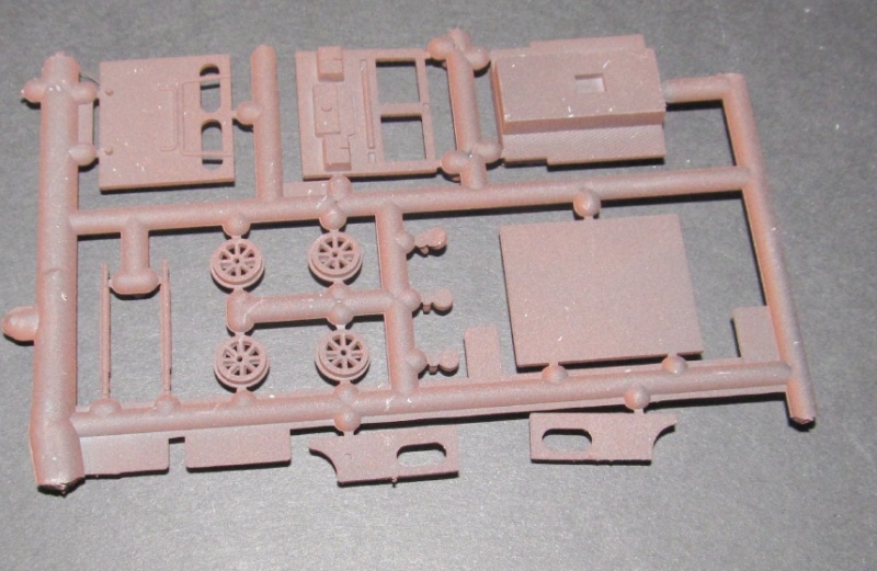

I haven't built them yet, but I am showing the parts for one of the Jordon speeders. these may be too mocern for my era, (I'll have to check, If they are I will build them and take them to the club. these have a special place in my heart, as My Grandfather Nelson was a Patent Attourney, and drew up the patent's for these critters.

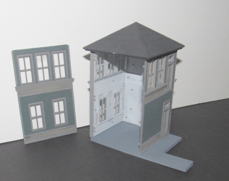

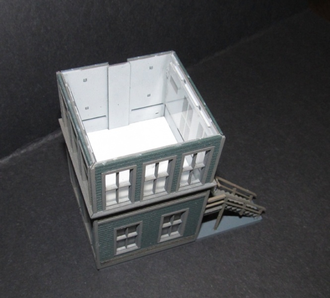

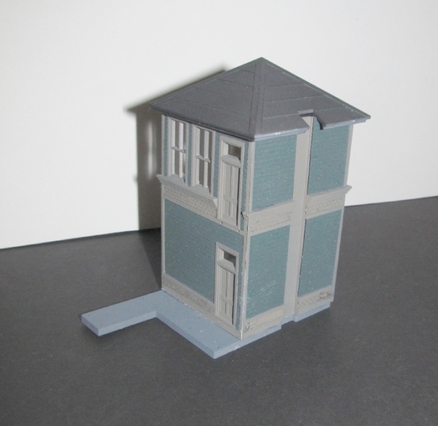

I have installed three walls of the tower. I left the fourth wall off, because I want to add a second floor; and possibly some details and lighting to these towers, as they will be important visually, and operationaly, marking off where my RR and the Southern Share the Mainline. another visual clue will be the rail size, as I'm using code 83 for most of my new main line (I will probably use code 100 on the helix and on any long sections of hidden track)
one thing I like obout the way this kit is enginered, is with the windows made into the wall base, the inside of the model is very clean, with only the clear window glazing inside the structure and it doesn't show, so the building is nicely suited for interior detailin. because of this I have painted the inside walls white, usually I'm painting the inside walls of a plastic kit flat black so the bumps and irregularities don't show, note hoe clean the inside of this tower looks

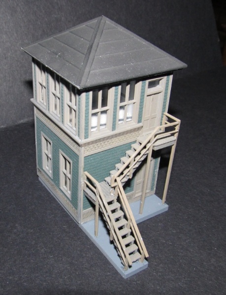

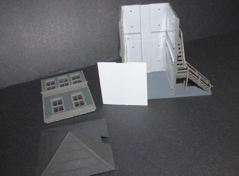

interior floor
I used a pair of calpers to measure some evergreen V groved siding, to cut an upper floor for the tower.
I used some evergreen HO 4x 10 material glued to the inside of the walls to support the upper floor. these " boards" rest directly on top of the location tabs for the wall joints, so I can believe they are pretty level
I have yet to paint the floor , and I won't glue it in place untill affter I have done the interior detailing, and the lighting, but that may be a very long time from now, as I don't see much point in doing that untill they are on the layout, and that section of layout does not exist yet.
all that remains in the short term is the chiminey. I have that glued together, and I already have it spray painted gray, I will just have to work with some brick red acrylic paint and dry brush the bricks, leaving the mortar lines gray, tricky, but relatively easily done once one has practiced. I will probably build in some wires for the eventual LED lighting, which I will put on the top floor, it will very well lit, which will make the interior details really pop. I'll need to find a pot belly stove for each tower, some chairs. and scratchbuild an iinterlocking mechanism, and a desk, It will need some pictures or maps on the walls too.
If you look at the interior walls you can see some dots, those are the ends of the locating tabs for the exterior panneling and trim, I may touch them up with white paint so they don't stand out quite so much.
the little white dots on the roof , and less visibly elsewhere is plastic dust from sanded styrene, that will be dusted or vacumed off, so hoefully it won't make it to the layout. I got leaves on my trees, so snow would be inapropriate.
in the last photo with the tower put together, you can see how the addition of the floor improves the look of the whole tower making it more solid looking. adding floors and interior walls even if they are just foam core, and lack details, prevent you from looking through buildings in inapropriate ways making the buildings seem more solid, and less of an empty shell greatly improving the realism.

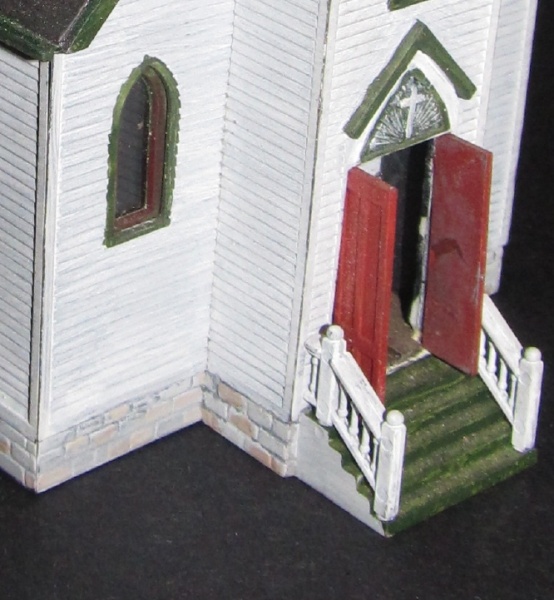

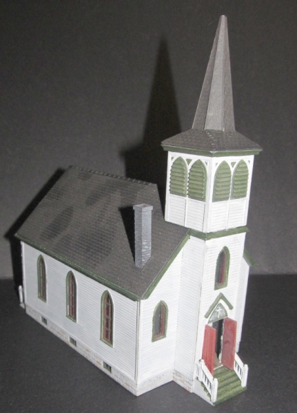

another cornerstone kit I built
This used to be St, Elgius's in Montgomery Furnace, and will likely be again. St Elgius is the patron sait of Metal workers.
this kit ws built prety much stock except I did add a floor to it, and cut up the front door some some so I could have it open, it is begging for interior detailing and lighting at some time. sadly I broke the little cross that was on the top of the steeple, and wil need to replace it with something stronger than plastic. The kit has some stickers or decals, I forget which, with nice plain stain glass paterns, that I have not yet put on.
I have also make a couple cornerstone kits for the club, a New river minning Co, and one of thier round concrete coaling tower that I started and Bob finished off. great kits, lots of fun and good results from careful work; a notch or two above the normal plastic structure kit.

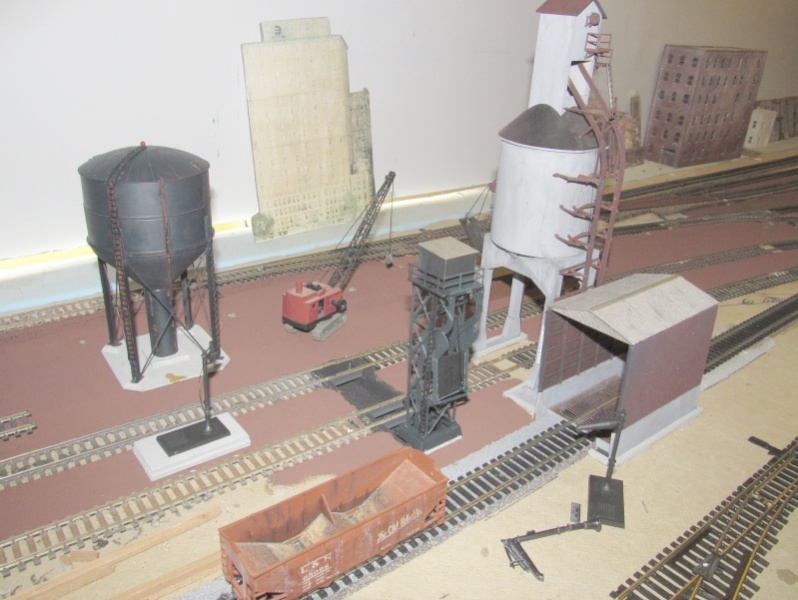

At the train club I took photos of some of the cornerstone buildings at the clube. In the Jackson Street yard's engine facilities we hace a concrete coaling tower , a water tower and a ash conveyor.
I started the coaling tower kit, painting it, and building the main structure (it is very tricky, pay attention there are parts that can go in backwards or in the wrong place) and Bob finished up the details as I had lots of projects on my workbench.
I turned over the water tower and the ash conveyor to Bob, so I can't comment on their construction,
The round concrete coaling tower interested me cause there were the hulks of several of these in South Georgia I remember studingy as a teen, the model is very nice with incredable detail.
