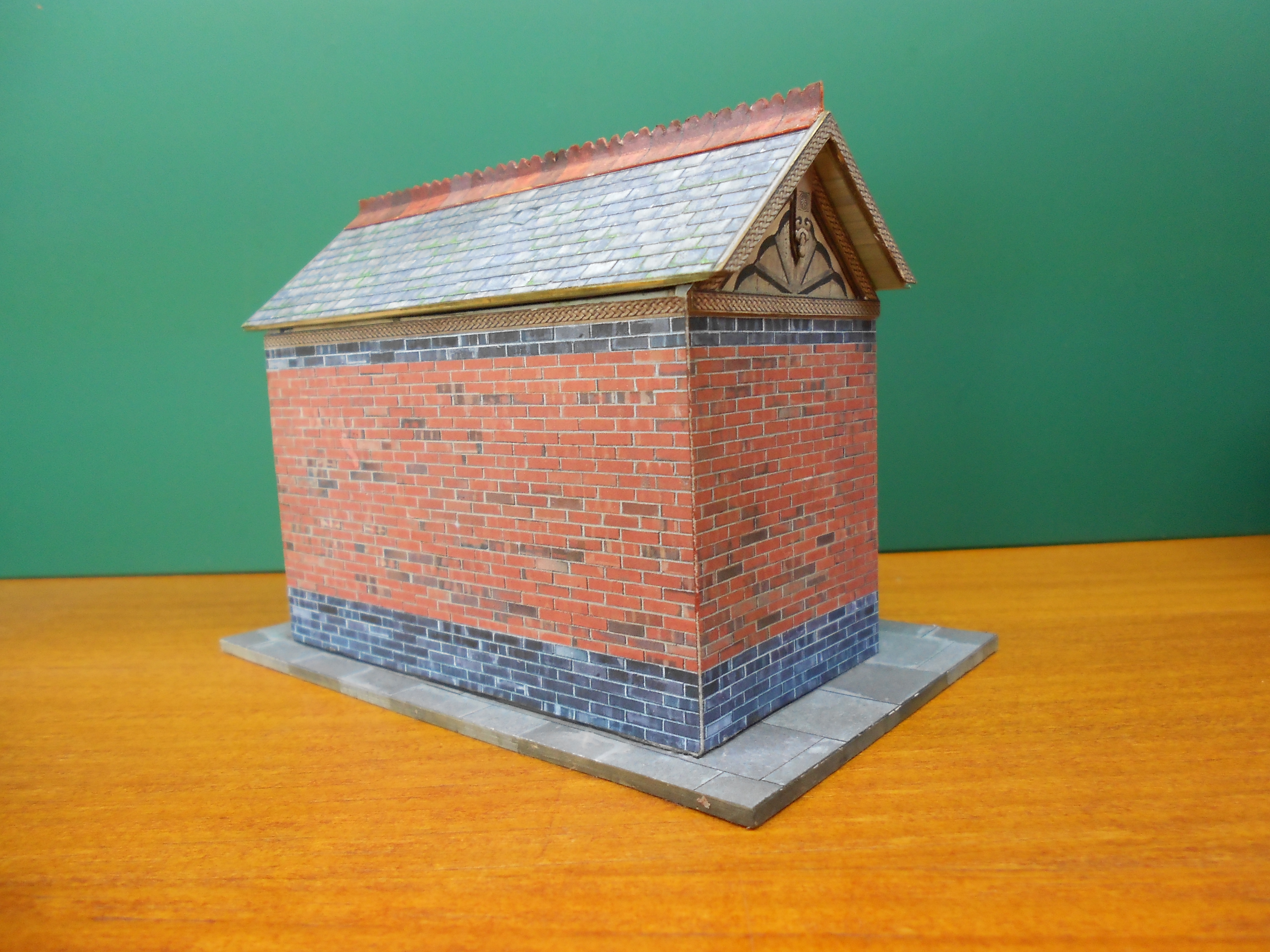

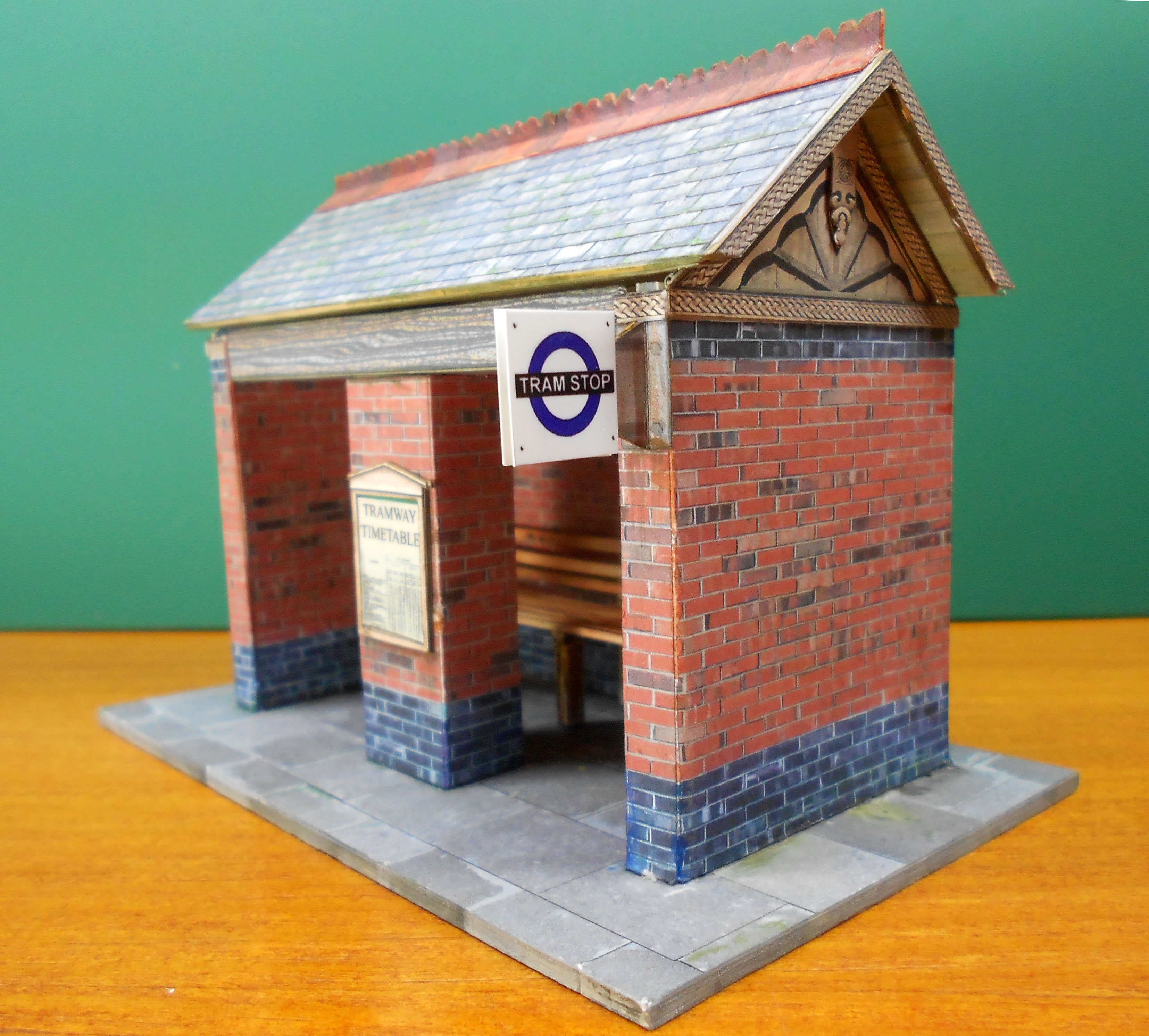

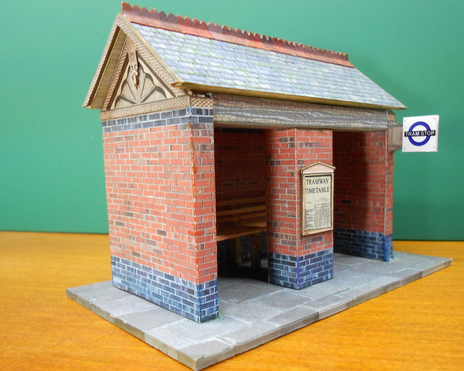

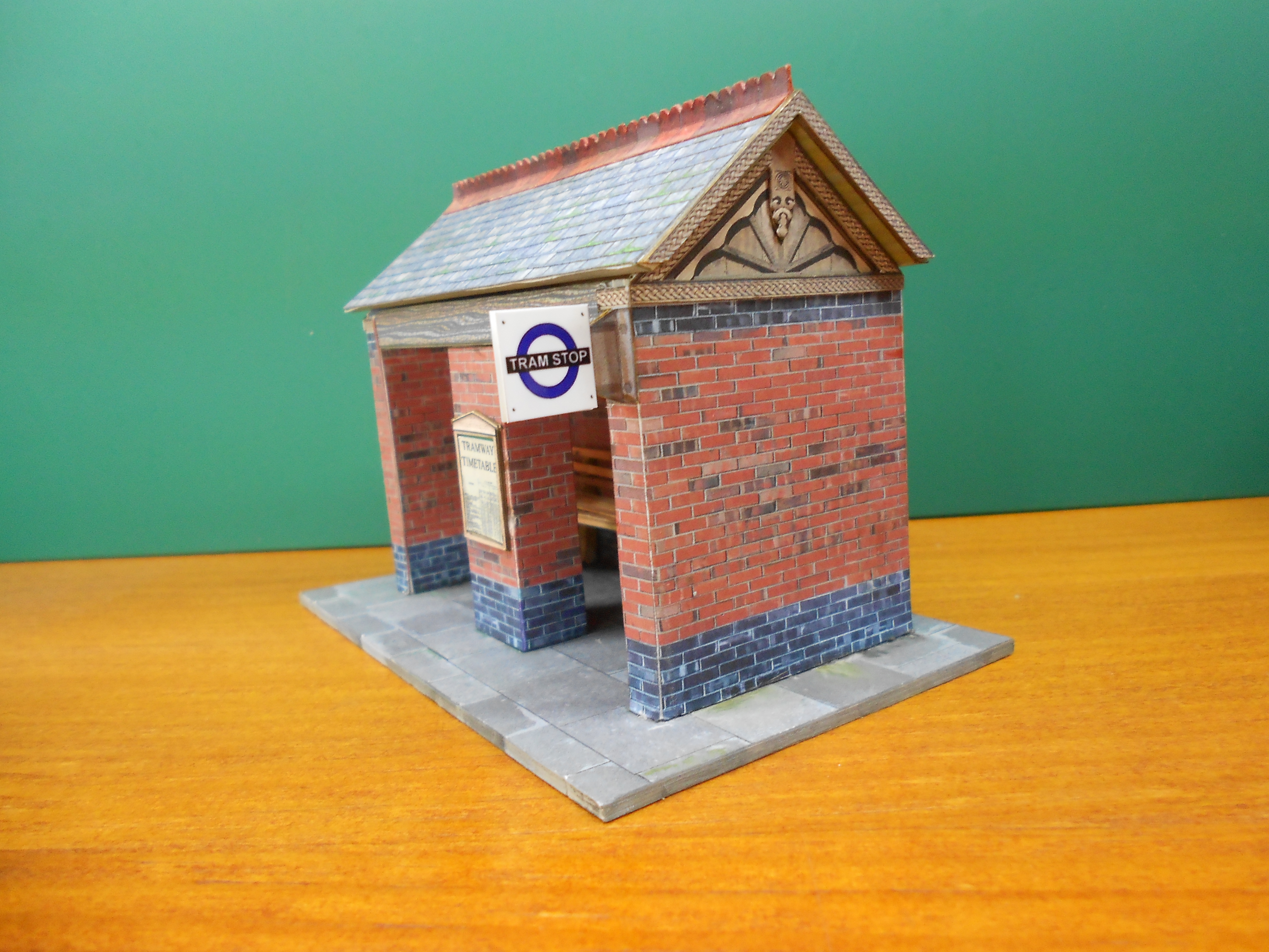

A vey pleasant model from Purple Bob's, a British manufacturer that also sells die cut windows.
http://purplebob.co.uk/product-category/7mm-scale-card-model-building-kits/

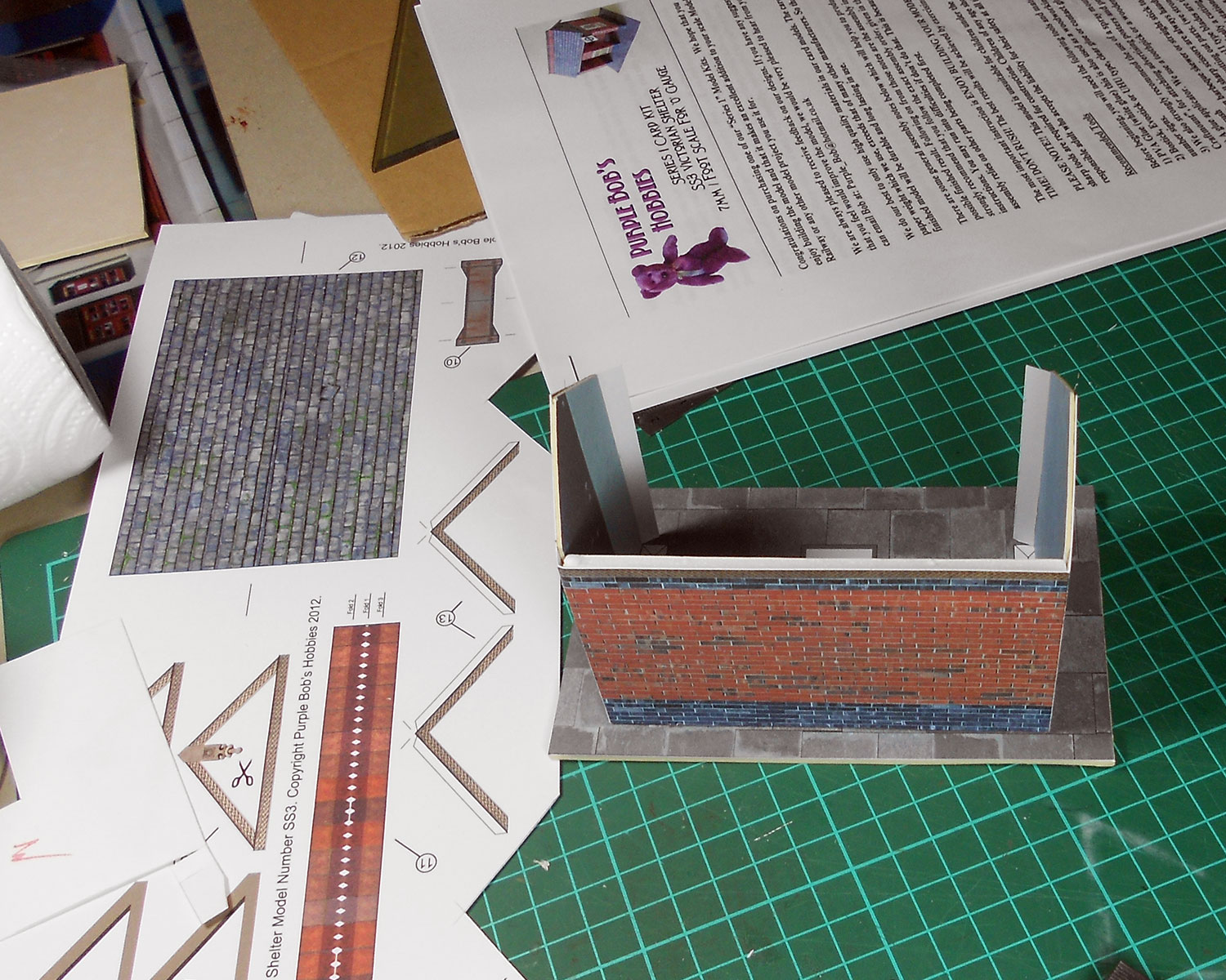

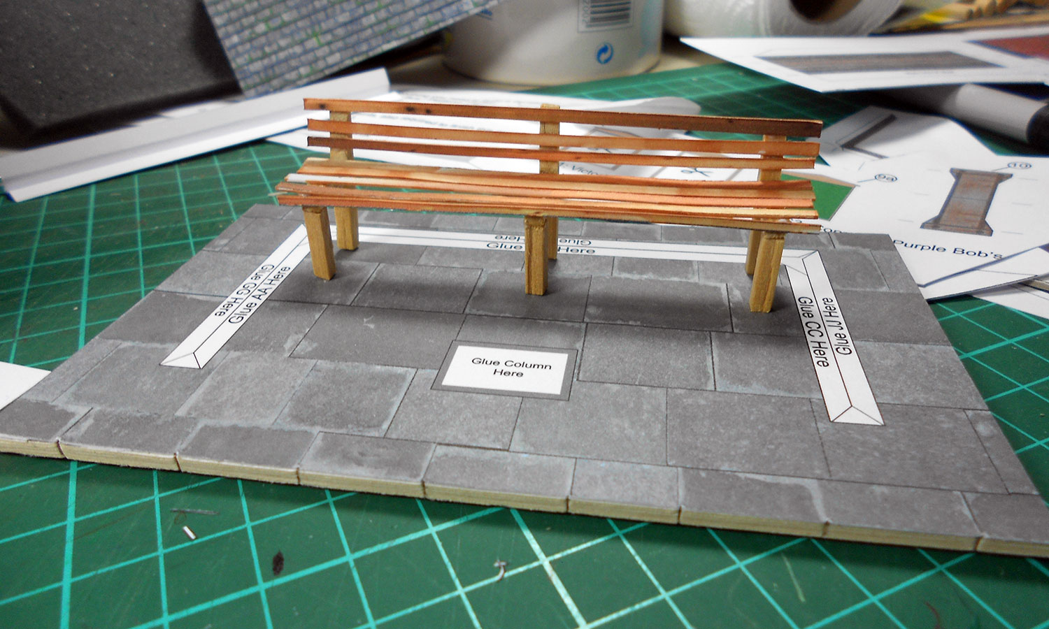

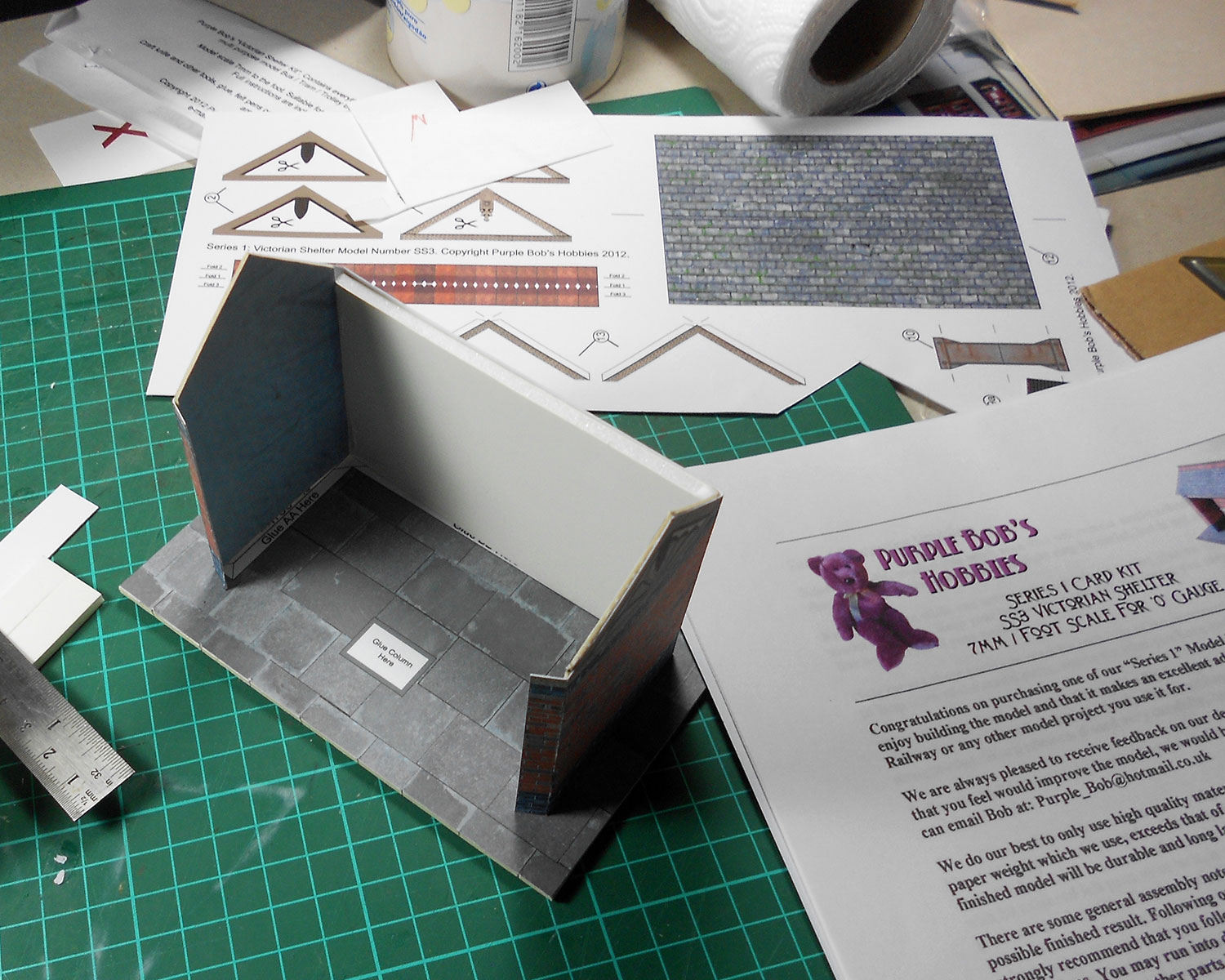

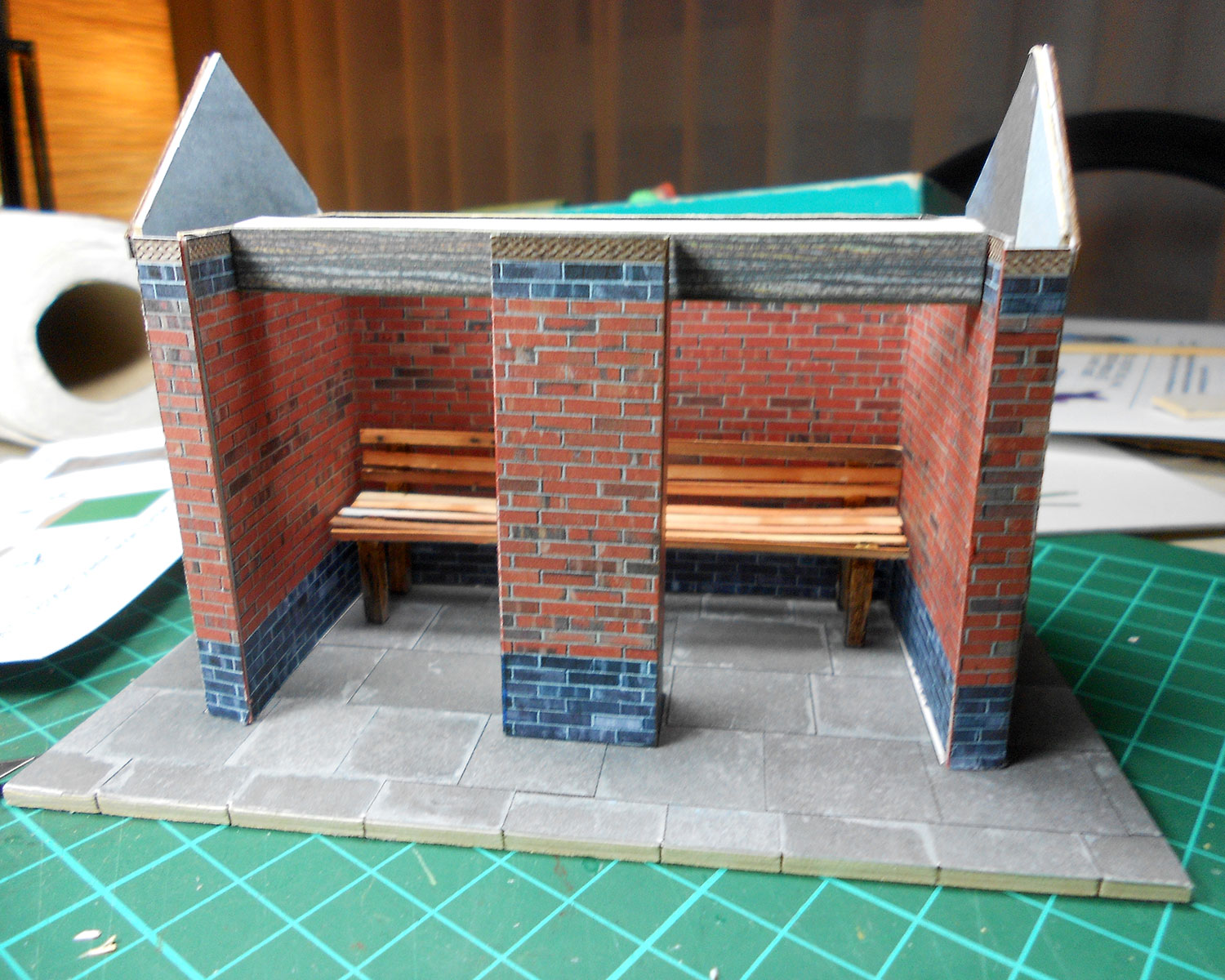

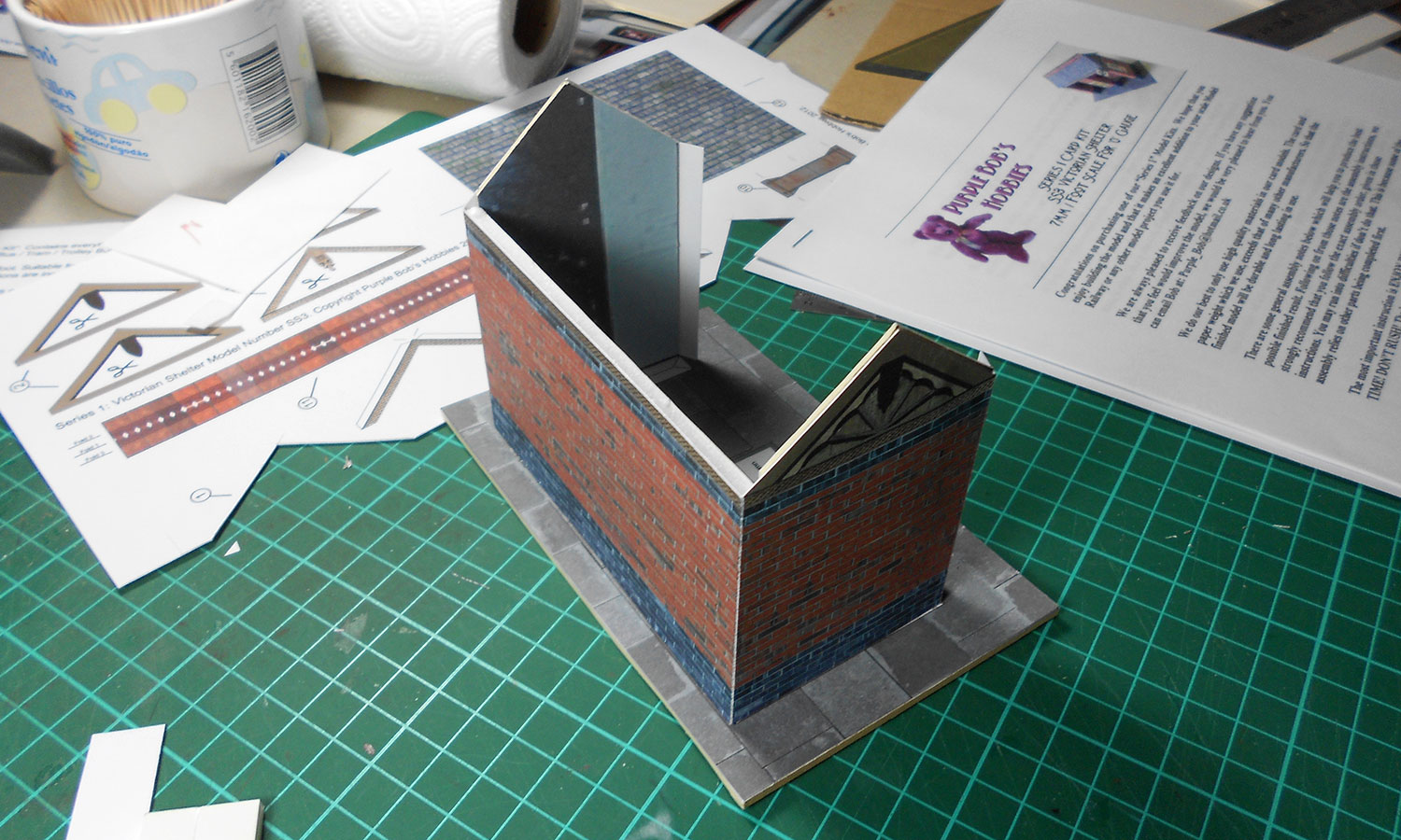

Construction is straightforward, but I opted to fill in the interior of the walls with heavy cardstock.
Made two mistakes that ruin the realism of the model.
Distressed the paper, heavy handed on the folding exposing too much the white of the paper and didn't cut the tabs to glue new ones form inside allowing butt gluing.
The model comes with extra parts to build up volume.
I still don't know if I will use this model for a tramway layout in 0 scale or leave as an individual piece.
Anyhow I intend to piant a Phoenix figure in 1/43 to give a sense of scale victorian-shelter-1.43 (1).JPG

You did a nice job on assembling the model and I like the design of the building. The graphics are really good overall but it is a shame that they did not bother to get the brick laying along the corners correct. If you are going to design a miniature brick building you design the size of it in units of bricks so it all comes out correct for the brick pattern. Bricks are not an after thought, they determine the structural size of a building, they essentially are a unit of measurement needed by the architect for building designs.To each length of brick you add one width of mortar to one end and also at the top of the brick height to create the unit of measurement.
For a standard brick there is an easy formula, the longest side of the brick is equal to the width of two of the shorter adjacent end sides plus the width of the grout line. This regularity of size is required to build strong walls that can be evenly laid. It also allows for uniform patterns that are easily created by the brick layer. In a standard size brick the height of the brick is three heights plus two mortar widths equals the longest side of the brick.Even the sizes of windows on a building and their placement are determined by the size of the bricks. The same is true of the doors. Nothing on a brick building is random because the bricks are the unit of measurement used to design the building.
Reactions: carlos filipe

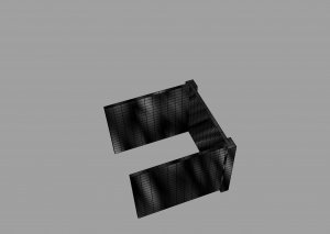

One way out is to make the corners of different bricks made such that the form a boxes at the corners. I did a quick "Render below, to show how you could "cheat" at it. ;)
