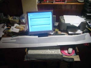

Tarawa spine
Looking at this I think I may well be right about biting off more than I can chew. It's ok writing down figures like 49" but this is reality. I am hoping the experiments I did with the Gearing will work scaled up.
Like I said before don't hold your breath
Frankly I think I am off my trolley this time. Next it will have to be 1/700 I have run out of room.

Hull sides
Hi All
I have come back to the comparative safety of building ships instead of commenting on anything else and getting lectures on my idiocy and general lack of knowledge of the state of the world (can't find a smilie sticking it's tongue out)
It does not seem quite such a daunting task when I put Spruance next to the printout it's only 2 sheets longer. I decide to split the sides where the bow flair starts from the slab sided bit.
