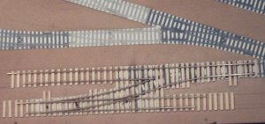

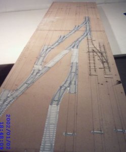

I got a big bunch of old brass track from my dad. I'm using it to build a switching yard. The yard has 11 turn-outs and some straight sections and I am hand laying all the track as an experiment to see how I like the job.
The brass is working just fine for this and the cost is right.
Personally, I could never throw out track (or anything else for that mater, I'm a terrible "string saver") I always seem to find a use for odd stuff at some place and time.
TrainClown
P.S. My progress so far.
