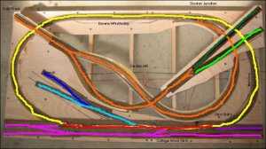

Ok, let me try and help. This is how I see it.
The yellow track and the red rack make up your main line loop. The red section is so you can isolate this section for yard work. The light purple track is the main yard and the dark purple is a place to park engines.
The blue is for the saw mill. I would have these tracks divided up as the colors suggest, but you can make all the blue one block, if you like.
The orange block brings your train up to the top yard, and the green blocks are so you can park a train on one or the other track.
All blocks are wired with double-pull-double-through switches so the switch determines the direction of the train.

Thank you. That makes perfect sense. I will read the wiring link; looks like a great site!
