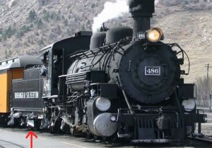

On narrow gauge railroads derailments were quite common. So almost all of the engines carried a pair of rerailers with them. In most cases they were hung onto the frame of the tender.
In this pic you can see a rerailer on a K-36 tender of the D&S tourist RR (red arrow). Probably it is the same as shown in the Nolan website - see Fred's link.
Ron
