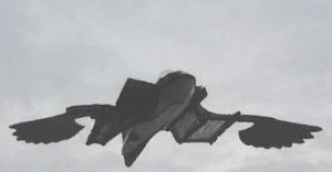

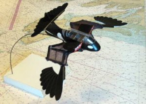

The wing design is starting to come together. I'm using nylon trouser socks as the wing skin. The skin is a pain in the petootee to sew. Since the fabric is so stretchy I can't do it on my sewing machine and must do it all by hand. I have to use lots of pins to keep the fabric from curling and then the pins fall out. On the next build I will pin the fabric to paper to keep everything in place.
On this version I roughed in the wing ends so that I could focus on the skin. In the next version the wing ends will fan closed. It's nice to see this starting to come to a finish.
I do need to work out the hydrofoil landing gear, but that shouldn't be hard.
I tried posting these pictures into the gallery but I haven't figured out the new system yet.
