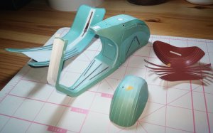

This is what I've built so far :)
Now that's how you join seams!! If you take .000 sand paper and bevel the paper edge seams, so that the edges are sharp, the white color will disappear., as in the seat. Other than painting it, it's the only way to get rid of seams. The backing strips will hold the parts together. Of course, a small piece of fine glove leather can be wet formed right onto that seat shape, and glued underneath. Use the finished seat as a plug in clay, the make a plaster plug out of the clay mold to form the leather.

How special is your work, Sadie! And how fast you're working. Now I'll recieve your tips for my own Faro Basso, ok?
Wow .. I blinked and next thing I know...your zipping right along!!

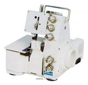

I mean this in the best way possible***, as I was raised by my Mother, my father died when I was 5 years old, and she never remarried. My mother built Gyroscopes for missiles, and was a professional seamstress. She made suits, wedding dresses, Leather Jackets, and these were sold at Gimbels and Reads department stores, as we had a small factory set up in the apt. we rented, there were 7 of us. We made my suit for my High School Graduation together! I actually have a Merrow Machine that sews 5 threads together at the same time, it's for knits, sweaters, or just fancy edges, it also cuts, and a very nice sewing machine, that does around 60 patterns.. My mother, who is 87, has a Embroidery machine she programs, though she has slowed down quite a bit, but she does know how to program this machine. It cost her nearly $3000 dollars, 3 years ago. Yes, I know how to sew. :)

My Merrow Machine (only picture on the web I could find!):
