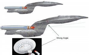

Hi, there is one important problem when you assemble the ent-d. You have to take care to get the right angel between the saucer section and the main hull. I had to cut a small wedge at the access point underneath the saucer section. To avoid dents, all parts of the hull section should be butted at edges, without overlapping. Regards Loenf

Hi guys, I'm currently building this model and have just finished the bottom half of the primary hull. I've already run into a few problems but i'm concerned about this business with the neck angle particulary since 2 builders seemed to have the same problem. What exactly did you do to sort it out? Are there any other things I should look out for while building this beast?
Thanks!
