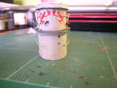

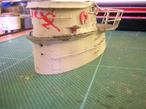

I've managed a couple of hours here and there to continue the detail of the conning tower.
Painted the base colours over the whole piece and I hand painted the emblems of the red devil and the snorting bull, plus adding the life rings.
The macro mode on the camera really picks up any fuzzy edges. It doesn't look quite so bad with the naked eye!

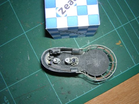

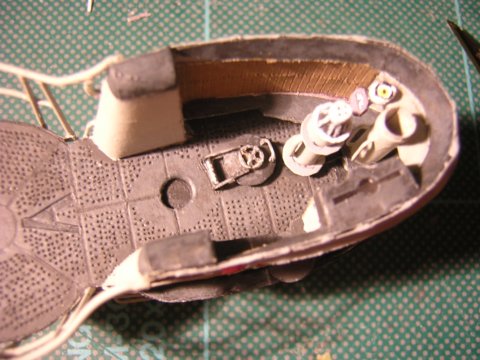

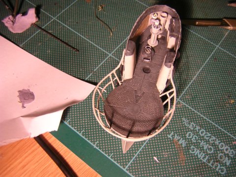

I've also been working on the interior detail -
Lower half of the attack scope
Uzo
Conning hatch
Gauge & Compass
I'm quite pleased with the hatch as I scratch built the handle and wheel from wire which I think look OK.
Next job is the observation scope and radio antennae.

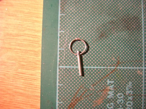

Small bit of progress...

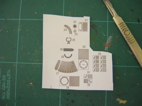

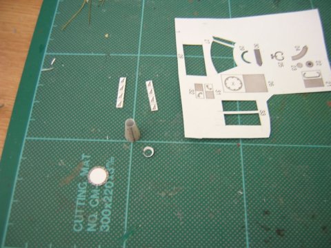

I've finished and installed the lower half of the observation scope including the binnacle and made the RF aerial from wire.
Parts for lower half obs scope
I only used a few bits. the rest made from wire.
Installed in the conning tower. Sorry I missed taking a few photos.
The piece for the top of the binnacle was just a grey dot (see part 22) so I found a jpeg of a german compass rose, converted to raster in Inkscape and shrunk it down to size. I think it looks a bit better.

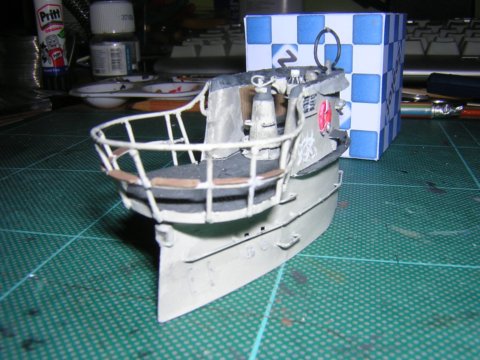

Next steps are to glue conning tower to deck and add front section, then begin making the anti-aircraft gun.

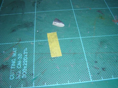

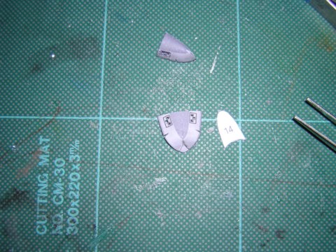

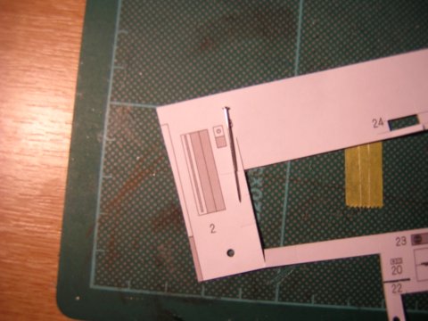

The front nose piece was trickier than expected given it was only two pieces!
There was also an un-numbered triangular piece. It was positioned on the sheet between the front of the main top piece where the cut is to enable it to take the correct form.
The instructions didn't show a picture so I started by gluing the rear of the two pieces together and working round to the front.
When I got to the front there was no space for the un-numbered triangle piece so I just glued up without it.
The general shape was OK but it was a bit pointy. The actual shape is curved in 3 planes.
Therefore I thought I'd try again this time gluing the triangle into the front of the piece first and working round.
That most definitely did not work!
No matter how much shaping/bending I did the length was now too much and it extended beyond the base piece (14). So, into the bin that went.
I can only assume the triangle is glue tab to support the front and should go inside?
Back to Mk1 then as it was only the very front that needed addressing. I gave it a bit of a light sand and minuscule bit of filler, then paint.
Once the piece was offered up to the conning tower, with a little light pressure to close the gaps it took on the desired shape nicely as designed. It's another testament to the quality of this model from U-Don.

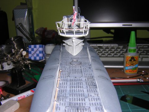

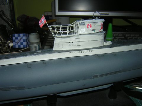

After this I decided to do a quick win.

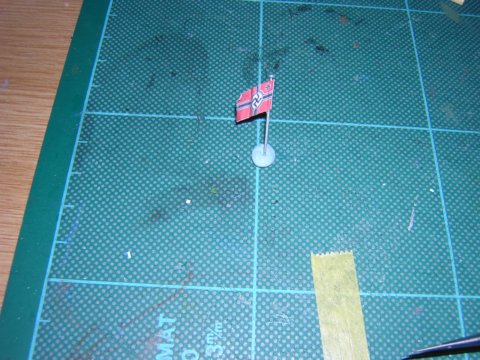

I had been thinking about the flag pole and had come up with the idea of using a sewing pin.
It was perfect. Just needed to cut it down to length.
I had previously, since I started the build, considered whether or not to add the swastika flag. The sheet comes with two flag versions, with and without swastika. As much as I abhor what it stands for I decided that it was historically accurate to use the swastika version.
Nice simple glue of the pole to the rear of the conning railing
AA gun next.
