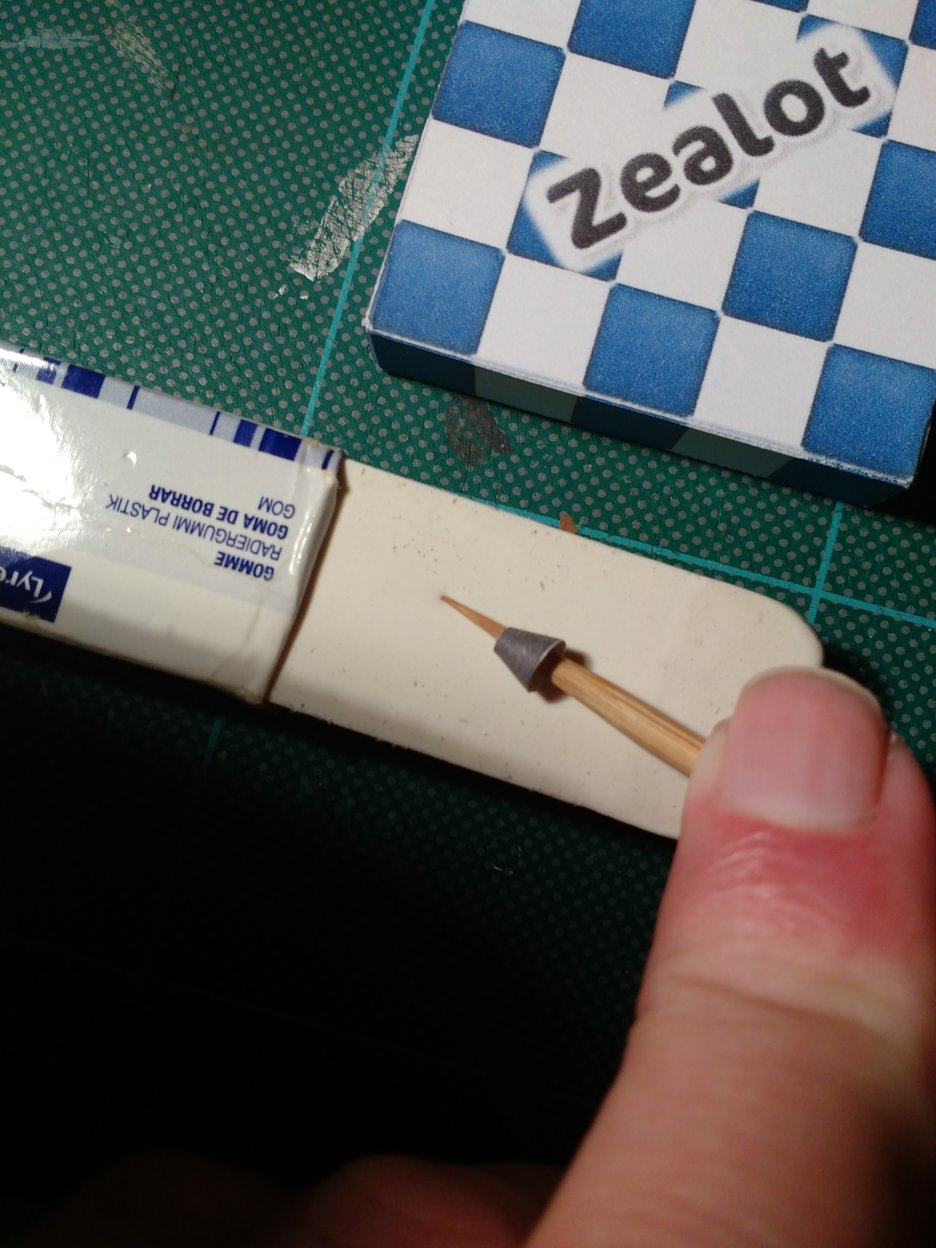

Then I stopped, went away and thought about it and came up with a new tool and technique which I'm sure most of you already know.
Firstly, using a bamboo skewer, I could shape the cone section by rolling the piece into an eraser.
This produced uniform curvature without lumps

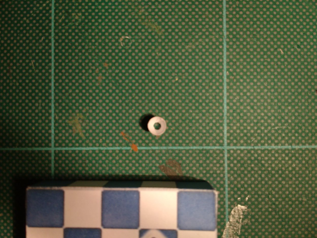

Then the next obstacle was rolling the long strip of paper for the main shaft. No matter what amount of pre-forming and coercing, it always ended up with flat spots.
Finally, I twigged that I could wet the paper to soften it and so the tight inner roll edge was more flexible.
After a couple of soggy efforts I got the level of wetting right ( just inside edge) and I was finally happy with the end result. (licking it like a rolling cigarette most definitely does not work!)

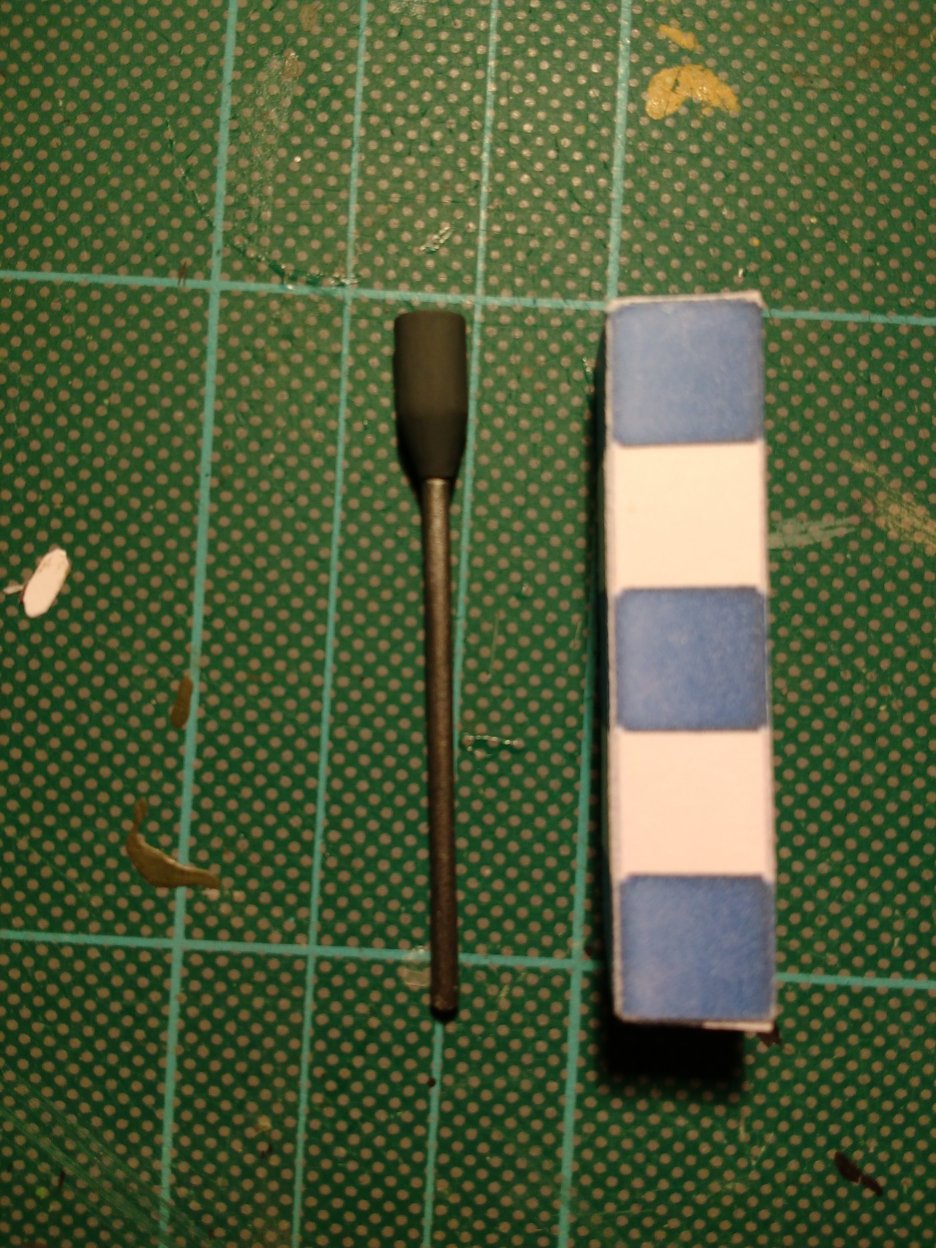

Here are the before (top) and after.
As you can see the after (bottom) prop shaft is much more uniform without as many creases.

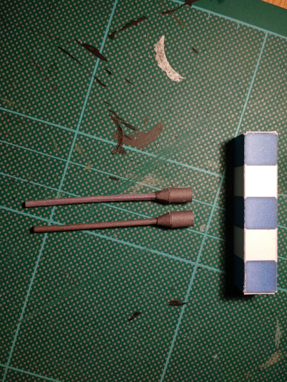

Painted up
Sorry it's a bit blurry, but you get the drift.

Nice looking prop shafts, these details really matter. ;)
