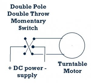

Hi Andrew
The easiest way to do what you are talking about is to follow this simplified diagram. Make sure your DC power supply is strong enough to run the motor. When you push the swwitch one way the TT goes CW. When you push the switch the other way it goes CCW. When you let off, the motor stops. I bought some switches just like what you need from All Electronics but you should find them at most electronic supply houses.
