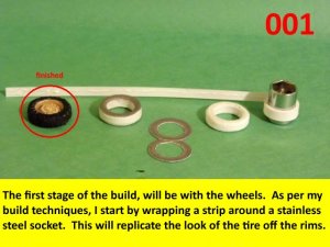

In between building my Viper, I came accros trymodels scout car. You can download it here http://www.zealotmodels.com/forum/downloads.php?do=file&id=1630 This scout car is known by other names and in different variations. The dingo is the name it is best known as but it is also known as the Bison and the Lynx. The basic shape is there but as usual, I will try to make it more detail within my capabilities. The first stage of the build, will be the wheels. This procedure can be used for other vehicle builds to include warhammer. Thanks for the model Trymodel and I hope to do it justice.:thumb:

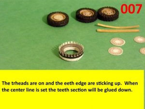

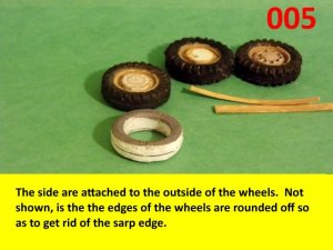

Daimler dingo

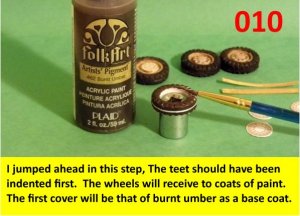

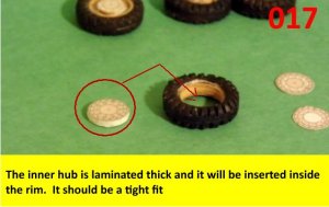

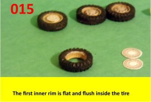

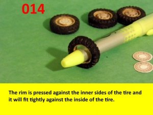

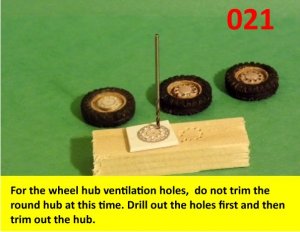

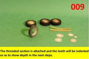

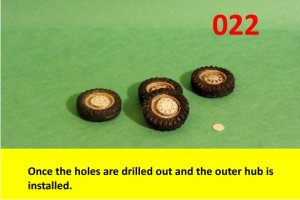

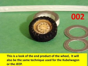

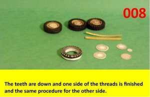

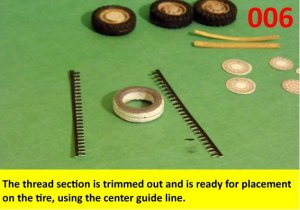

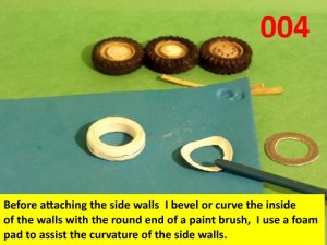

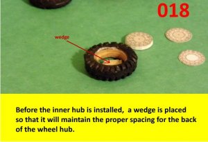

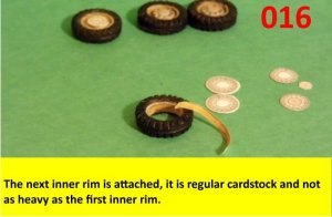

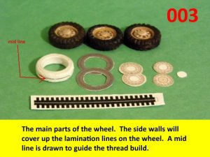

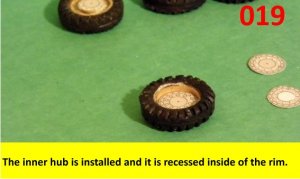

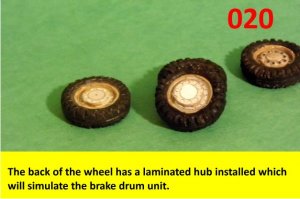

Here is the next batch of photo updates. I did the wheels first, because they are time intensive. I make my wheels different from the known techniques. The next posting will be on the chassis, suspension and axle arrangements. Enjoy and see you all soon.:thumb:

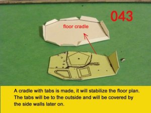

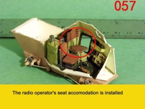

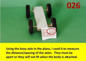

Daimler dingo

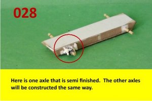

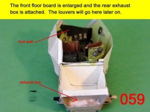

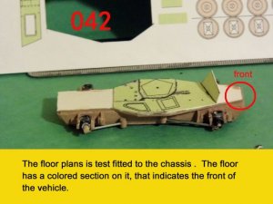

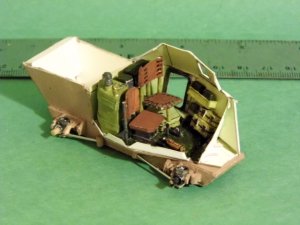

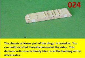

With the wheels done, it is time to go to the chassis and the body of the Dingo. The first photo is a teaser as to where I am at the moment. The interior is coming out better than anticipated. Working with the BSG Viper has helped in the detailing of this small vehicle.

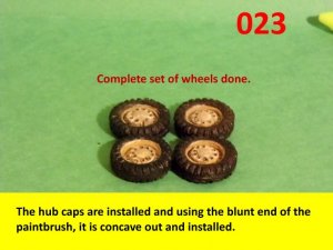

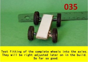

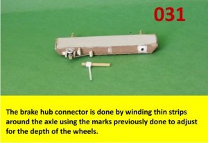

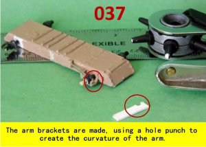

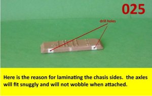

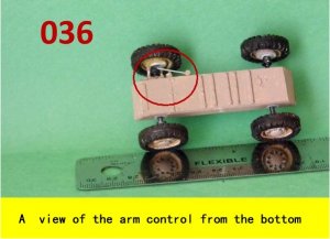

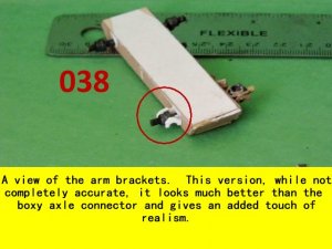

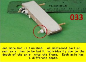

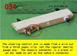

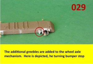

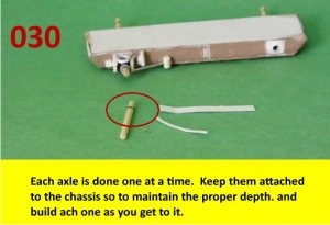

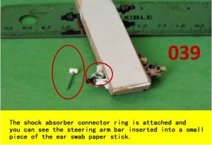

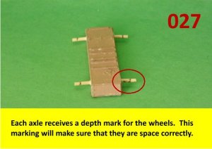

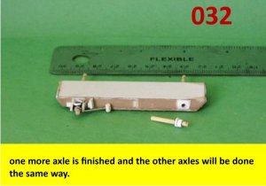

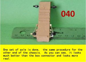

So here is the next batch on the chassis and axles. The next section, will be on the cab construction. That will be a bit tricky in that the cab is not done in a forward seating arrangement but slightly canted. Enjoy and see you all next posting.:thumb:

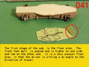

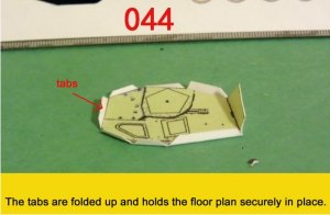

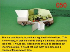

Dingo/Bison

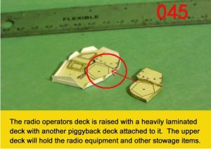

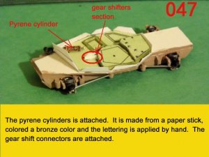

Continuing with this small project. The main unit is finished, now the only things left, are the extra stuff and details. The last photo commentary, is not meant as derogatory. A fag, is an English term for a cigarette. As you can see, here is where the scratch building really begins past the wheels and axle system. Enjoy and see you all soon with more updates.

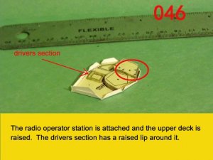

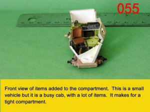

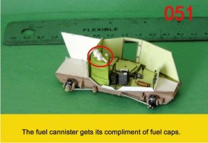

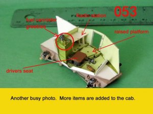

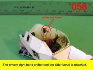

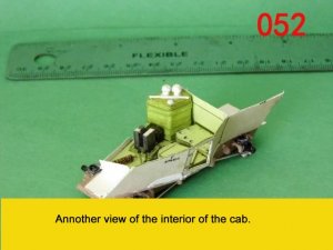

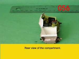

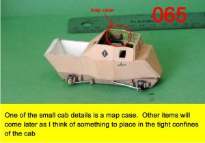

In continuation with the Dingo, Here again is a teaser photo as to where I am at the moment. As you can see, I hand painted the vehicle a NATO green and added the unit identifications for an SAS, Rhodesian Army scout vehicle.

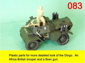

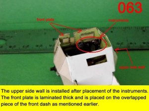

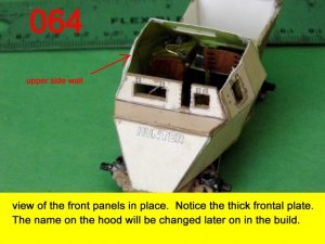

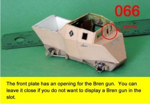

Dingo/Bison

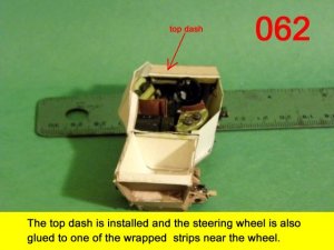

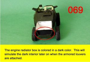

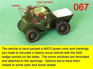

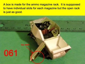

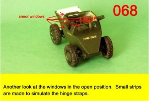

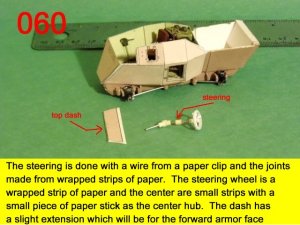

Still working on the little fella, The model that Trymodel has design, seems to be the Mark-I, This one is the same but with enhanced add on's to make it more compatible with the Mark-II or later. One of the biggest changes to the models, is to the rear engine radiator louver shields in the back. Here is the section of the build where the coloring changes. As with my ALIENS APC, I gave the body a base coat of black, and then colored the overall vehicle an olive drab. The steering column was a bit tricky but by using the paper clip wire, I was able to bend and form it to the right angles. Enjoy and see you all next posting.:thumb:

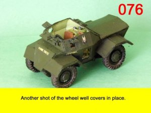

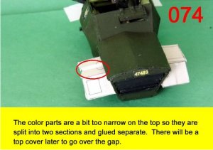

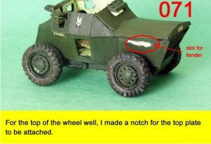

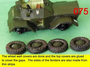

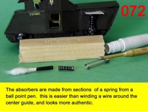

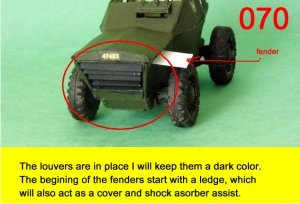

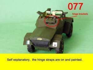

Here are some more photo updates on the build. The model is almost finished so all I have to do now is edit the photos. I wish that my graphics program had a spell checker. Sometimes I go over my threads and cringe at some of my misspelled words. Enjoy and see you all soon with more updates.
I watched with bated breath the construction of this model. In the dream, I would not think that is possible from a simple model to do. Especially when the size of 1/35 (the length is 9 cm !!!). Masterpiece, very inspiring, beautiful work. Thanks :thumb:

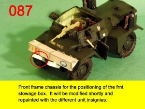

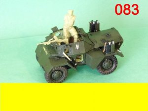

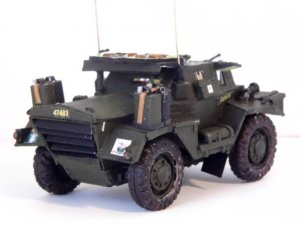

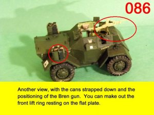

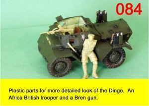

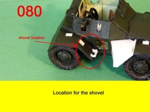

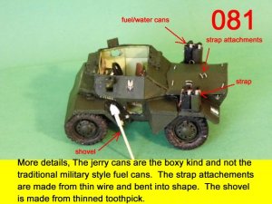

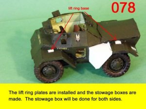

The Dingo/Lynx/Bison, depending what country of origin, is finished, I have to do the editing and post photos from here on. Be patient and the first photo is of the finished model. Stick around until I get to that point in the future. Enjoy and see you all soon with more photo updates.:thumb:
