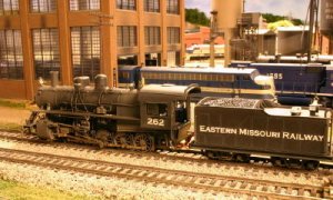

I model a fictional bridge line not dissimilar from the terminal railway in St. Louis...called the Eastern Missouri Railway. I'll try to post a few pictures here as i can...
