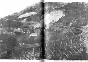

Fran, that depends on the river and on the railway.
Here is a photo of the main bridge on the credit river in the area of my layout.
Circa 1884.
